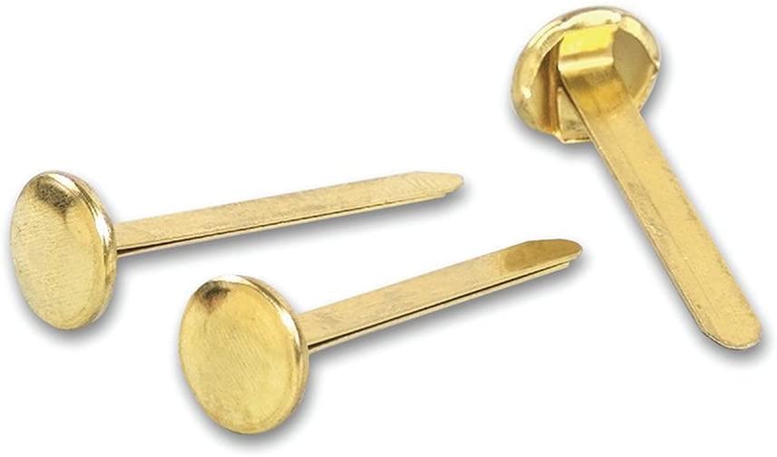

The problem with using a bolt is that the nut on the back will keep the sign from hanging flat.
How fancy and durable do they need to be? How about using simple brass paper fasteners such as these:
www.amazon.com/ACCO-Brass-Fasteners-Plated-A7071712CS/dp/B07D12M3QN/ref=sr_1_16?dchild=1&keywords=brass+paper+fastener&qid=1610210480&sr=8-16
Make sure to get ones with longer prongs; a lot of them have only half-inch prongs, which wouldn't be long enough for your application.
You should be able to drill several acrylic pieces at once by clamping them together. Drill press would work best. If your supplier is cutting the acrylic to size, they may also be able to drill the holes for you.
