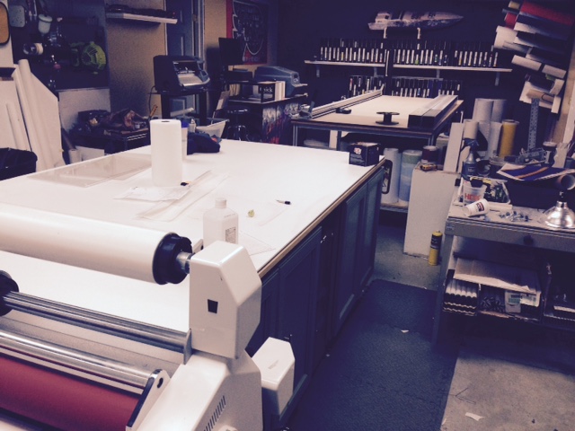

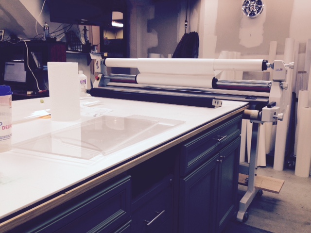

eddesign
tables
We have two tables with a small tables. We can roll in to place and make one large table
different style laminator then the rest. This works perfect. I think a lot better then a standard laminator wedged in between.

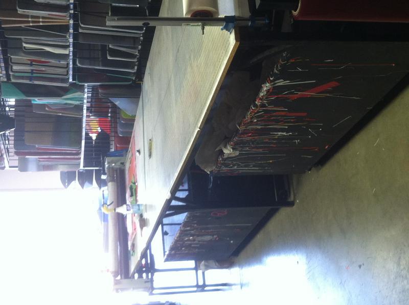

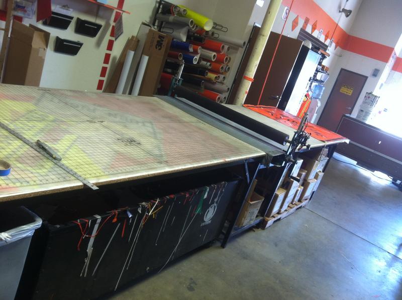

Then on the other side is a standard laminator with a 20 foot table in front of it.
