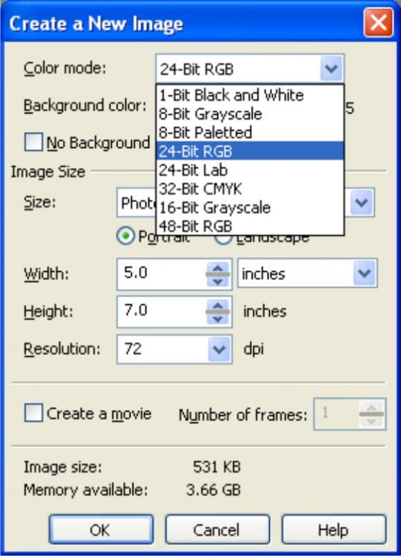

hmm photopaint == photoshop for the most part...heres the doc setup that clearly shows cmyk etc

Thanks, I wasn't aware it was in the corel draw suite.
Thank you

Wow, loving corel draw AND photo paint. Photo paint is pretty much photoshop at a fraction of the cost and it opens PSD's and everything.
