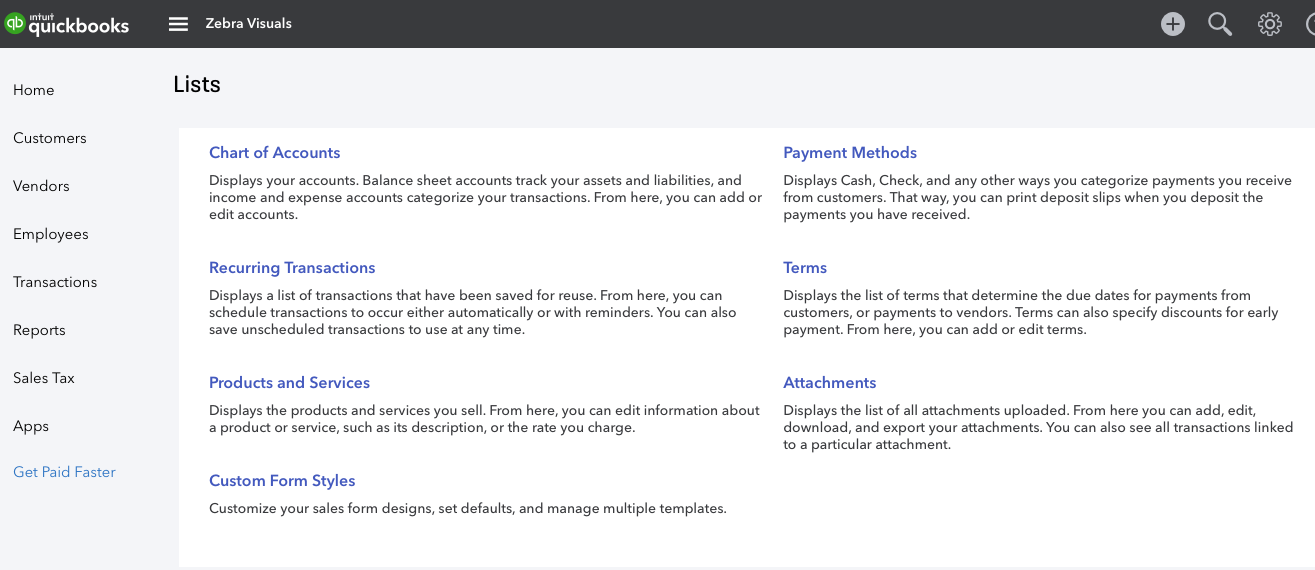

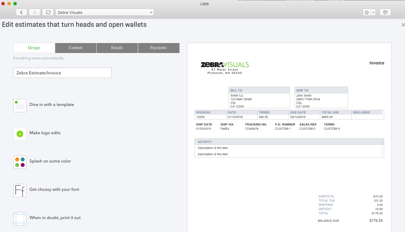

I'm quite curious how you graph320 removed the price. Not that I want to, but there are other things I'd like to change on a template and can't, so I'm looking for this "Additional Customization" menu choice. When I go to the List menu and choose templates (called "Custom Form Styles" as close as I can tell) I see no Additional Customization choice.
As the OP may not either if he pursues QBO, I'd like to see (for both our sake) what I'm missing.
