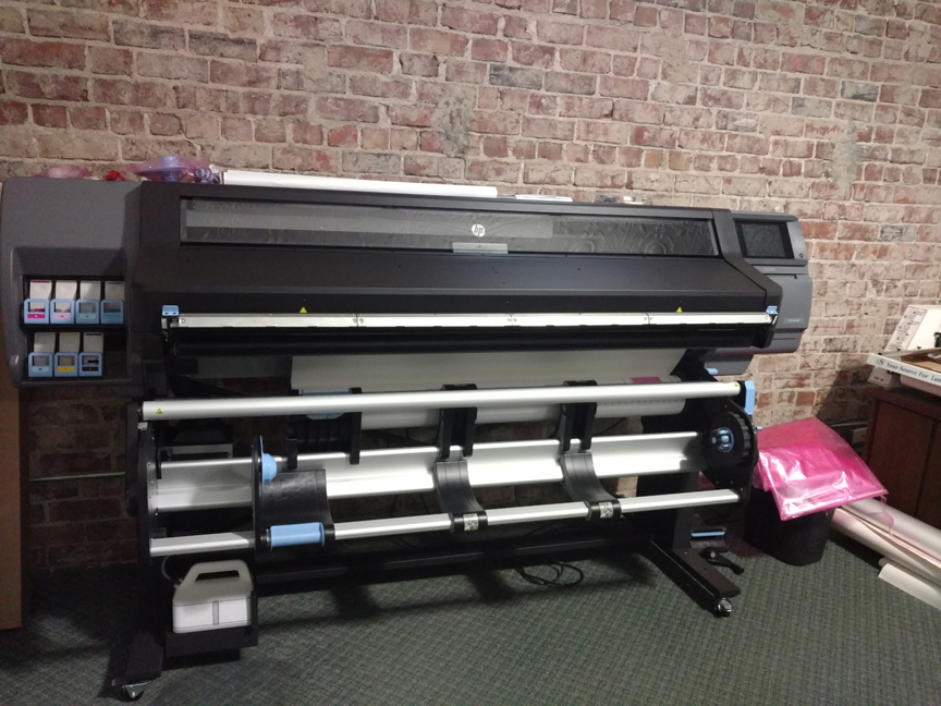

jayhawksigns
a picture of a $25,000 paper weight??

Something is wrong with the light cyan/magenta channel. Printhead or something deeper, supposed to have an HP tech in tomorrow to look into.
This was initial setup day. Second HP latex printer we have bought, and second HP latex printer that wasn't printing on day one.
I continue to get grainy prints on anything using lighter colors, made lots of changes per HP, changed print heads, different material, etc, all the same result.

Join the club my friend - we had a new latex 365 installed about a month ago, initial setup failed as one of the heads wouldnt show up - ended up being the trailing cable was boned. Of course they said we'd have a new printer in a week - three weeks later... another one shows up, problems during setup as well throwing errors codes. ended up pulling apart the ink cartridge side and found a kinked air tube, un-kinked it and has been running smooth since.. fingers crossed.

When I set up my 110 I had 2 heads fail during setup. Called HP he had me run through some tests then tell him how much ink had passed through the heads that were throwing the error...when I said 0ml he said wow how is that possible...I said the printer was installed last night and I havent been able to complete the set up procedure on the screen...he said oh that explains it...I had 2 new heads in my hand the next morning and everything was smooth sailing from there.
