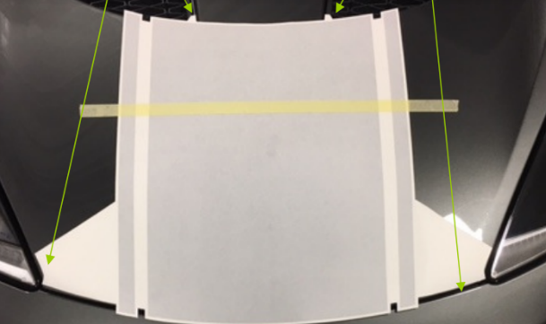

I am actually referring to cutting out the transfer paper to provide alignment positioning on the vehicle. like the photo below. That's why I need the transfer paper to stick to the backing paper.
printhog
Those green arrows point to the alignment tabs yeah? Nice idea.
So are you wanting to machine cut the app tape and the liner all around the finished graphic.. ? That seems to be what I'm seeing..
If so there are two ways.. test the various app tapes for suitability.. but you'll want a thick tape that doesn't shift under cutting pressures.
Might need multiple passes with a 60 degree blade to cut both layers.
Use the perf cut feature of your plotter to keep some media connected. Otherwise mess.
Option two. If you do a lot of these all the same.. buy a roller die cutter or clicker press and use a steel rule die to cut the top edge. I got a cheap Chinese one and OMG it's way faster than plotting. PM me for a contact for steel rule die making.. the setup fee is surprisingly low.

RTape 4075 won't work, I can assure you of that. That's our go-to transfer tape for everything and we end up just stapling the corners of the tape to the IJ180 backing paper if we have to transport graphics somewhere.

What installers are you using that the installers you use are throwing the graphics on the floor of their truck? Find new QUALITY installers!
My opinion to your issue:
1. Produce your graphics
2. Pull those center strips only. Leave all the rest. Graphic and registration tabs.
3. Tape
If printing anything, print the words REGISTRATION ONLY. REMOVE BEFORE INSTALL o those parts
If this is not an option. Fold and tape them to the transfer taped graphic. Then the installer just needs to fold them out, align and apply.
Any qualified/good installer will understand these and be able to install without any issues
Jester1167
I've seen people use tabs of masking tape to secure the corners of the app tape to the back of the liner. That is the only thing that works for that or you could hand trim the app tape so it doesn't extend so far past the graphic. Another solution would be to ship the graphics flat (expensive but effective).
