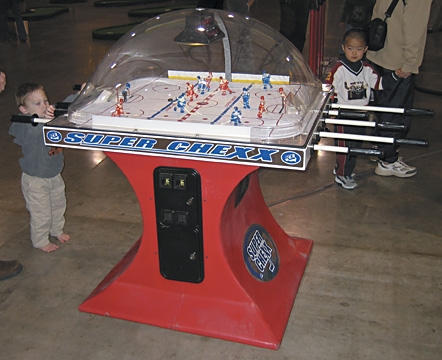

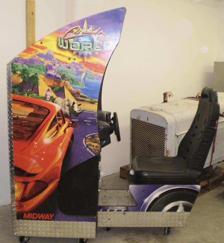

Hi I've got 2 arcade machines to cover with advertising the will be on for 3 weeks. It will then be removed & the games can't be damaged. I'm looking to use a wrap material & laminate as these will be at an Auto show & probably used a lot. I have some Oracal 3951. Will this be to aggressive to remove after 3 weeks? This also has to go over the chrome diamond plate back.
Any comments will be appreciated.
Thanks

Couldn't you use like the Oracal 3621 removable? I would think the 3951 would stick to much where the 3621 would peal right off and it's a lot cheaper too.

I am most concerned of the back.It is all diamond plate like the legs.I thought I would need an EZ apply of some sort. I have no way of testing this as the machines are miles away. They are being shipped to the site and have to be done as soon as they arrive.
Dave Stacey
I'm probably putting Oracal 3951 on the back chrome, with 3651 calender for the sides. I know you should match cast laminate with cast vinyl but seeing this is short term, will I have any issues with a calender laminate (Oracal 210) on the 3951 cast?

3621 is GREAT for not leaving residue behind, but I only remove that from Alumalite on a regular basis. No graphics ever under it. Would it be an option to just cut some kind of PVC or something like that to cover the existing stuff, and then cover that? I know it's a ton more work, but "can't be damaged" sounds pretty serious.
