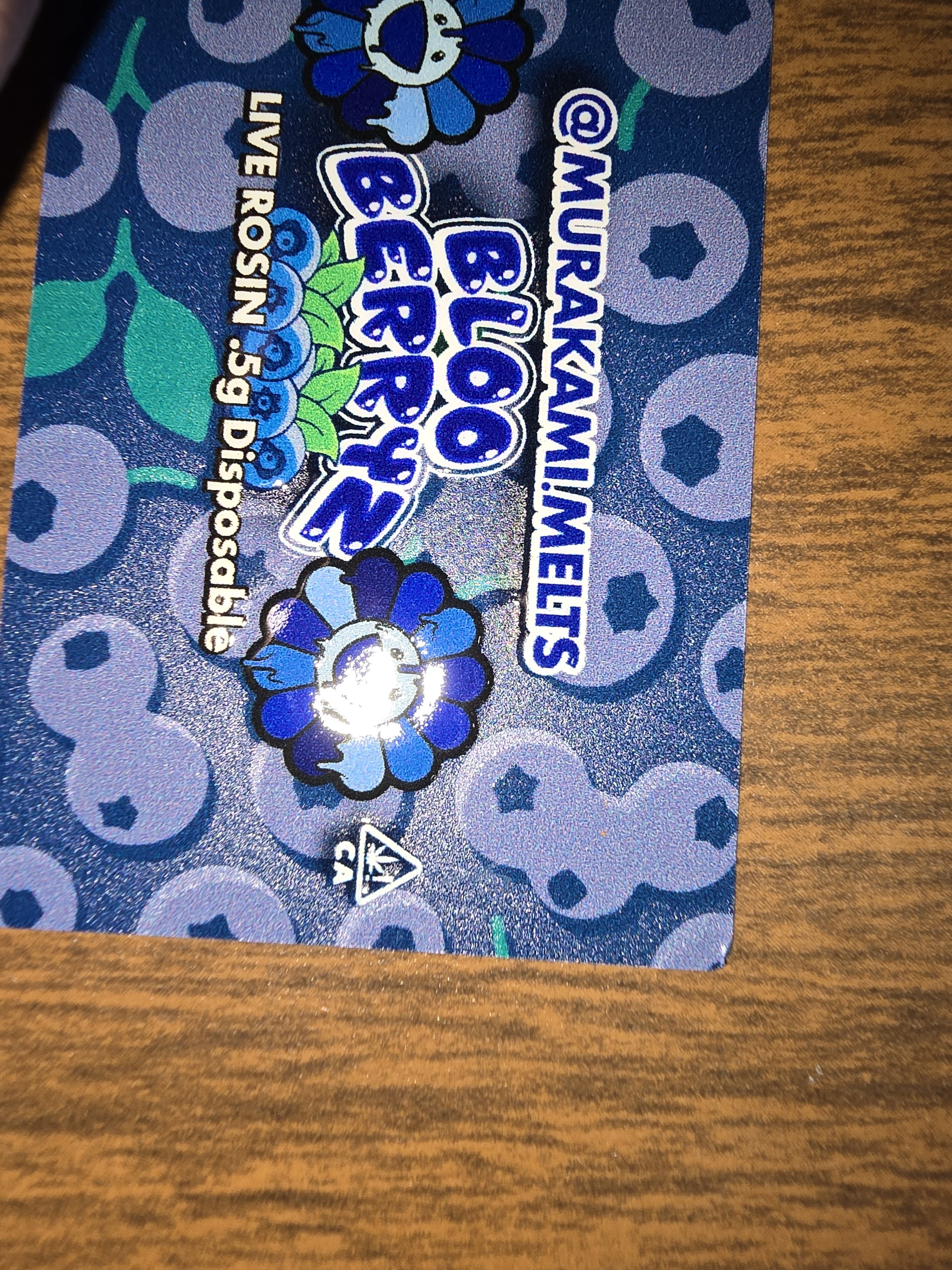

Question Are there any inksets or settings for the UCJV300 gloss that makes it more comparable to Roland gloss prints?
RonnyCrack
UCJV300-160

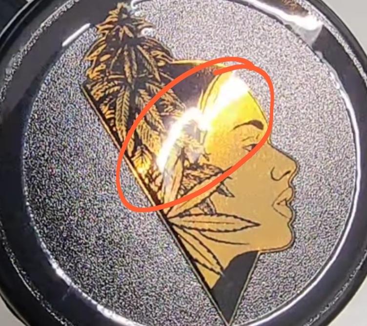

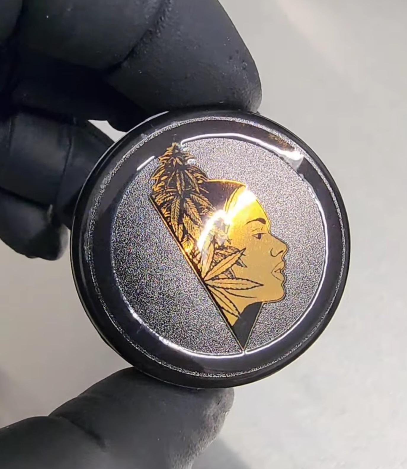

The attached image is from a Roland Printer, I'm wondering if there's any way to get a comparable level of "wetness" in the gloss? Or am I doomed to the weird, textured gloss forever..
I've gotten sort of close with STS inks and my UV lamps set to -40% but that's only in comparison to my own, worse prints. When I look back at an image of a Roland gloss print I'm defeated as it makes the difference my trial and error has made look marginal at best..
Do I just need to add a Roland to the mix? I've heard too many bad things to switch solely based on the gloss looking better but it's tough losing a gloss client and knowing they probably won't come back.

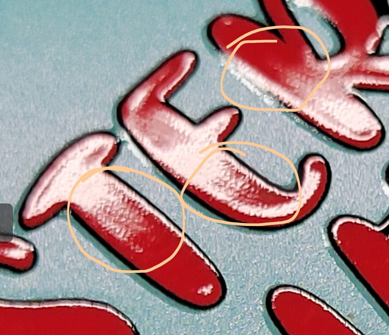

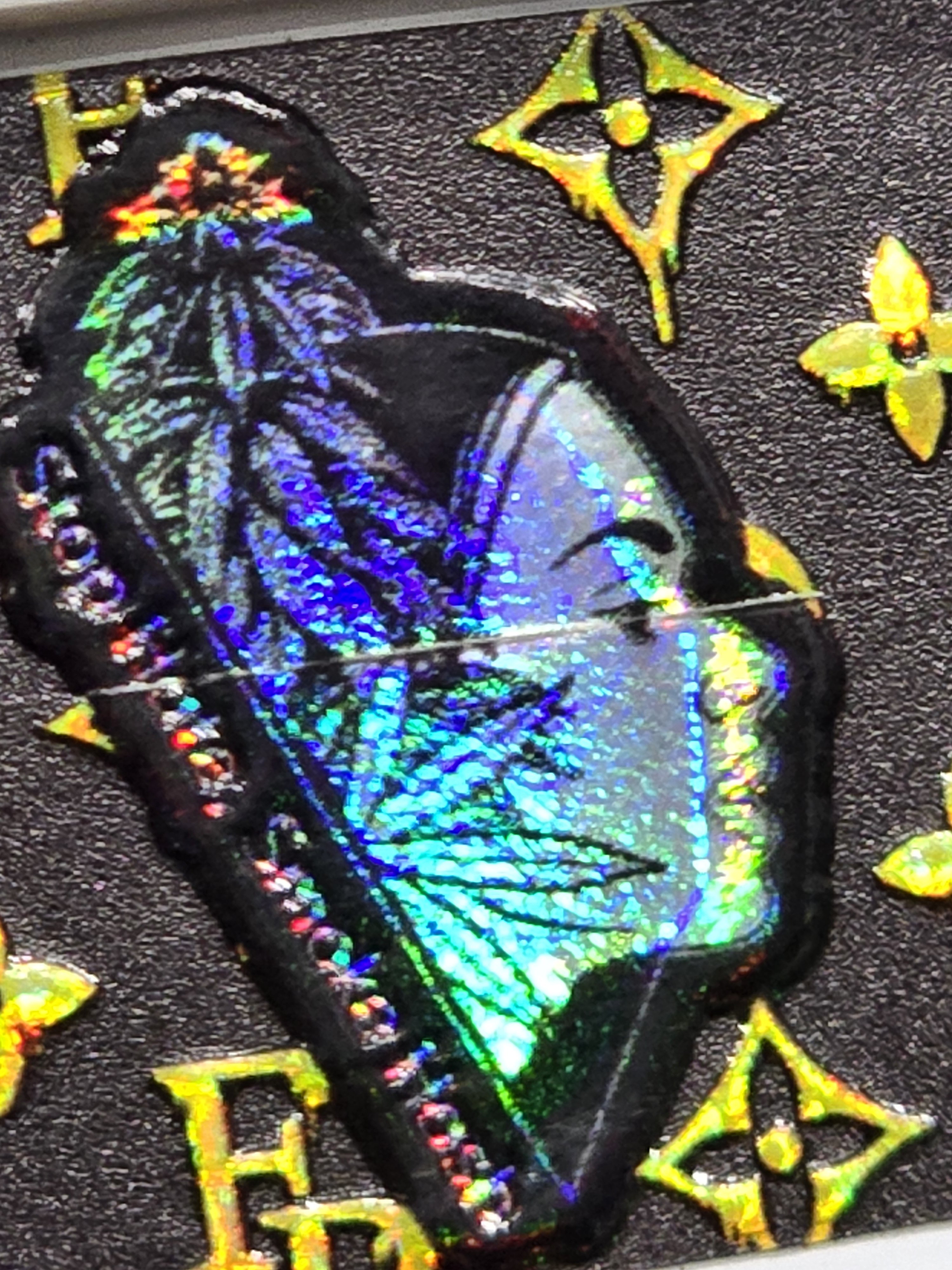

600x1200, 1200x1200, set to gloss, overprints, tried with and without pullbacks. It's just like, a texture on the gloss. You can see in the above image attached of the Roland print the reflection is so clean, with hard edges. You can notice on the Mimaki gloss print below, the reflection is more feathered by the texture of the gloss. I can upload a better picture later but you can sort of see the texture on the mitten.

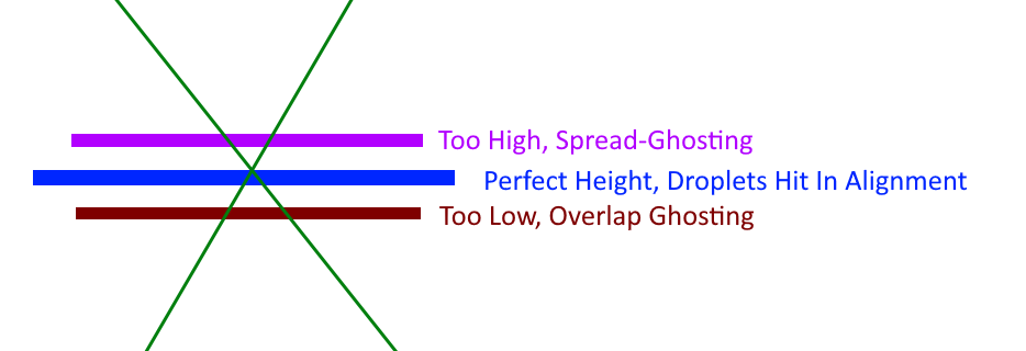

Check your media compensation/head gap, feathering can be indicative of ink dusting as well as ghosting.
Dumb diagram for illustration purposes.

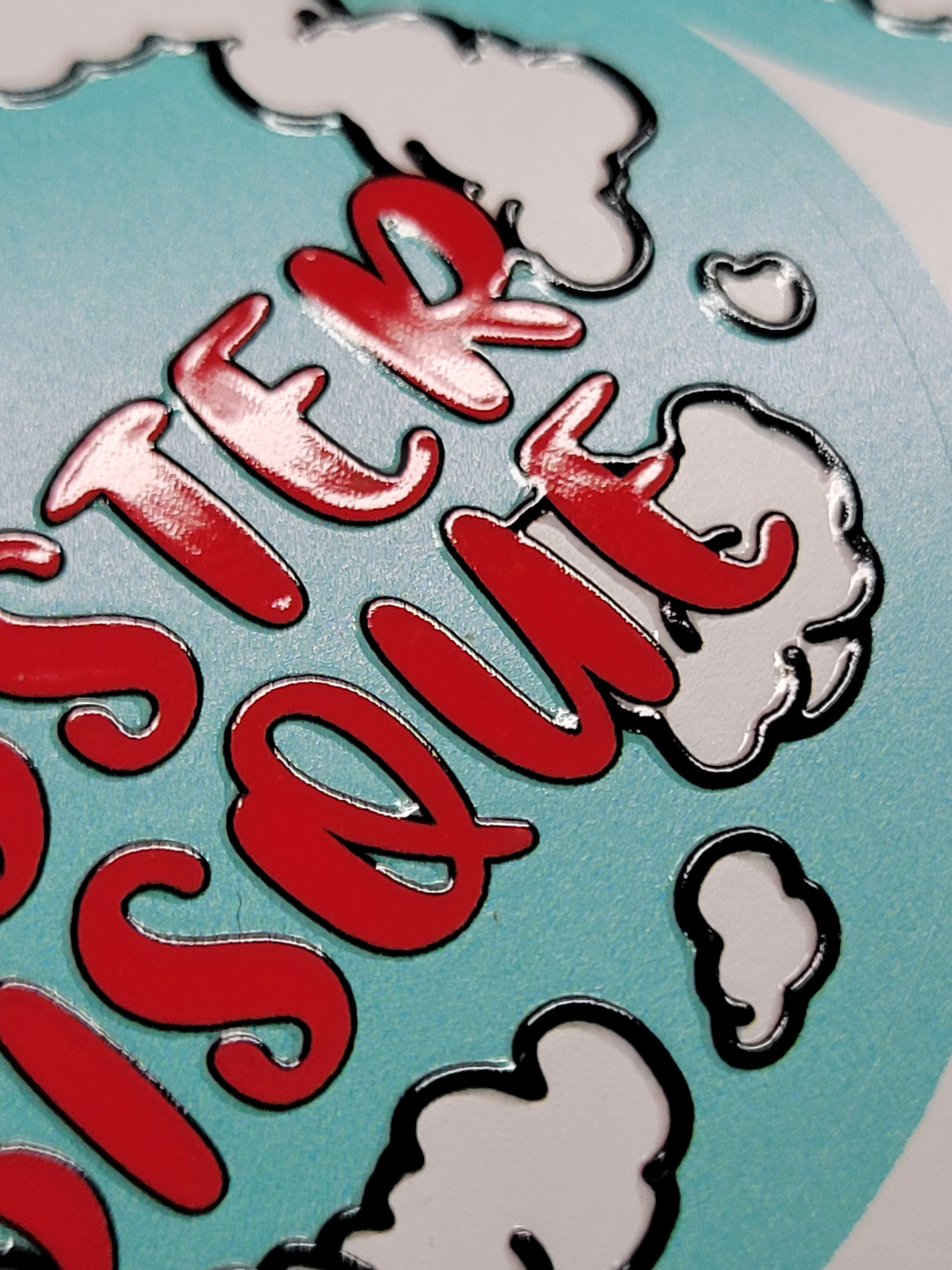

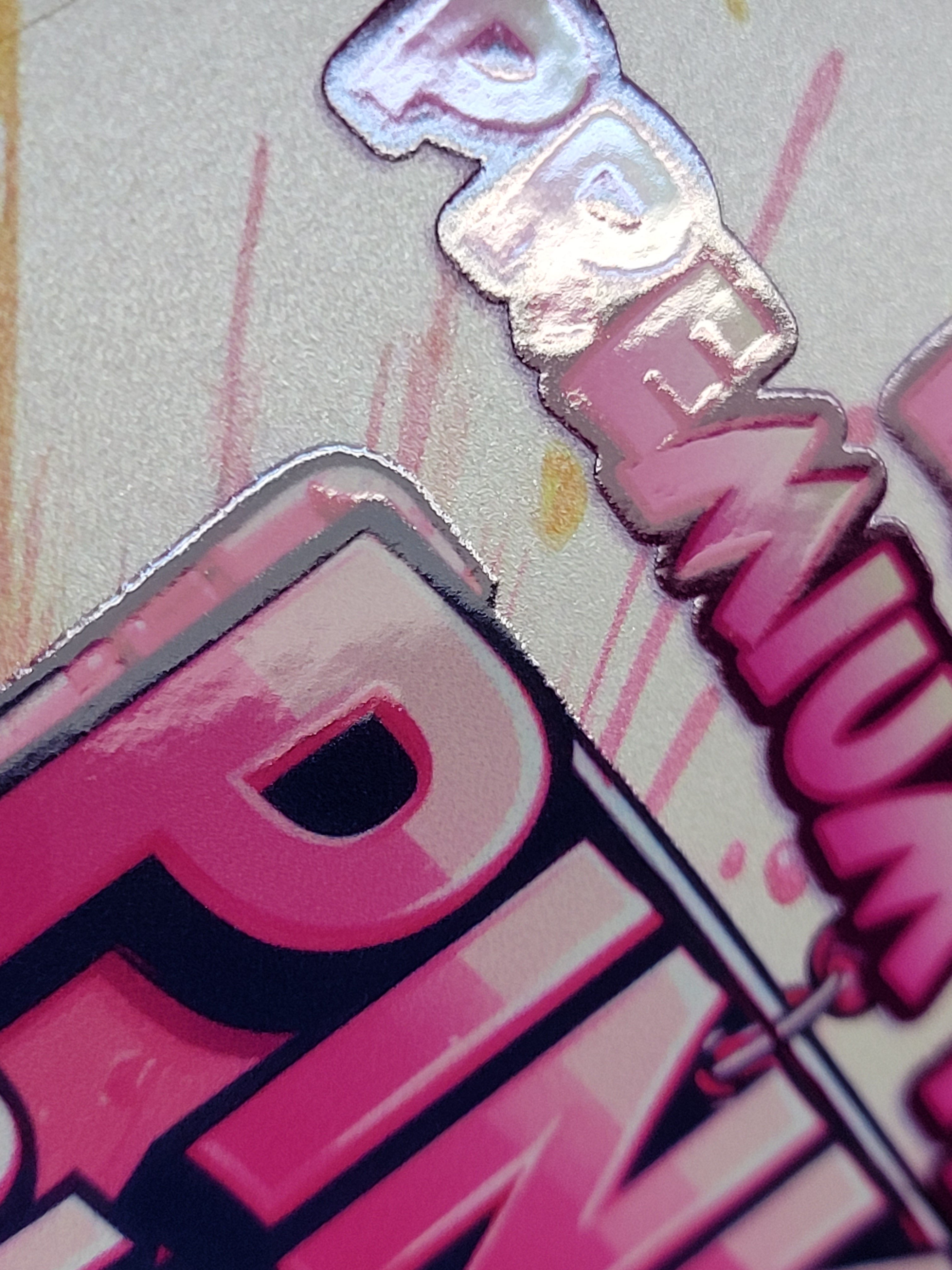

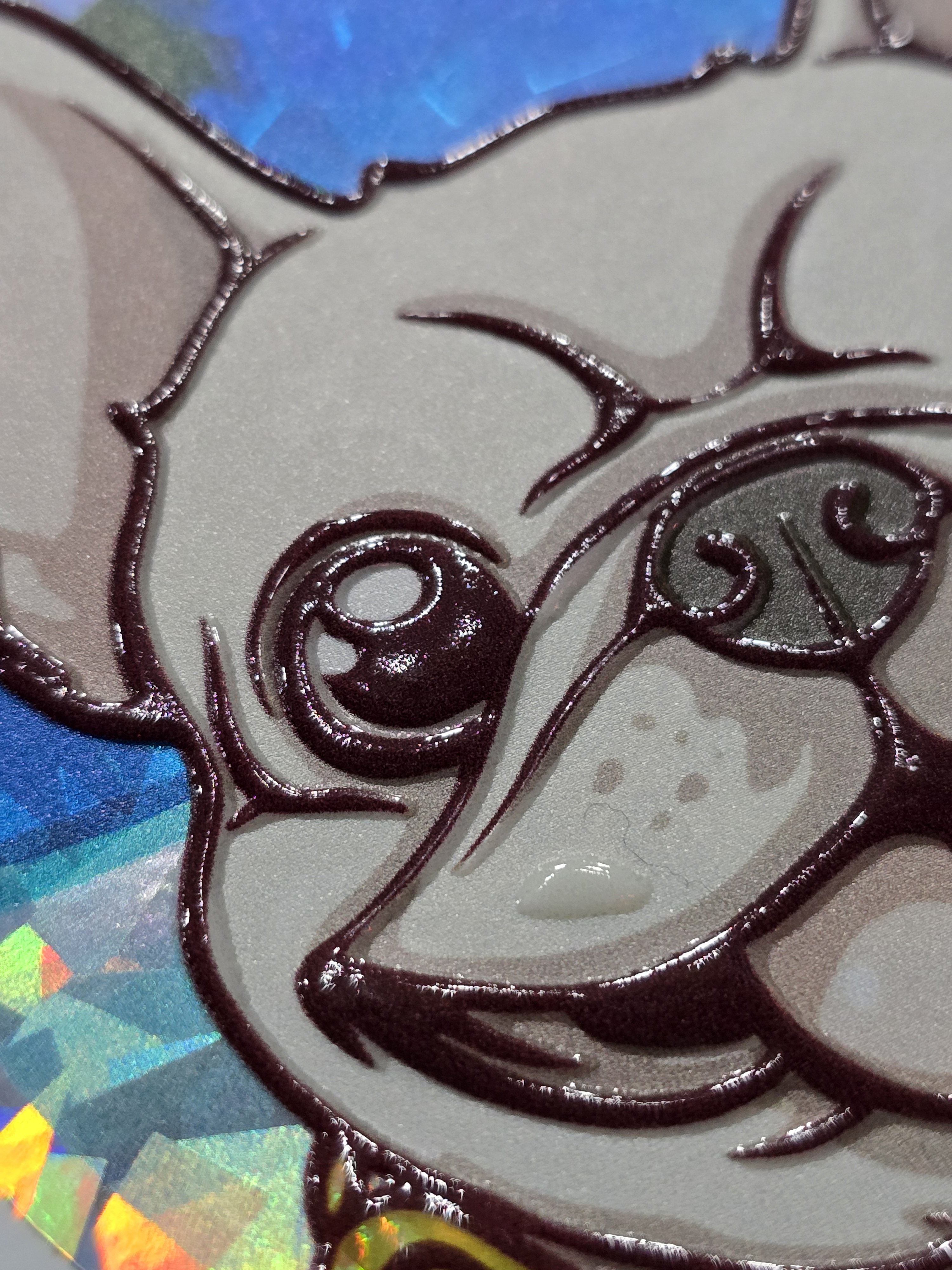

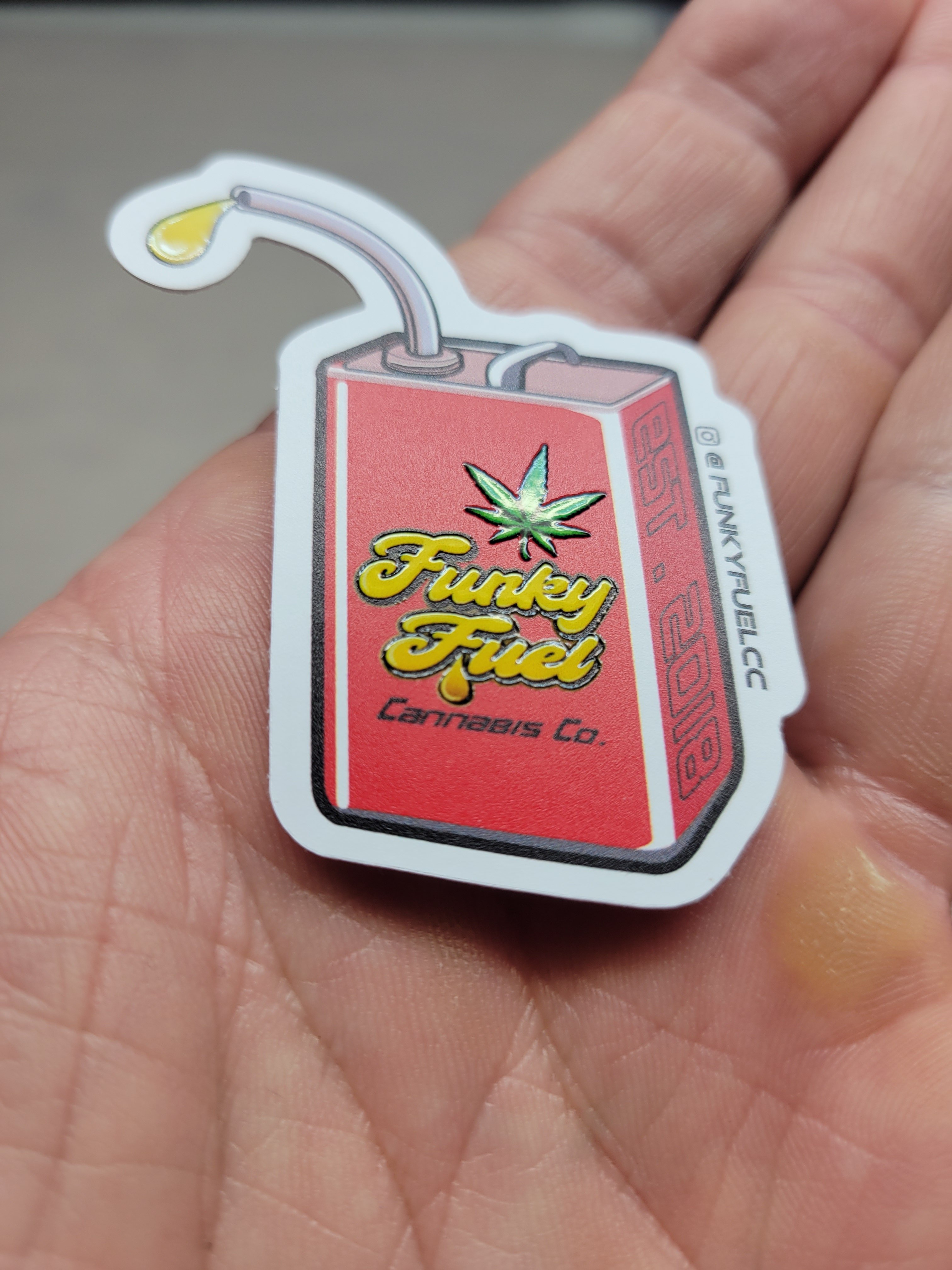

I only have one print from a Roland with gloss and I've done the same print here and it looks fine. Actually I found my print to be sharper feeling than the Roland, where the Roland felt like it was almost rounded. I'm not sure if it's how their software handles the lay down of the gloss so I can't speak to much about the Roland. I know I've gotten better prints by reducing my gloss layer to 40-45% and stacking multiple layers if I want to have an embossed print. Also If I want to do a more raised print I will increase my pass count to 24 passes with the gloss rather than using another layer or two at 16 pass. (On the 330 I can only run gloss at 1200x1200 16 pass and 1200x12800 24 pass).

I'm just referring to this texture. It could also be MAPS, I think I still have mine set to like 60% so maybe I'll set it to 0% and see if it smooths out any further.

Maybe I'll try messing with head height. Might be MAPS as well. I'm probably also using the wrong phrasing. I'm moreso talking about the reflection on the gloss being feathered/textured rather than the gloss itself being feathered/oversprayed/overlapped

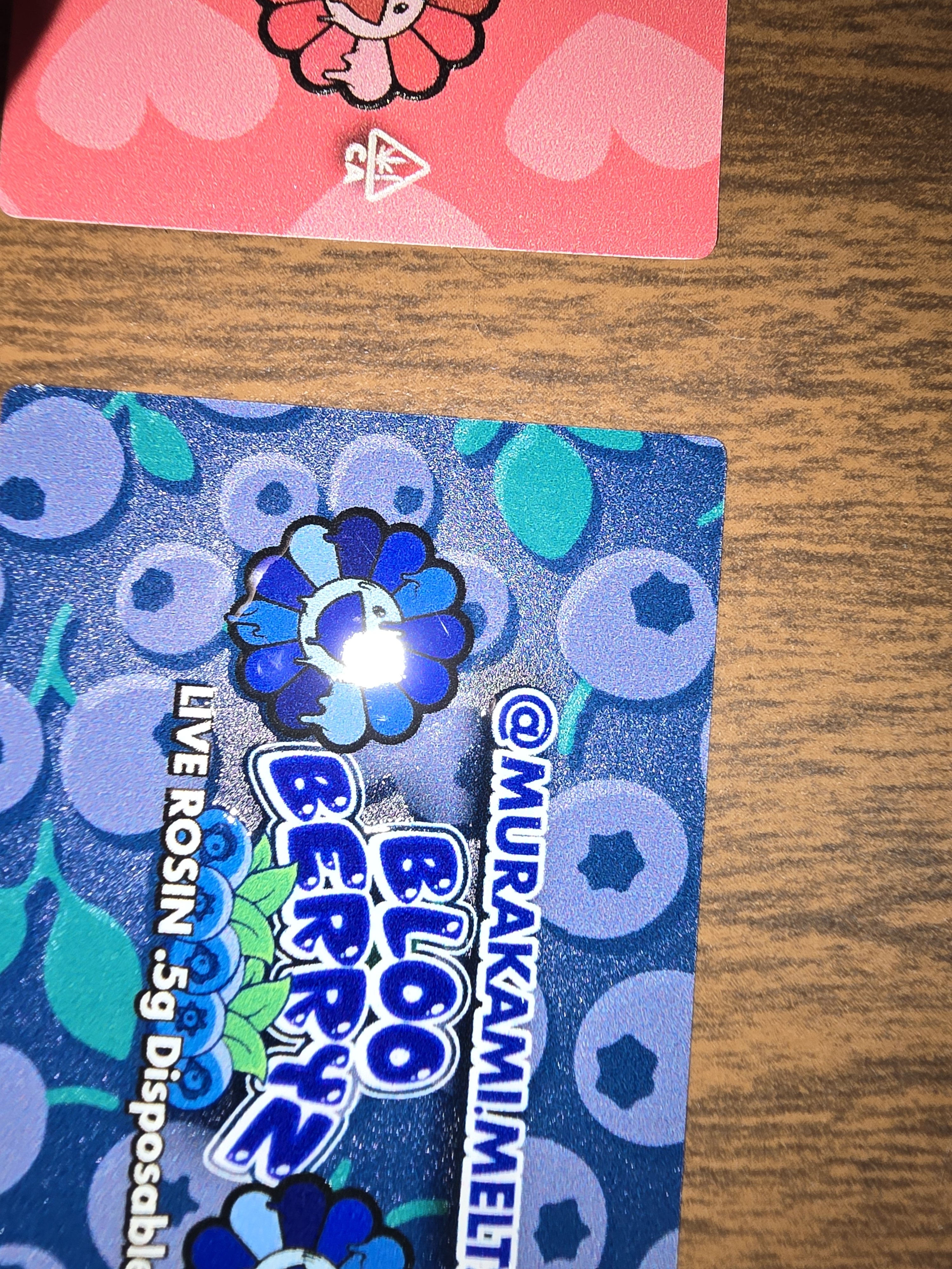

So turning off MAPS all the way, the first inch of my prints are super comparable to the Roland's wet glossy look:
After the first inch or so though, it devolves into the more textured look:
The gloss layer also seems thinner at the end of the print, looking more like a clear coat than a thick varnish. You can tell by how tight the reflection from my flash is in the first pic vs the second pic. It gets diffused by the texture. For reference this is 1200x1200, 32 pass with 2 overprints
I think this is either caused by only half the lamps being turned on for the first inch or two of the gloss print, or something to do with the head not stopping back at the station soon enough to fill the reservoirs with ink? No idea, but it does seem like there's a clear (pun intended) difference in coverage from the front to the back of the print...
