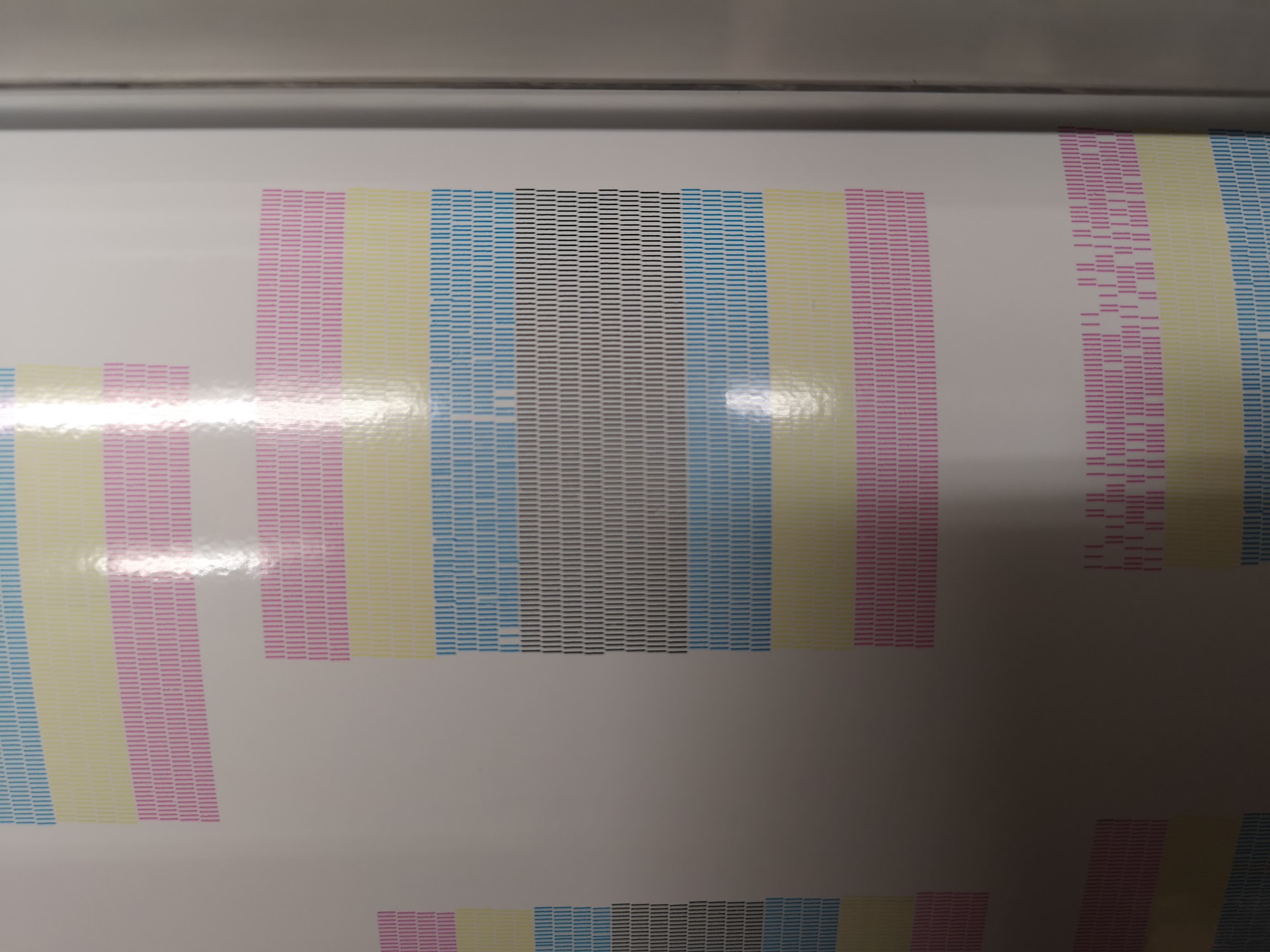

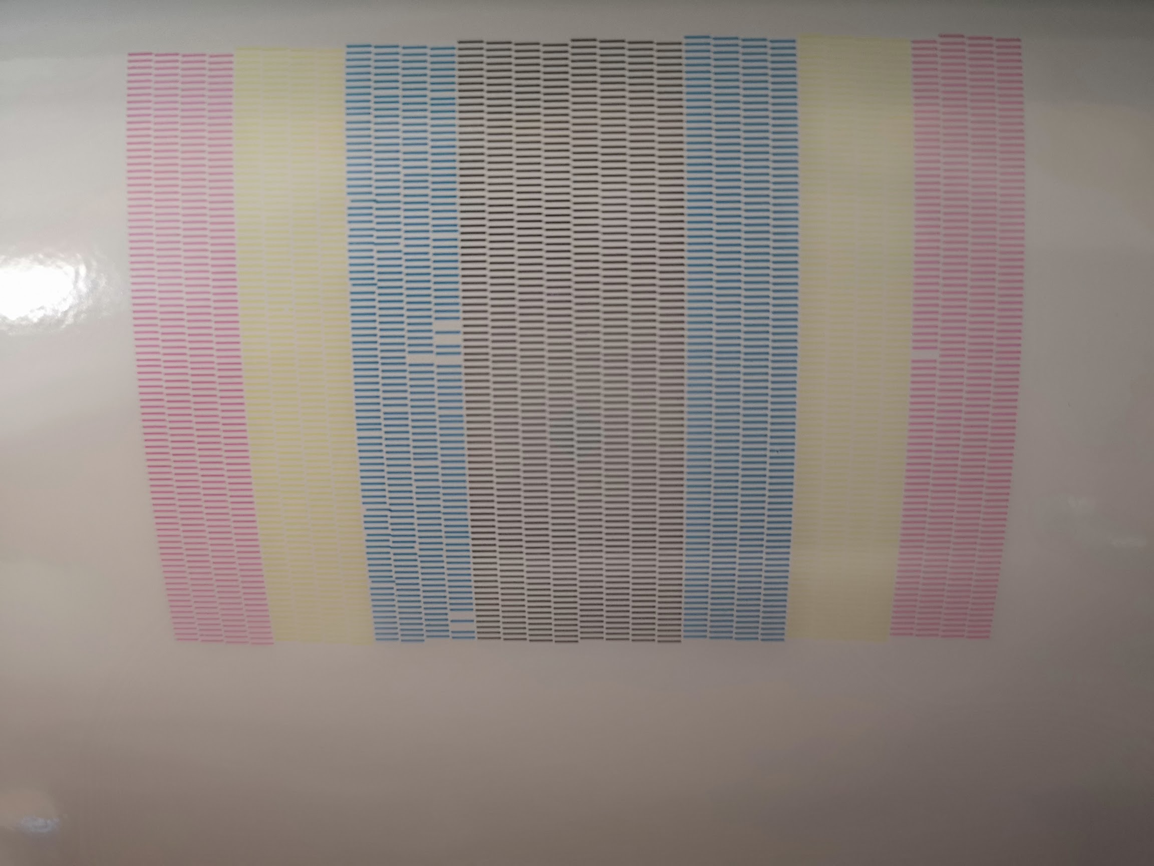

I have a roland VS-640i, I'm getting deflected nozzles and a few missing nozzles in cyan.
I've done normal cleans, I've done manual cleans but they do not come back and the deflected nozzles remain the same. I've also put cleaning fluid in the capping station and and left for 24 hours and that did nothing. Are these gone forever? Can i do anything to bring them back?
On another note if you look closely, there is a dark section along the middle, it looks as though the nozzles overlap slightly, is this right? I look at other people test prints and theirs look like it flows.

When nozzles don't come back after many cleanings and head soaks it usually means they are physically damaged either in the shape of the nozzle itself or an internal issue that just stops it from firing. As a last resort you can try flushing the head with a syringe and cleaning solution but it can cause damage internally so you would want to be prepared to buy a new one in that case.

We used to get test prints like this once they got old replacing them often helped.
The print definitely isn't the worst I've seen.

The reason what made me start this was because of banding. I've just printed on high quality and I still get banding, so I print a feed test and it's past -50 (can't go even further as it maxes it out that) and it's currently set on -10.
How can it be this far out?
Joe House
Sign Equipment Technician
Your feed adjustment is too low from looking at the nozzle test print. Try setting it at 0 and post a new nozzle test or the actual feed calibration test
