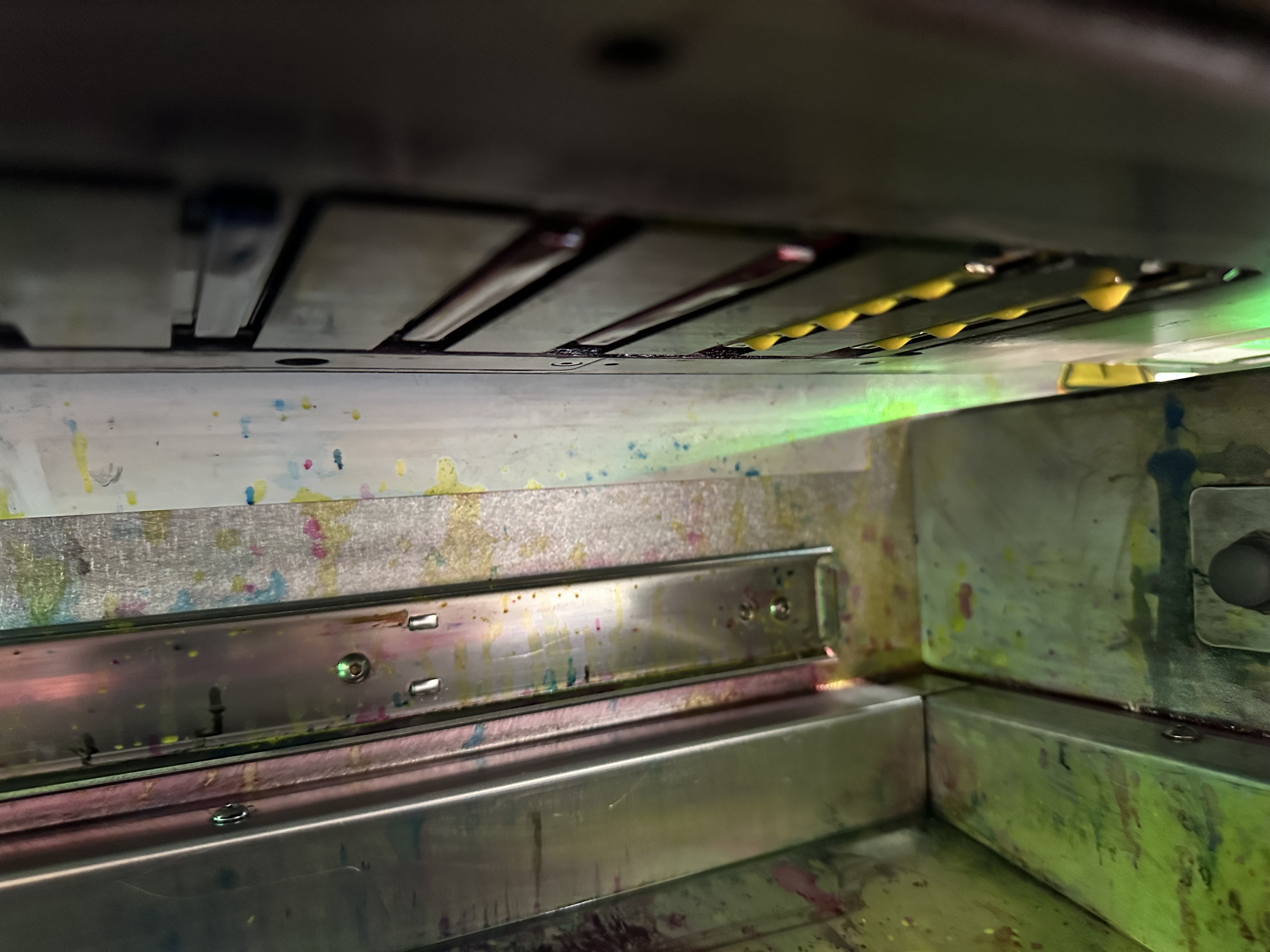

After purging all 4 colours the yellow is the only colour that has residual ink on heads.
We literally JUST went through this with our 318gl last week. Tech replaced the degas filter for yellow head (How they can charge $2500 for a piece of plastic is beyond me) and replaced all secondary ink filters (or whatever those clear disc filters are above heads) and it took care of the issue.
Our meniscus vacuum level was doing the exact same thing, bouncing back and forth.
