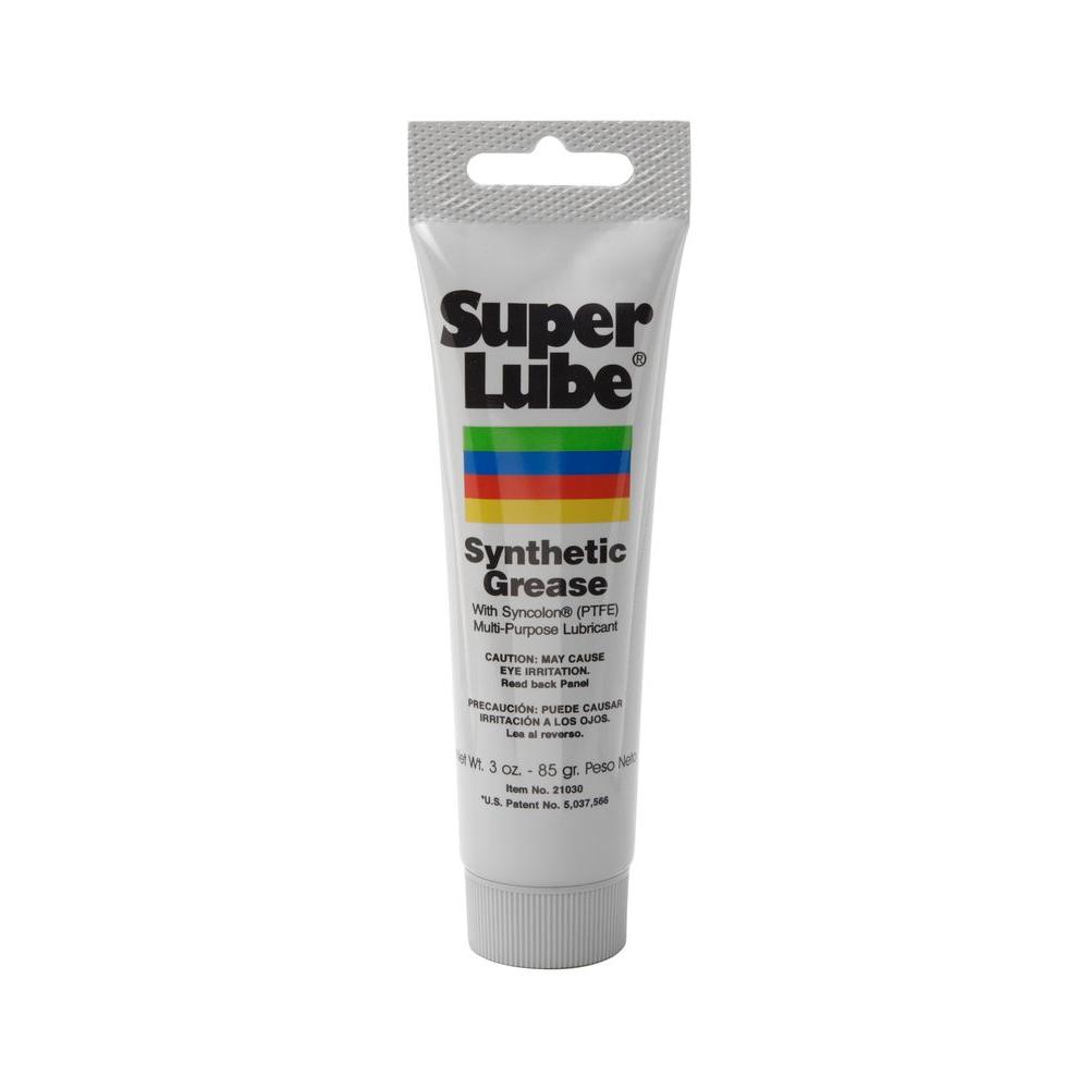

Super-Lube grease. DO NOT use a grease gun, there a bulletin out about not using a grease gun. Most people pump way too much grease into the bearings. Just wipe some of the grease on the rails with your finger and wipe off excess. Also, clean your encoder strip, wipe with clean rag.
