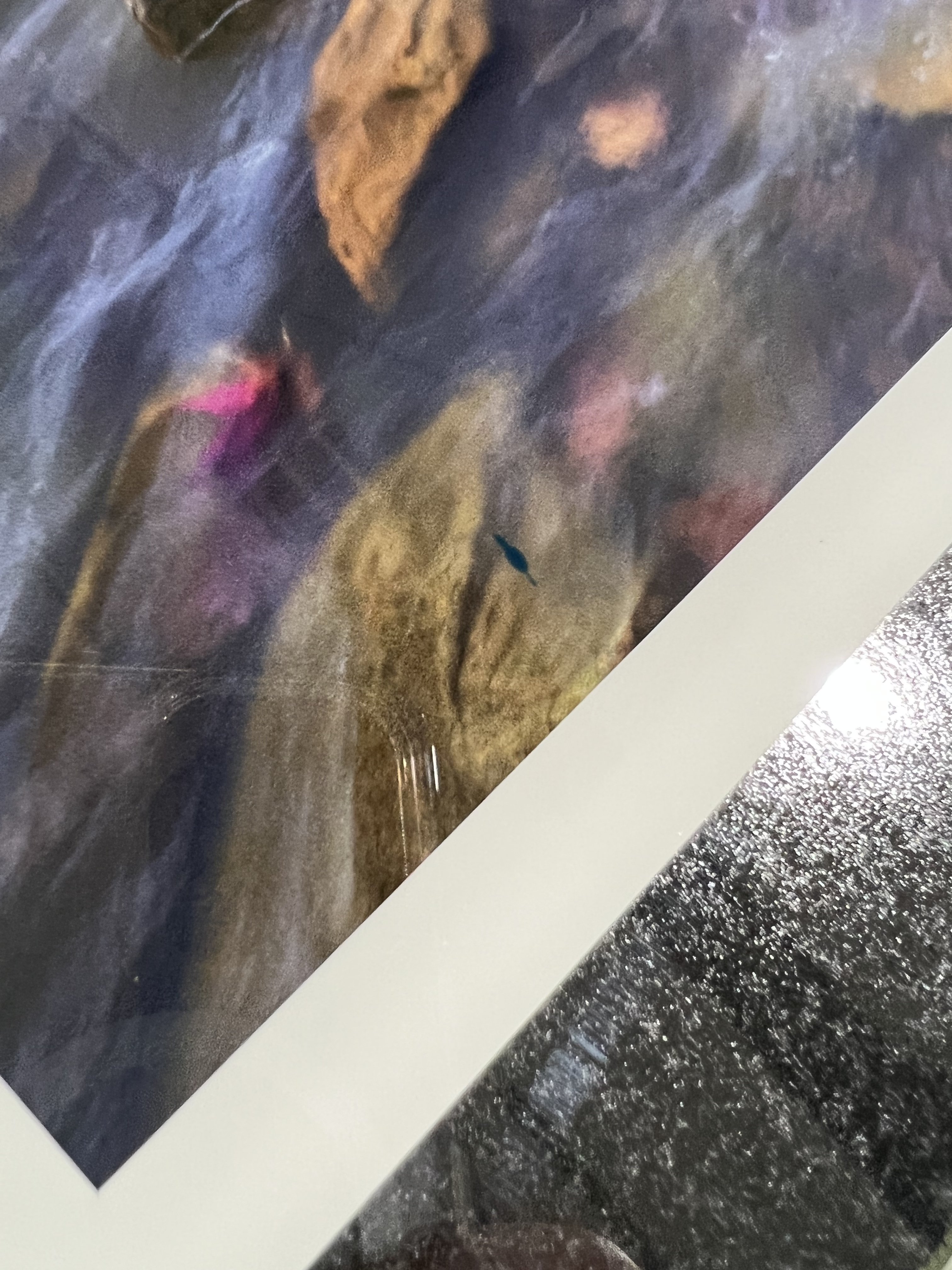

We’re 3 months new with the arizona 2380XTF and it’s been going well.
This week it started spitting on the prints. Happening on white floods and randomly on other colors. We print mostly photographs on acrylic and dibond so a spit ruins the piece. A magenta spit was preceded by a blocked nozzle, after the spit the rest of the print was clear. Nozzle checks are all clean. Canon thought it might be buildup on the carriage but happens right after cleaning.
Any idea on what might cause this?

We had the same problem with our 1380GT, I’m conviced it’s either media or static related
We printed certain jobs on PVC without problems for ages and then the customer decided they wanted to go “plastic free”. We started printing on coated board and got the same problems as you seem to have, wiped the printheads with flush, purged the the printheads, wiped the media with IPA cloths, still the spitting happened, exactly the same size and shape as your photo only it was yellow in our case.
I wiped underneath the anti static bar and bought a different make of uncoated board and the problem went away but I don’t know whether it was the anti static bar or the different media that solved the problem.

We have an older Arizona 350 and has happened to us over the years as well. Our is from if the head picks up a slight piece of dust then the ink will form a droplet then it will spit on the media randomly until we pause it and visually look and see the micro spec of dust/ tiny hair or fuzz then just quickly swab it then back to printing again and all is good. Even though we have the anti static bar and have wiped all the media and visually inspected it.
Not sure if your is the same but sure looks like it. We just installed a new HP R Printer and are loving it so far. No more problems with static or ink spits at all that would ruin prints. We still have our Arizona though.

Rx7boy was right on. There was a piece of fiber stuck to the topside of the carriage tray hanging out slightly near the magenta head that was wicking ink until it dripped. I’m heading to Arizona tech school next week and just received access to the tech manual which diagnosed it perfectly as well.
We used to roll the acrylic with a silicone dust roller before printing and suspect that was creating extra static and contributing to the problem. We now wipe with antistatic solution and blow off the dust.
Last two days, no drops so fingers crossed.

Any ink drop is generally the cause from static and dust/dirt getting caught on the print heads or undercarriage.

We've had this happen too on our Arizona, and is always due to static causing dust/fibers to cling to the carriage.
Keep your humidity as high as possible (50+%) and visually inspect head area and sheet before each critical print.

My Acuity (Fuji branded Arizona) is located in an area very difficult to climate control. I run several different weights of polystyrene which loves static. I do two things when she starts spitting at me: 1 - clean the undercarriage with isopropyl alcohol 99% 2 - run an invisible vapor humidifier near my printer, but not too close. That seems to do the trick. For me, this is a frequent wintertime issue, but that's Ohio!

I know the humidity is a contributing issue. Fortunately we haven’t lost a print in a week. We’re looking into an environment control unit for the HVAC. Here in Arkansas it’s too humid in the summer for our sublimation process and too dry in winter for the inkjets.
