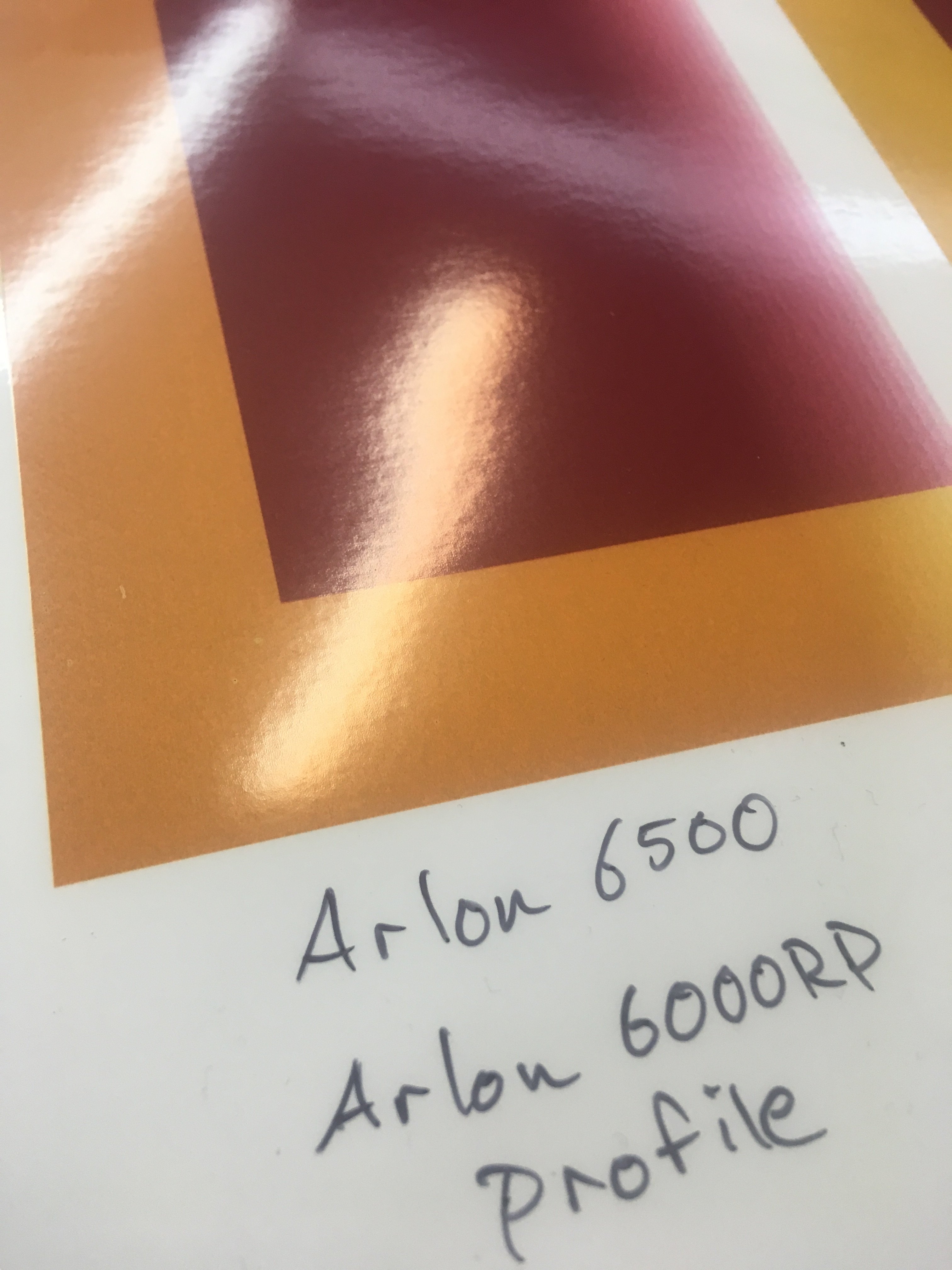

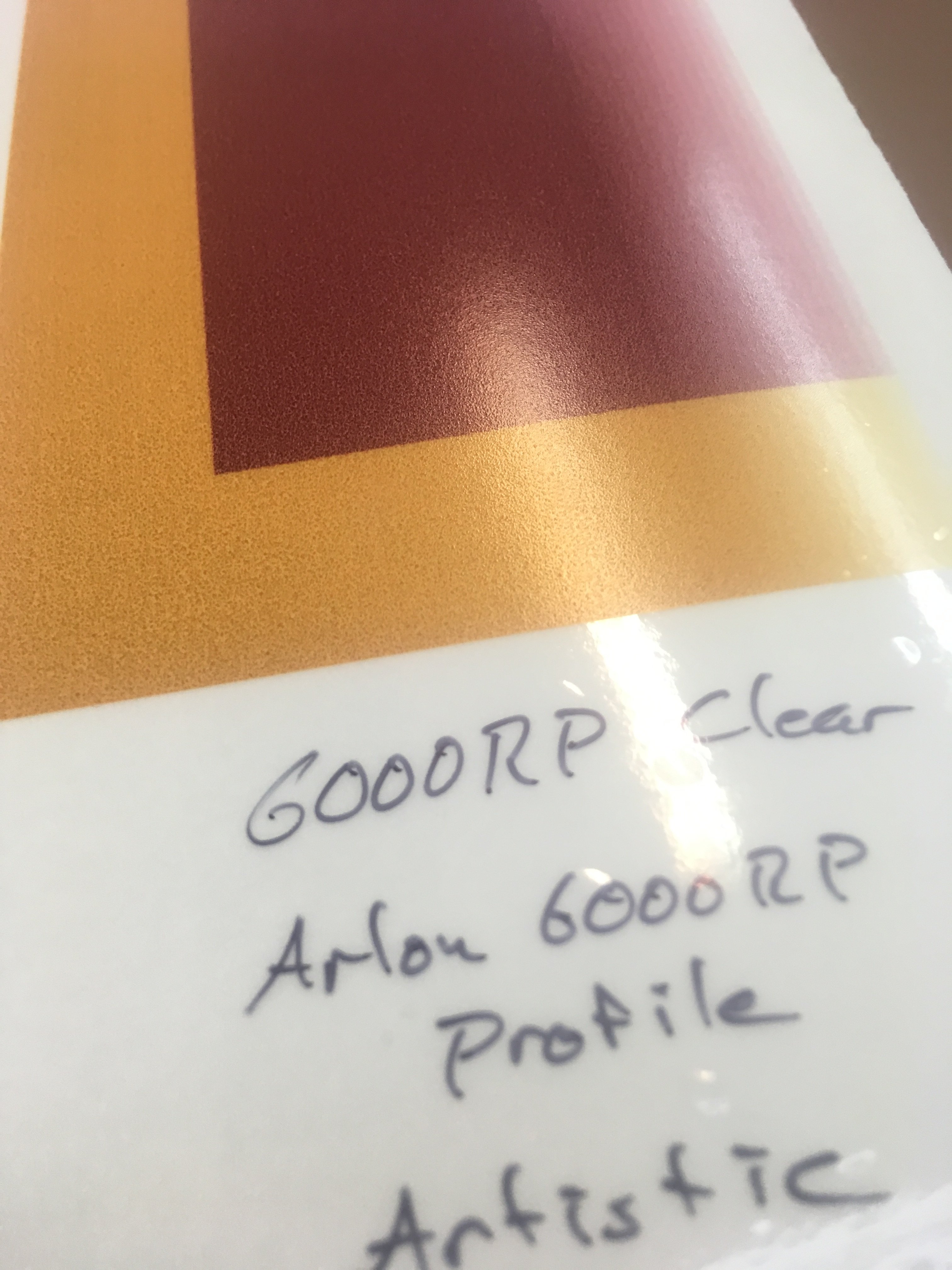

Just got my first roll of Arlon 6000RP Clear. And this is how it prints. I printed the same thing with the same profile on 6500 and it did fine. Any thoughts?

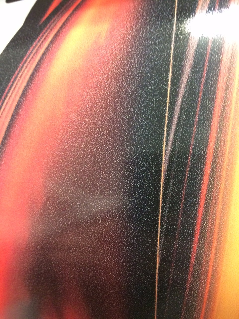

I'm facing similar issue here with a roll of 3M IJ180mC (the new one). Same file printed with same profile on the last feet of my previous roll of 3M IJ180cV3 comes out perfect, new one has grainy look. Basically it's the very same vinyl, just a different adhesive pattern...

Probably putting too much ink down for the media would be my guess. Adjust your the profile accordingly.
And, if you're using their "canned" profiles- no matter what the manufacturer's claim (unless you're doing your printing under strictly controlled conditions like they are) you're most likely going to need do some tweaking.
