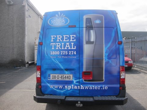

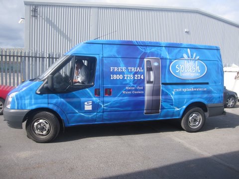

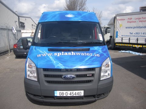

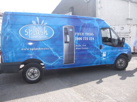

just fit this for print company,they have started using ARLON which will not stay in the door handels

i wraped Mercedes Benz van simillar to that and it failed at the door also . i never like Arlon for complexed wraps it has a tendency to fail in complex curves. it is good for simple wraps. it has a total different texture from 3m regular or v3.it is also thinner and the liner is stiffer. and it reacts to 3m primer. just my opinion
