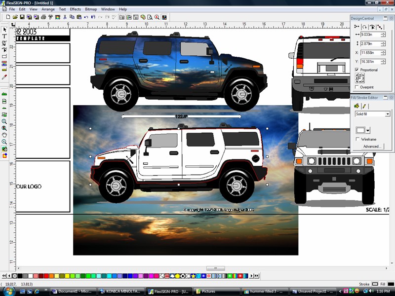

Well, I bring in a template from Signshop Helper into Flexi.
I then ungroup the image and select one of them.
Next I bring in a picture to use as a fill.
<?xml:namespace prefix = o ns = "urn:schemas-microsoft-com:eek:ffice:eek:ffice" /><o:p></o:p>
I can Arrange it to the back, but that doesn’t work.
I’m missing something here.
How do I make it show through on the template only?
Picture attached.
The Blue Sky is what I want as a fill.
<o:p></o:p>
TIA
<o:p></o:p>
Bradster.

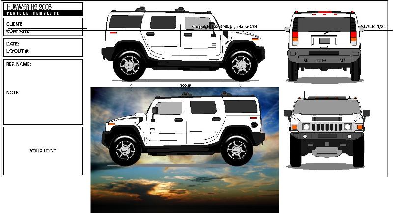

In Jays method, I like how the detail is maintained, (windows, molding, badges) and the such.
The question is, how do you move the picture around behind the outline so it shows through for the purpose of positioning?
I can select the outline and select either “No Fill” or “Wireframe”, but then when I move the picture around I am no longer able to select the outline.!.
Mike, I'm using Flexi Pro 7.6
Thanks again, pic. Attached
Brad.
:Cool 2: :Cool 2: :Cool 2: :wink:

Bradster941
you can select the hummer and do an ungroup. Next while still selected use the compound tool. this will create just outlines of the hummer or...
Go to edit>select>select by attributes. Under color check mark the white and select OK. This will select just the white panels. Group them together. select the white panel and the picture. Go to Arrange>Mask>mask. this should accomplish a better looking proof!
Hard to explain but very simple to do!
Jay
cinemasign.grafix, this is what I'm following as it makes a nice proof.
The only problem is, I can't seem to move the picture around and see it through the (white) panels unless I select wireframe or no fill.
Once I select either of those options, though I can see the background picture at that point and reposition it, I am no longer able to select my outline to Mask it with the picture.
Hope this makes since,
and thanks for trying to help.
Brad.
