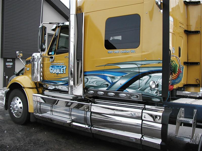

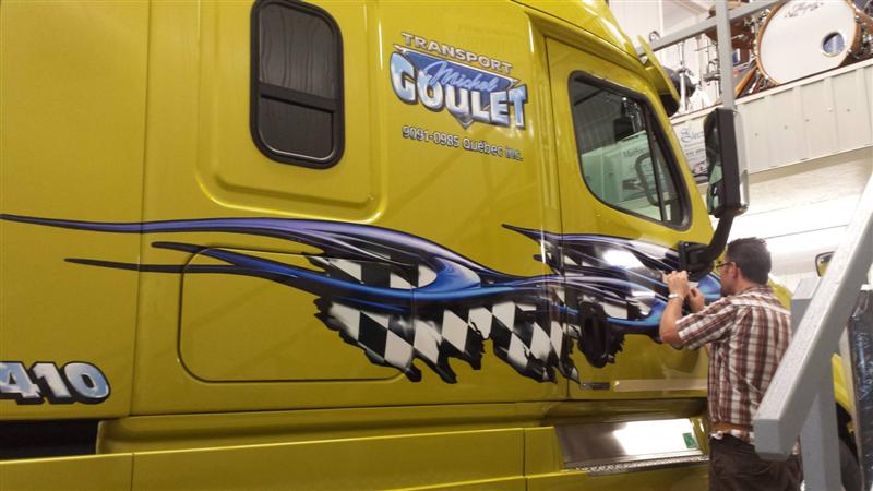

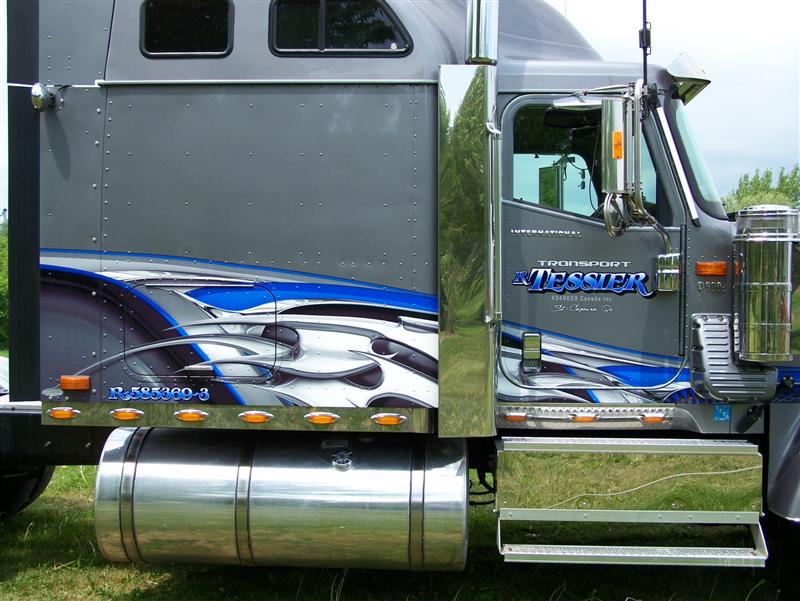

Why don't you just contact Grant Dorsey ( grant@auroragraphics.net ) since he prints from a Roland printer and probably have the knowledge to guide you to get expected result. He's been great to me when I hit the wall. I use Flexi and a VS-540 and my blue print just fine. If I send my file at my friend's shop to have it print quickly on his HP Latex, it prints way too purple for my tastes. 'Matter of profiling I guess...
