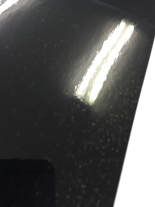

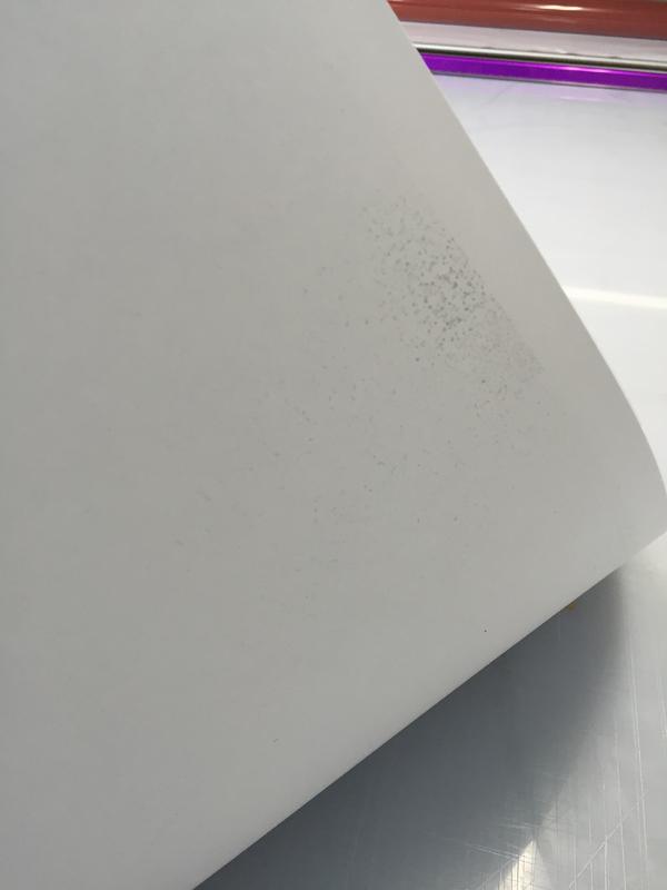

Hi,
I have a little problem printing with Avery mpi1005 the ink is going through the vinyl and leave rough spot on the printing side.
Printed with versaworks high quality profile max impact
thanks
Seb
woolly
Not a avery fan myself but does look like over inking
It is posibly a special version of vw to run a SC so profile could be well off
