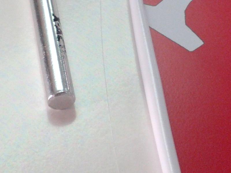

Avery Strike.....AGAIN
2B
Luckily this was not installed before the issue was noticed...... as it only took the vinyl 4 hrs to reach this state
That is a handle to an Exacto knife for reference.......
and yes there was a 1/8" no-bleed area
Material is MPI 2120
MikePro
calendared overlaminates will do that if you have your tension set high, especially with a laminator that has heat-assist.
2B
it shrank back from the cut line in the image, didn't measure how much used the exacto handle as a reference
The imprint had a 1/8" "no bleed" from the print edge to the cut line to stop it from curling.
printed Roland OEM Eco-Sol - speed ink coverage.
This is non-laminated
fresh
Did you cut immediately after printing? Is it laminated?
The ink needs time to cure, and if you cut any vinyl before the ink has dried, the material will curl.
