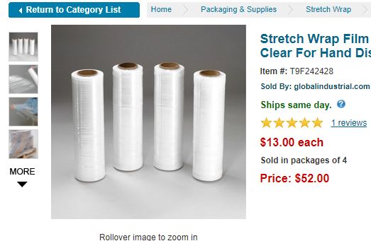

Isopropyl alcohol is the go-to method. Adding shrink wrap over the alcohol keeps it from evaporating and helps it soak into and loosen up the ink faster.
If that is not enough in a situation like yours, ‘TON of full bleed boards’, then the next level is print head flush. You can use print head flush in conjunction with industrial stretch wrap film. I’ve attached a jpg with an example of the stretch film. Readily available from many suppliers at various sizes. At the end of the day/shift, simply apply the HP UV Print Head Flush (Part [HASHTAG]#CH122A[/HASHTAG]) to the belt while simultaneously covering the entire belt with stretch film. Then apply flush and film, then advance the belt, repeat until the belt is completely covered. Allow it to sit (soak) for 5-10m,
Then start removing the film and wiping down the belt and removing the ink using rags or paper towels. A plastic squeegee or chiseler should not be needed with this method. Caution must be used with any scrapers since marring the surface will make future ink removal that much more difficult.
It is important they follow up with wiping the entire belt with isopropyl alcohol to remove all print head flush from the belt surface.
This method should allow for a cleaning time of approx 30 minutes or less, depending on ink thickness.

I'll give the heads flush & shrink wrap a try. We've been using denatured alcohol and soaking shop towels with it and covering that with vinyl to keep it from evaporating, letting that sit for 10 minutes and then scraping off the ink that 'blisters'. There's quite a bit of ink, so we usually have to do each section twice. I was just hoping to avoid doing as much of that as possible.

Just be careful with the head flush...a swollen belt is basically a write off machine.
