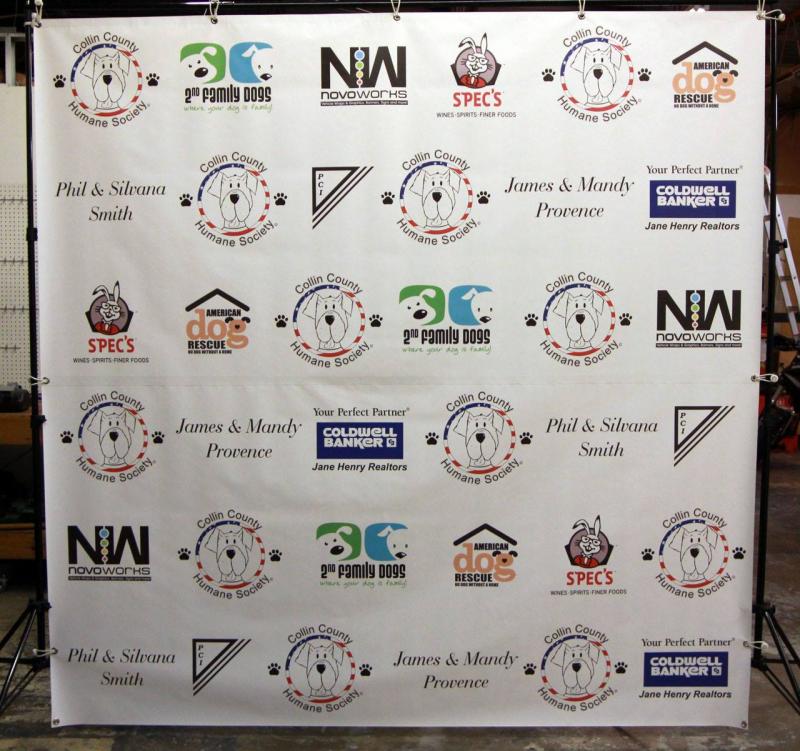

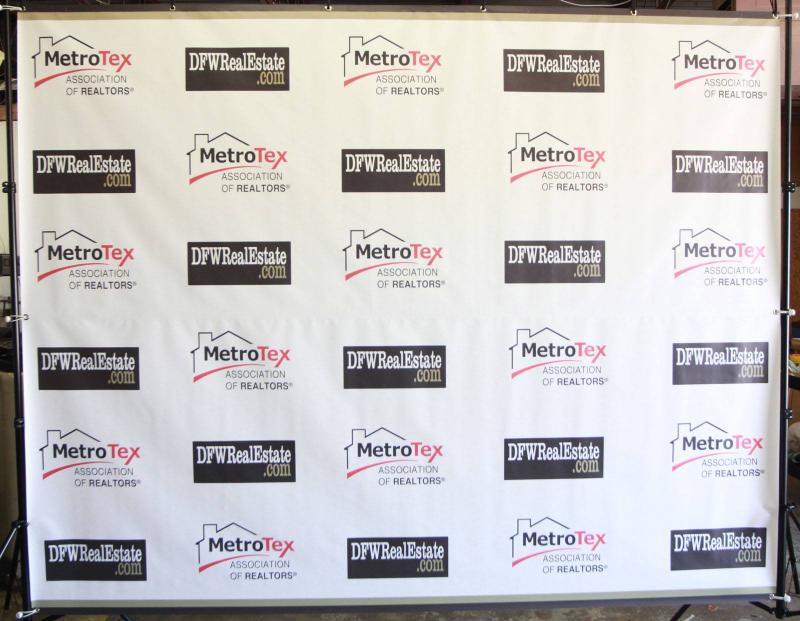

mnapuran
Yup... have a 54" printer also. We do a lot of these with a center seam.
