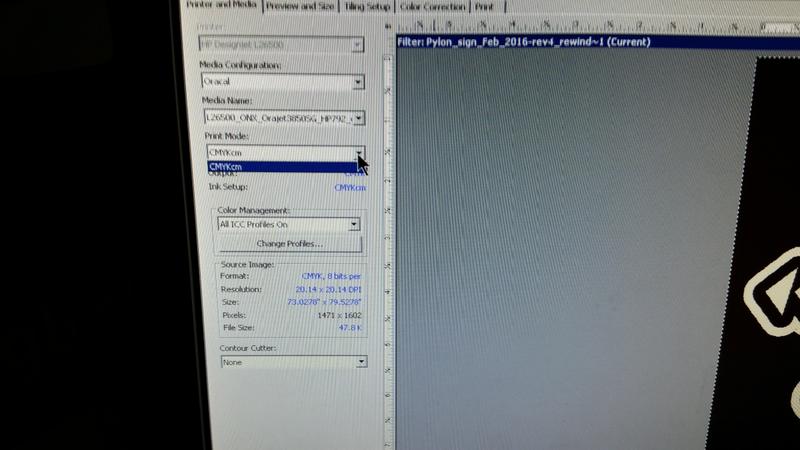

What pass mode are you using?
dasigndr
print mode is = CMYKcm

the pass count is usually where the print mode is shown on the image. I think because I am using a different media. If I use HP then I have the option of choosing the pass count.
The media profile I am using is for Oracle because I was told to use this icc profile for the backlit media I am using which is a RiteMedia product.

Ok try going onto the Lexjet/BMG/S.One website or the HP Media Locator website and download a canvas profile which should put the pass mode at maximum. Or you can try some of the other backlit profiles HP has loaded on their site.
