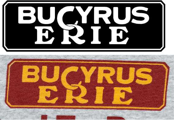

Thank you for your suggestions to those that did....Signosaurous Rex, I took your advise mostly .I did the "Bacyrus" from Copperplate Gothic Heavy and with some node editing I got that. The "C" is made from bezier tool. The word Erie I used Bookman xtra Bold and tweaked it a bit except for the "R' was built from an "I" and bezier tool.

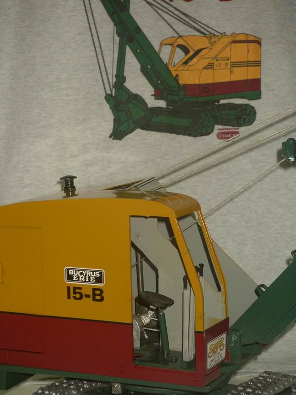

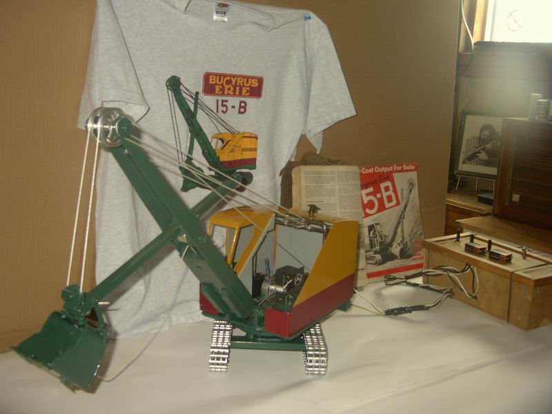

I also wanted to show you the scale model that the guy brought so I can letter it. I have described it in other thread. I am posting another pic of it though and the finish layout of the logo generated from the t-shirt I used for copy.

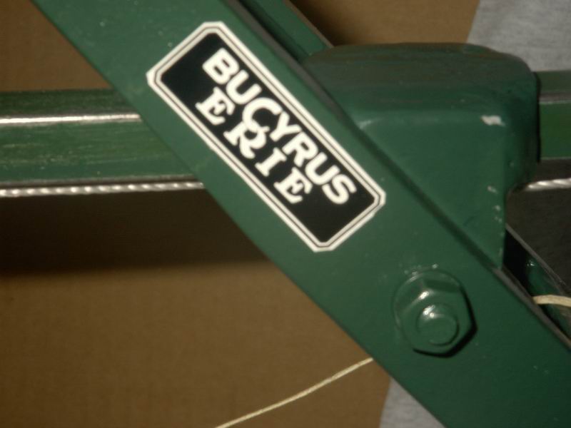

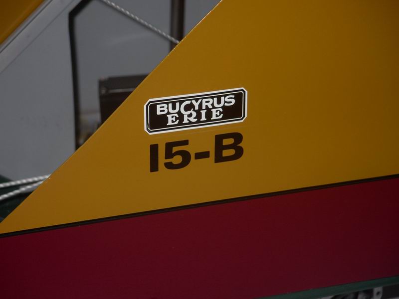

Model is all lettered. I put a stripe for him too to seperate the 2 tone paint.
white letters are 5/32" and black letters are ½".

Forgot to mention that this was all cut vinyl on a " CAT " plotter. I didn't know if it would handle the 5/32", but I went in close and rounded all corners first. That made the big difference.
