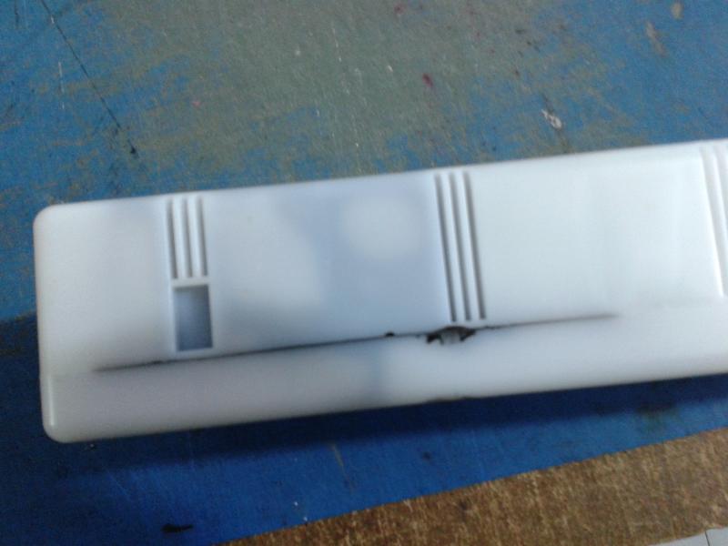

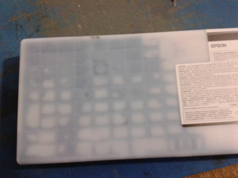

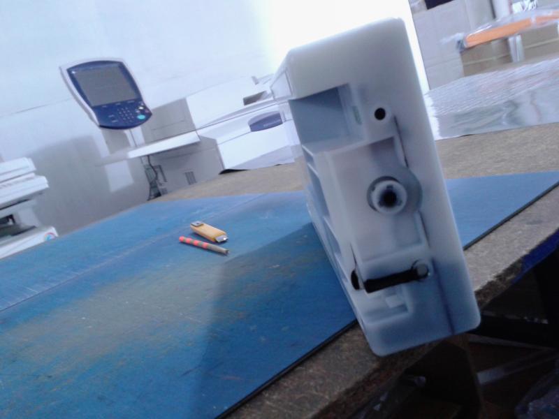

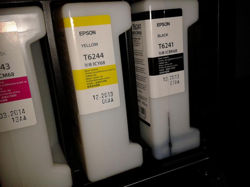

I was printing normally when the black ink stop firing I did some cleaning cycles but did not work go to check the ink and find out the cartridge its bad , now I change the cartridge but the line of the ink its empty I do some hard cleaning cycles an it fills but not for long, any ideas, how can I create de vacuum so the ink keeps on the line.

you are going to have to call an epson tech. most likely you will need to buy the flush kit. run the flush. then insert new ink cartridges.
romichoux
on your printer there is sub tank below cartridges and there are valves on the ink tube between sub tank and print head so it's difficult to know where the ink stops. you need the code to charge the ink for all colors. I don't know another way to do it.
