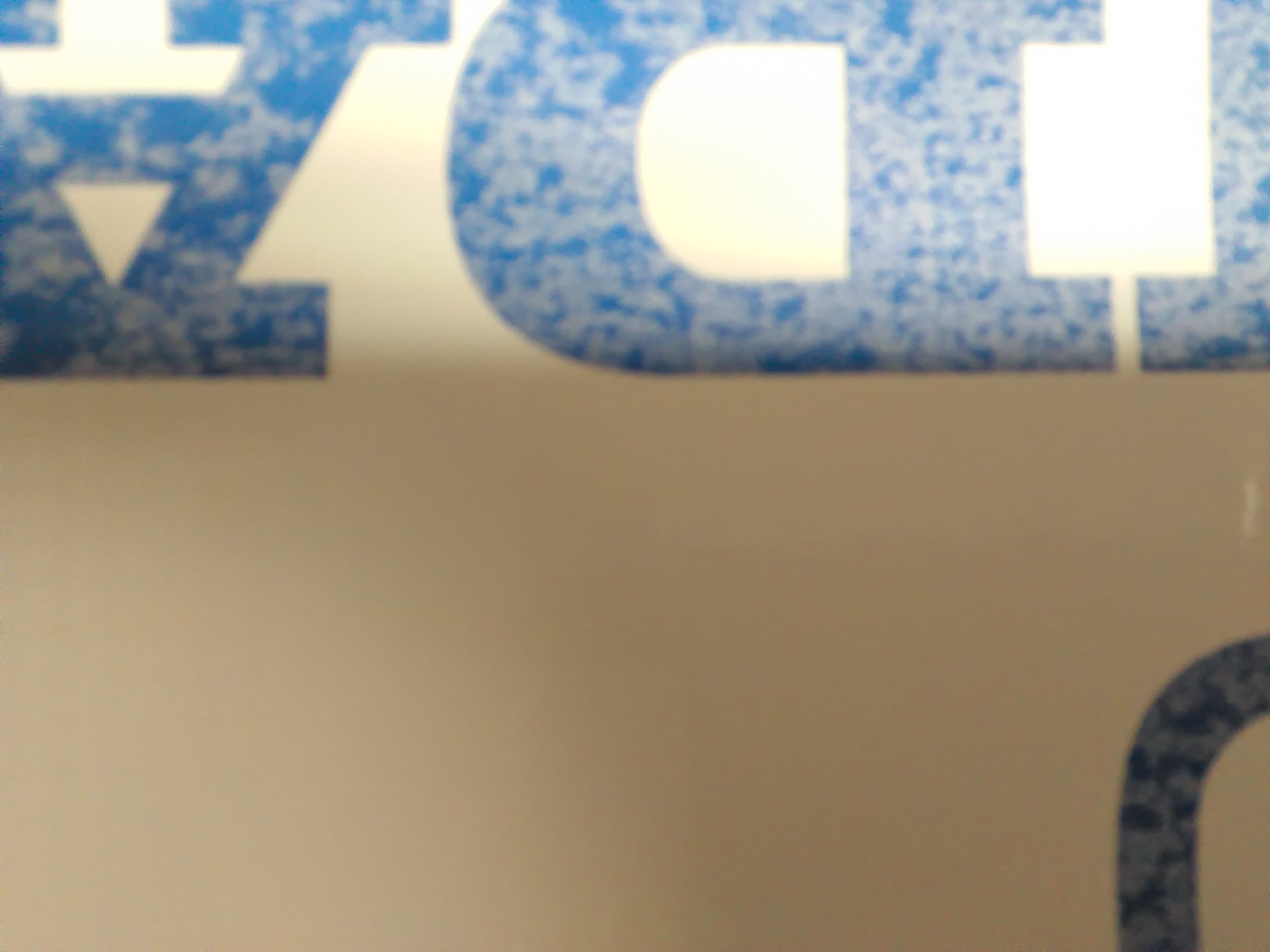

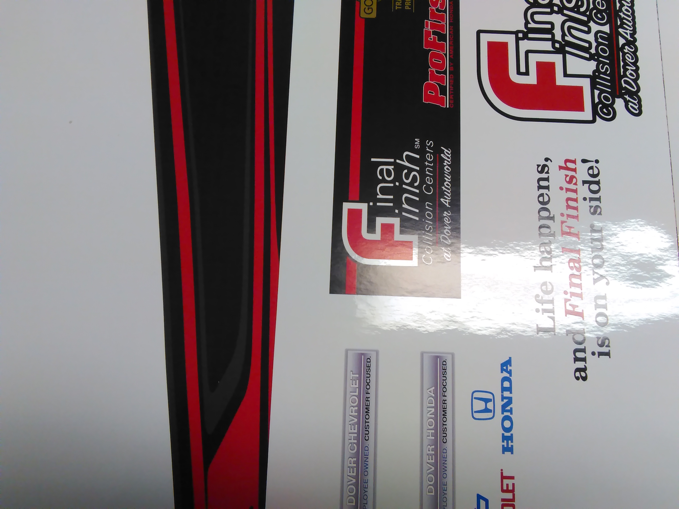

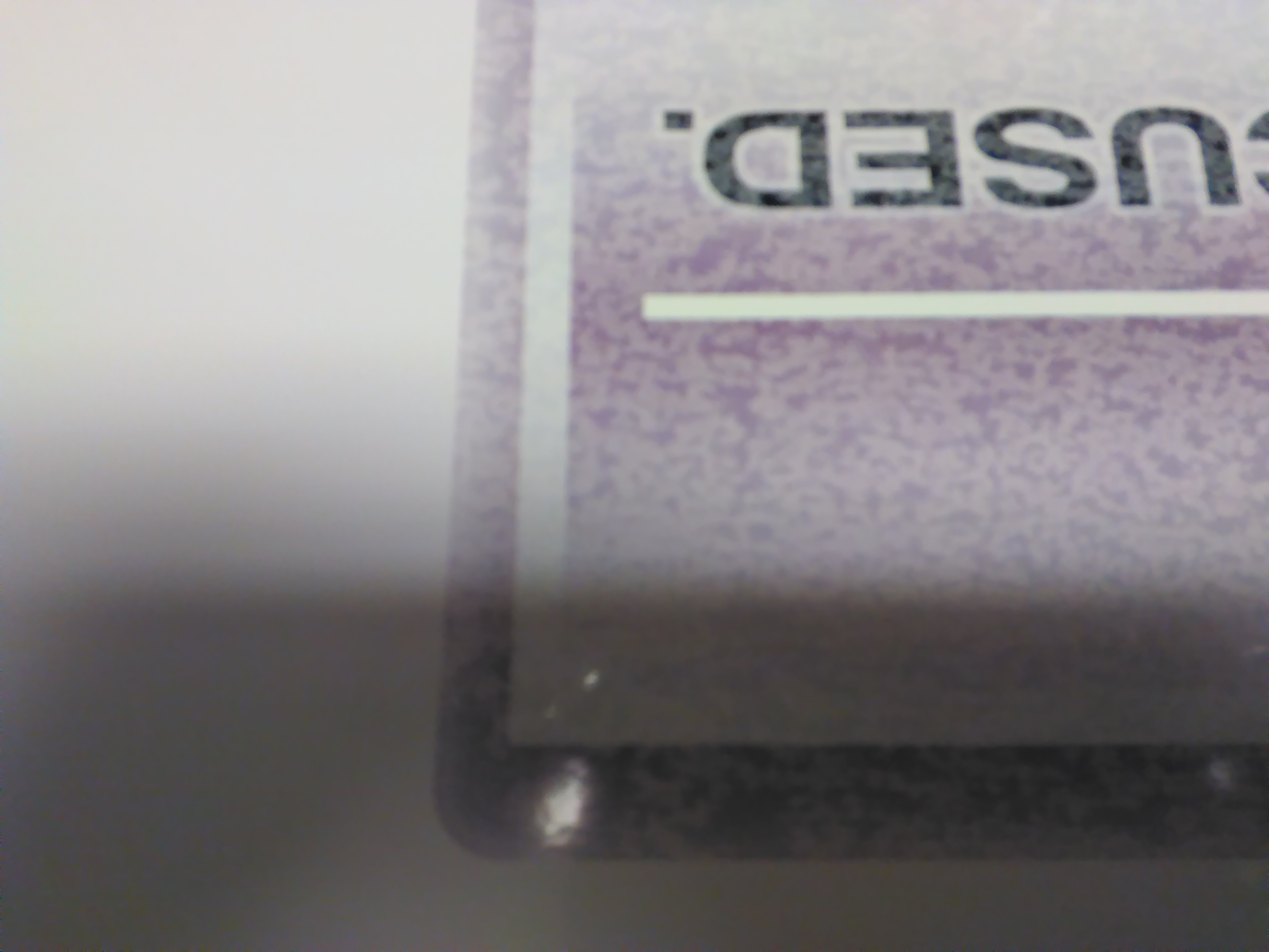

Hey guys, I think I've gotten a roll of vinyl that's no good? What are the odds of that? I got a roll of oracal 3751GRA. I did a small print to check my colors before I started to print the job, and everything looked great. Then I started printing the job, and it looks like it has white spots all over it. I pulled the vinyl out about 4 feet and tried again, no change. I put in another piece from a previous roll and it printed fine.
Anyone seen this before or any advice? I'd questions if it was a printer/profile issue if it hadn't printed my test print great

printhog
Some kind of surface contamination. Likely silicones from the release liner offsetting onto the vinyl. Return to supplier.
Sent from my SM-G900T using Tapatalk
Sign Works
Yep, several of us got contaminated rolls of 3751GRA recently, just do a search for "contaminated". Return media to supplier for refund or exchange.
31legen
Be certain when you ask for a replacement to make sure your not getting another roll from the same bad batch. Tim at oracal will be able to tell you which suppliers got rolls in that batch. I learned this the hard way and just switched to 3m. Id had a total of 6-8 bad rolls of 3751 and gave up on there reliability.
printhog
Rolls should have a lot number inside the core. Note it and you can prevent getting additional defective rolls.
