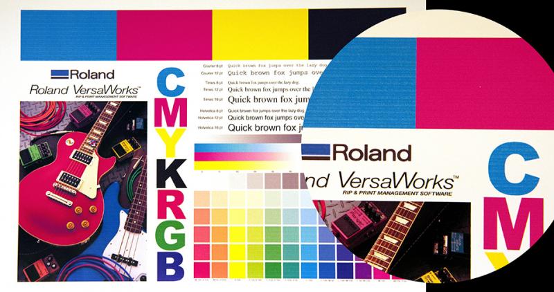

When I print the VersaWorks print test on a SP-540v, I get banding ONLY in the CYAN, what could cause this?
NO banding in the other 3 colors...
Thanks

while your C is the worse head it wouldn't cause that amount of banding.
looks like you have a bad connection in the wiring/cables
splizaat
The cyan on our sp300v does the same thing, but not nearly as bad, and our test print is 100% perfect. I have no idea why it bands, but we've never been able to get it to go away...heater settings, cleaning, etc. Nothing makes the cyan banding go away so we just get it as faint as possible and move on.
