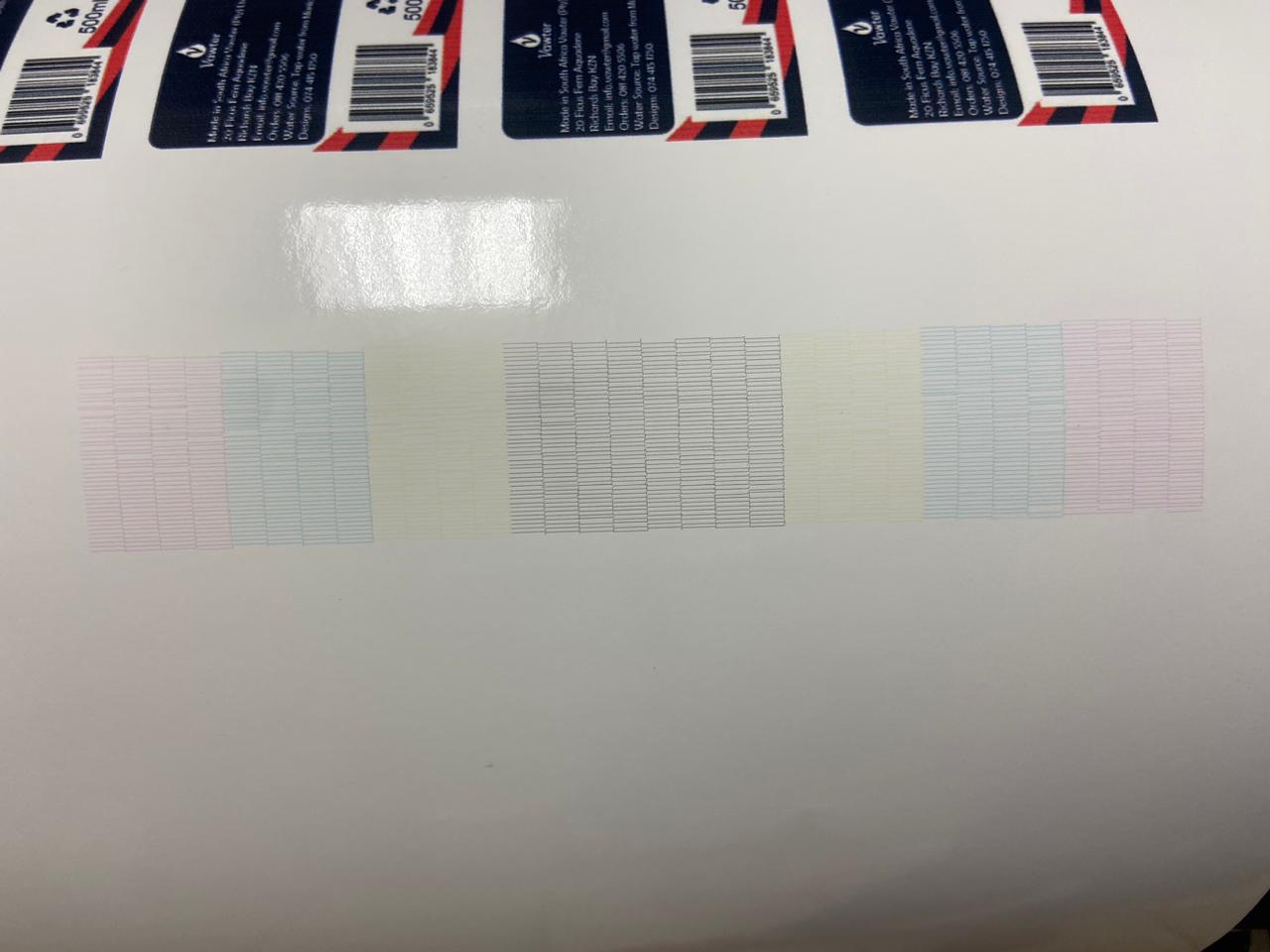

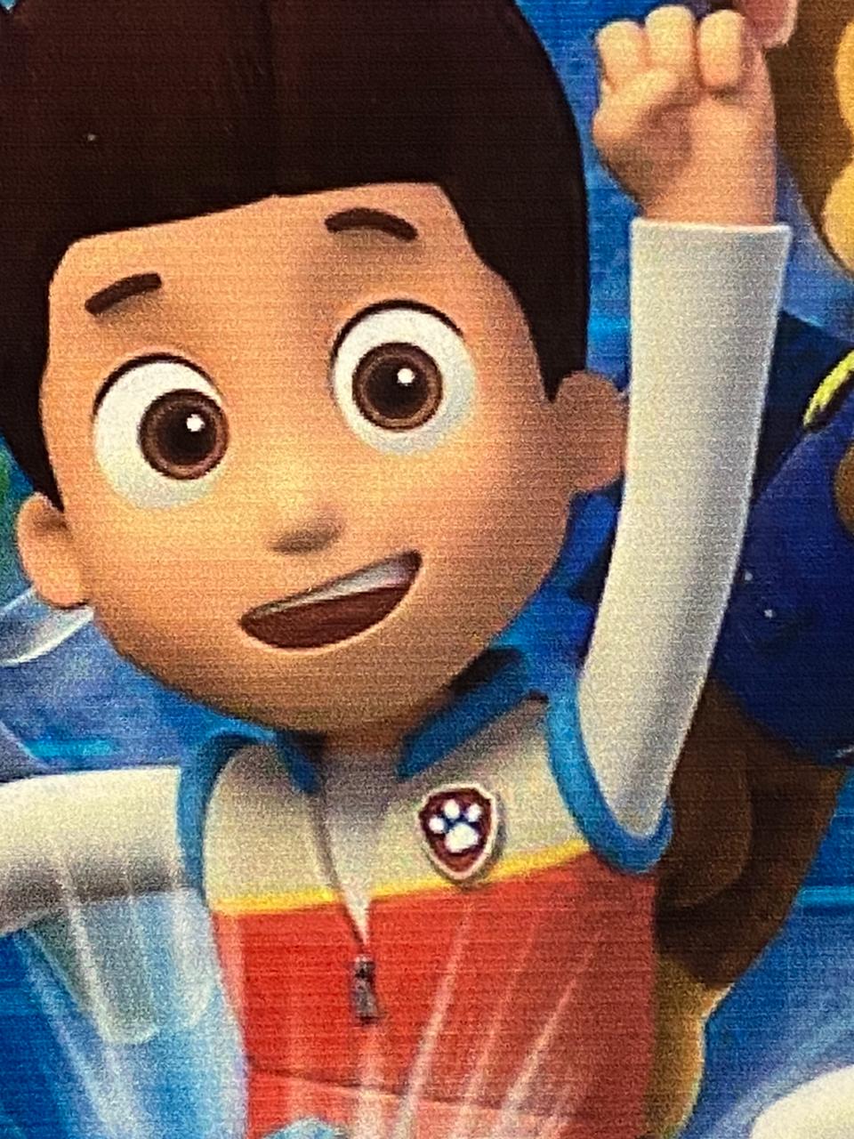

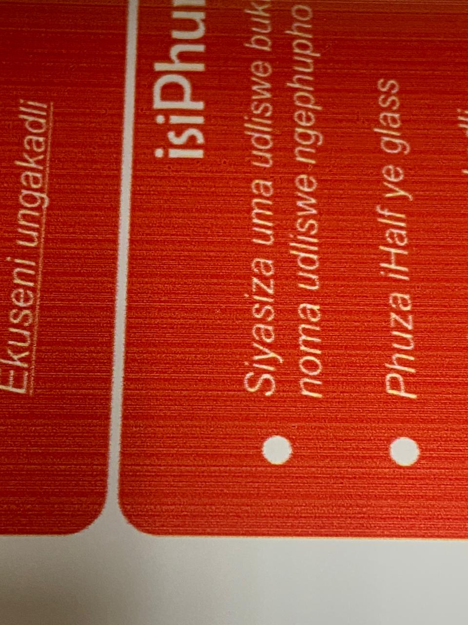

Hi Guys,
Im using a Mimaki CJV30-100, getting real bad banding issues, cannot clear nozzles.
Head is about 6 years old, soaked every night in cleaning solution, and I do a 10min nozzle was every day before I start any printing. Capping station replaced in January, wiper replaced last month.
Ive tried every trick I know, if flushed cleaning fluid through the head from the top where the dampers fit in, ive syringed from the bottom where the pipes connect to the pump. ive done all the washes possible on the machine, and Ive even tried to update my firmware to add Maps (i saw that on a previous thread...) but just getting errors, the software doesnt want to upload to my machine.
I really cant afford a new head right now.
I can see clearly that the Magenta left test print is not closing the line at the end? if that makes sense? usually this is because the capping station is not closing properly on the edges, but my capping station is new? less than a year old.
ive attached images, if anyone can please help.
I haven't changed dampers in a long time, but I dont think its a flow problem, can clearly see on the test patter the nozzles are not firing.
any help please

I did see this in another thread here on signs 101, and I have been having ALL of these problem, except my capping station is on 3 MONTHS old!!
is it possible that I just got a defective one? I usually change it once a year
Signs the cap top needs to be changed:
- You come in every morning and are missing a lot of nozzles
- 1 or 2 normal cleaning cycles doesn't recover nozzles
- The waste tank doesn't fill up as often as it used to
- Cartridges are reading empty when there is still ink in them
- It's been a year or more since you changed it
Smoke_Jaguar
Cap top alignment can shift, or might not be done right in the first place. Good to go through the procedures to make sure it's actually sitting right on the nozzle plate.

SGC
6 years is already strike number one. Strike two is constant nozzle washes and head soaks. The solution breaks down the nozzle plate adhesive over time if overexposed.
This more than likely isn’t the cap.
unmateria
looks like bad wiper. After a clean cycle, try cleaning the printhead with one of those cleaning stubs without any líquid and very softly

Ok, I was told when I purchased the machine to never let the head dry out, so I always leave it in solution overnight, and then do a nozzle wash before i start printing. is this not correct?

The wiper is also new, 3 months, when it wipes, the ink that it wipes off sits on the wiper edge to edge, so its not only wiping in the middle, I saw that on a different thread as well so I checked that first.

We used to run a JV33-130 Mimaki and one time i started losing some of my magenta nozzles, and then it was all of them and then one or two other nozzles were missing. i tried everthing, cleaning, nozzles washes, wiper change, soaks.. etc.. nothing worked.. turned out it was the pump, it was not sucking properly. Check your lines, see if there are any bubbles etc.. it could be the pump. After we replaced it, things were back to normal. Just a stab.

Hi, ok so how will I know if its the pump? I put cleaning fluid on the capping station and I did a pump tube wash, it sucks the fluid very quickly, the tubes are clear, no bubbles or ink build up, I do a pump tube was often. how do I test the pump?

ok increased the temp to 50 50 50 and print has already improved a lot, still waiting for the new cap... everything is slower in South Africa..
My black is printing solid, yellow cyan and magenta is banding still

The pump in our old machine that was going also seemd to "act" normal.. other than what was happening in my above post. We eventually had a tech come out and change the pump, so i'm not mechanically inclined in that area. i wouldn't know how to "test" it. You could try looking up you tube videos maybe? If you have no bubbles or anything like that, then chances are it's not your pump. Have you ever changed the dampers?
I found that as our machine aged, it preferred low head speed over high and higher pass counts to reduce banding. Only bad thing about that is printing times go up significantly.
