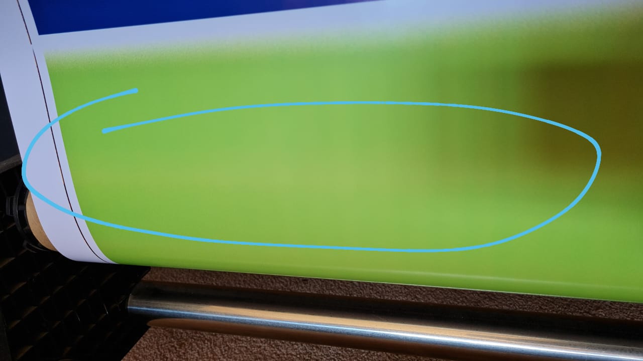

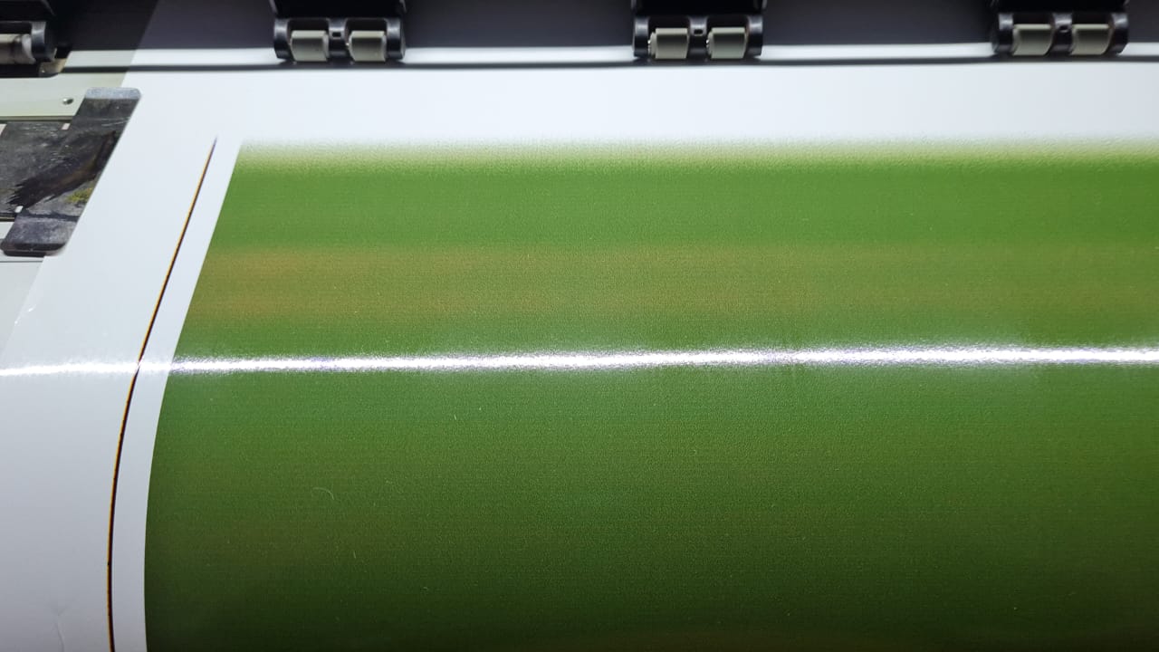

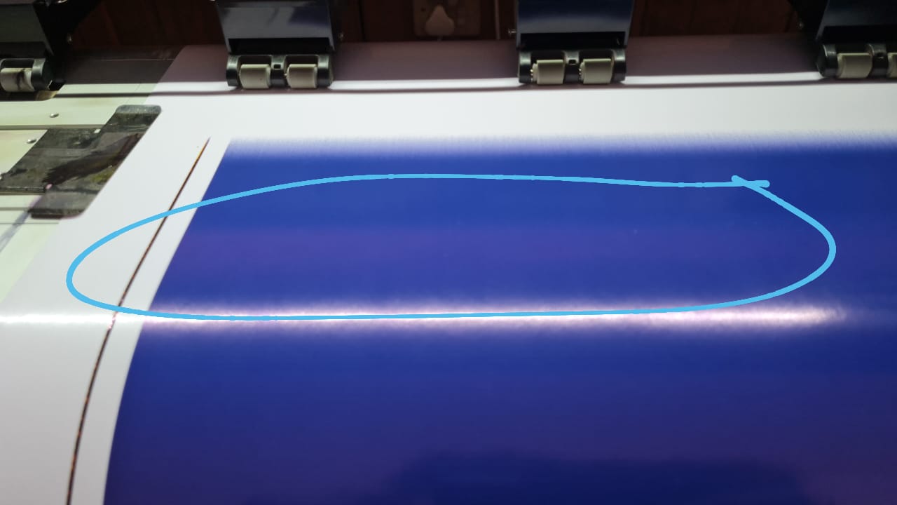

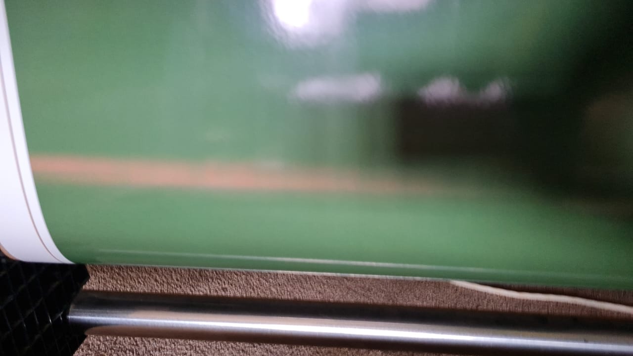

Hi Guys i need help have a chinese printer dx8 printhead getting colour loss on the far side of the prints the print/nozzle tests are perfect
i changed the dampers reinstalled software the printer is on a ups and changed the capping station aswell and everytime same problem it prints for about 500mm to 1m then starts

Ink starvation. Try slowing the head down. Or run it uni directional.
What dampers are you using? Is there enough room between dampers for them to pulsate and draw in ink without pushing on the opposite damper?

HI Mike yes there is more than enough space between the dampers its a Chinese printer unfortunately and all those prints were prints slow an uni directional

Looks like it's only happening on one side. I've run into this before with a DX5 head and it ended up being a partially clogged manifold. I flushed it and everything started working properly. It could be a bad damper as well.

It looks like ink starvation somewhere in the system. You will have to check everything from the cartridges to the capping station.
Are the dampers full when a print is started? If its happening anywhere from 2 to 3 feet into a print that would say to me that the damper is not drawing ink into it.
Does your printer use ink pumps to push ink to the dampers, or use siphoning to bring ink to the dampers?

it doesnt have ink pumps changed the capping station aswell and i changed the dampers iwas thinking of moving the bottles up or a bit higher so it sits higher to the printhead

It's ink flow in my opinion. If it's not a damper issue, it's probably air getting in somewhere along the line. Any air in the lines?
