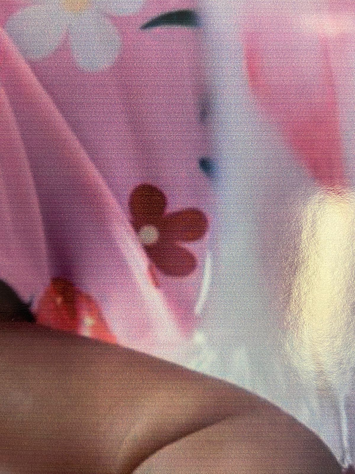

Hey Guys,
Ive been struggling to clear all my nozzles for about a week and all my prints have this banding on. My capping station and wiper is new-ish, replaced that about 4 months ago. My print head is not new, replaced that in 2019. I soak in solvent overnight every night, and do a nozzle was first thing in the morning every day for 10min before I print anything. Ive done countless hard and soft nozzle wash, and sometimes the test print comes almost perfect, but it keeps printing bands, but for the last two days I cant get it clear at all. Prints look terrible. please help!!

Make sure you have the latest firmware. Try increasing the passes to see if there is any improvement.
