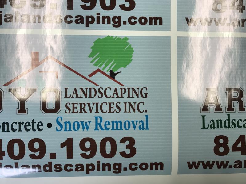

I would want to know if i can have some help with this issue.
I have a 1304 Mutoh VJ.
When i print on gloss oracal vinyl I get this banding on my prints (see attached picture please)
I am thinking it is the profile I am using.
Any suggestion on a profile that i can use?
When I print on banner with the same profile won't have this issue.
Thanks in adavance for your help.

profiles are specific to media and ideally you have a profile for each type of media you print on. You can go to Orajet's website and find something for your workflow for starters.

Do you know by chance any specific one for this oracal glossy vinyl?
Pete Moss
Take a look at the link oksigns left you for the profile. Plus you didn't call out the vinyl type other than glossy oracal.
NINOLEO
Not sure about the type of the vinyl. Do you know what the letter at the end of the profile number means?
floater302
Need more info too. like if your running 720 and what pattern you using fine and fuzz or wave ect, could be dampers and if your running bulk ink system ink is under half full, so more info needed.
