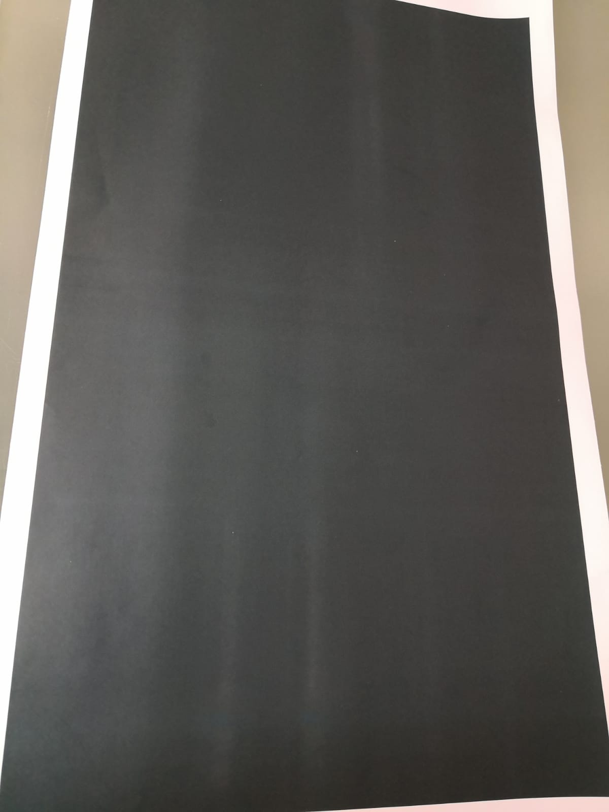

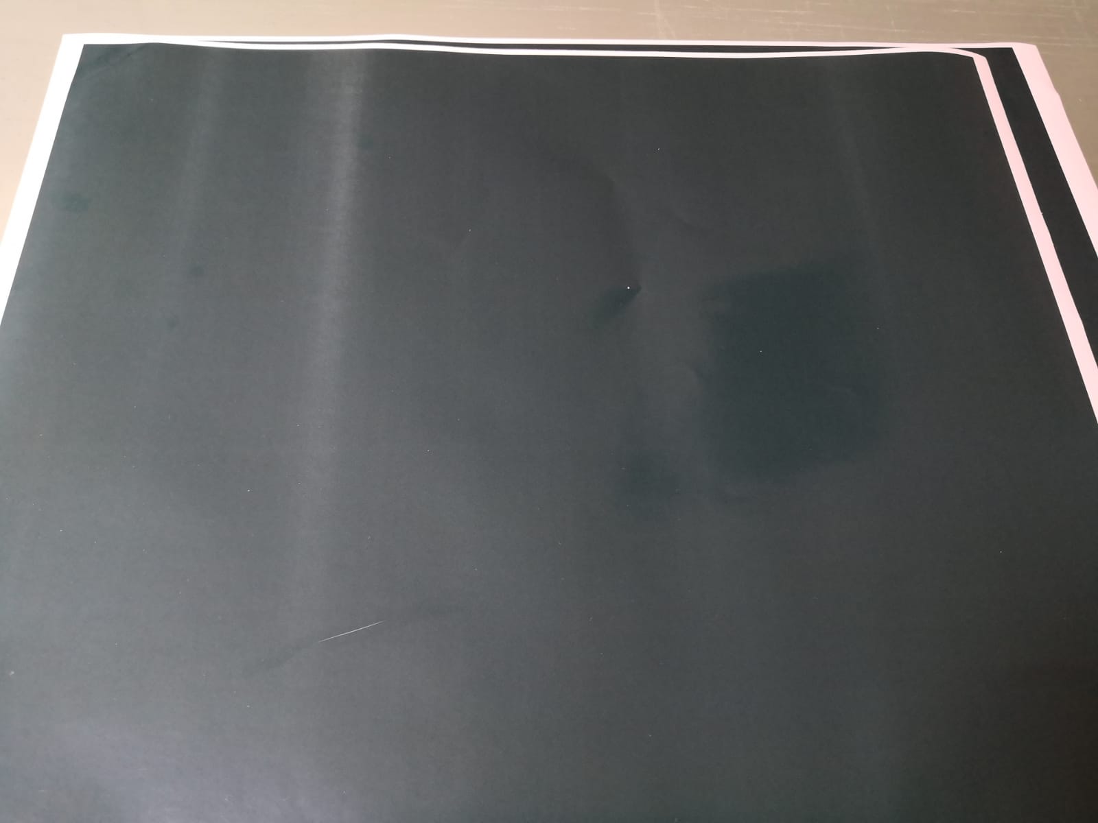

Hi, can anyone help me with my problem ? I think my mutoh lost colours and it's more visible when printing one single/full colour. Thks.

Post a nozzle check. Also, off the bat it looks like your feed encoder might be dirty or damaged. I usually clean the encoder disc with 70% alcohol and a lint free rag. It's located behind the left cover from the front of the machine.
GetTarps
I've tried everything. Encoder is very clean but same result. Idprintprod..share.if you find a fix, can you share the solution?
bug
hi, i print with fine and fog, if i need i put slower head movement, usually its enough just fine and fog wave pattern
