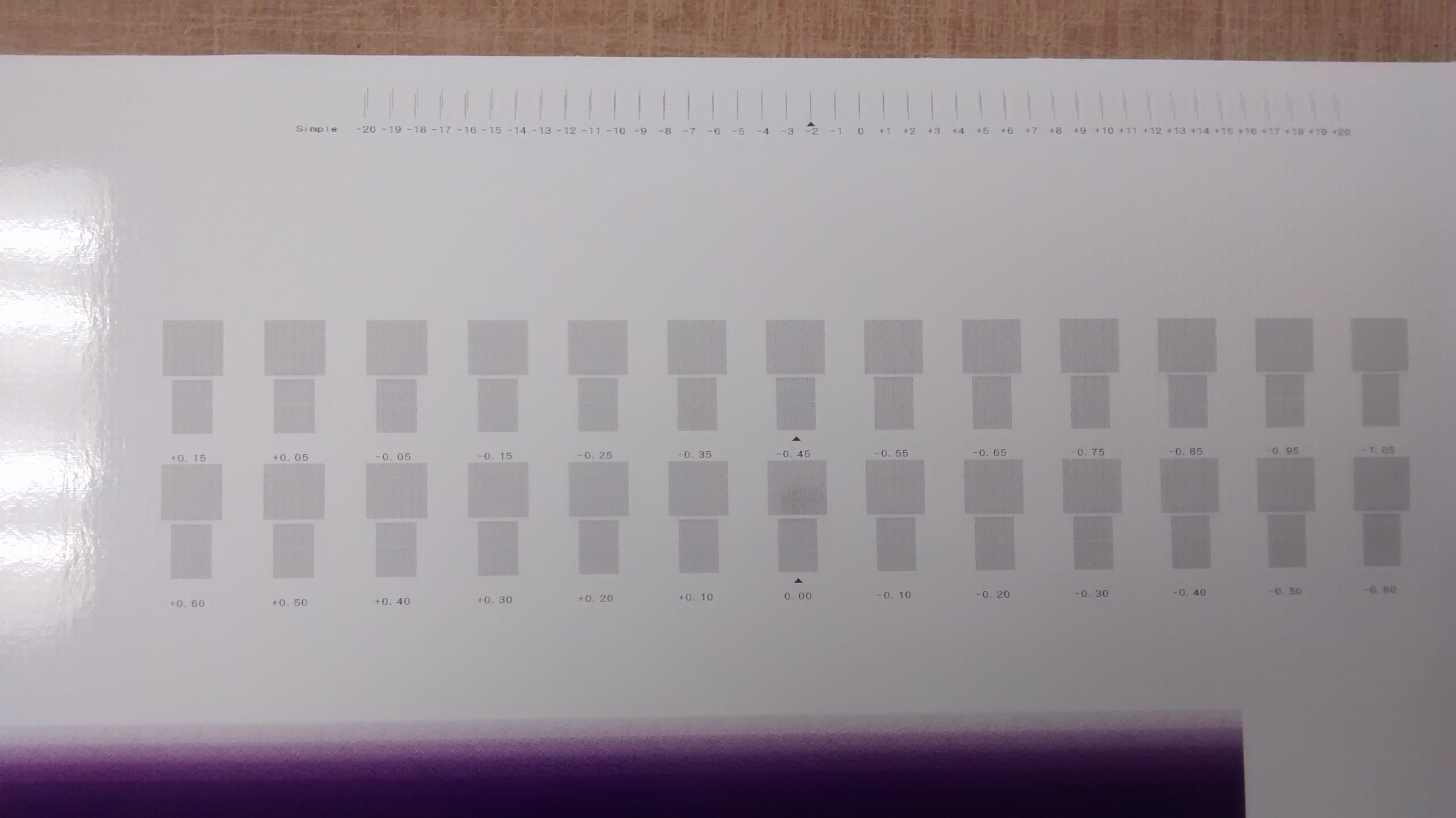

I have a Roland VS640 printer and having problem with banding only on dark colors, mainly blues & purples.
I did a feed calibration test and it appears to be way off. I've tried adjusting it, but doesn't seem to make much difference. Attached is a picture of the test print. Any advise would be appreciated.

graphix45
I've done all three cleaning levels several times and I do a manual cleaning every 10 days or so. Is there something else I need to do?
graphix45
I also get some light streaks occasionally that looks like what I've seen described as ink starvation. Don't know if this could be related or a separate issue.
Juney
I have had this issue. This is not recommended, but I soak a swab with ink solvent cleaner. I gently press the soaked swab on the screen of the head. Gently wipe the head. wait 5 minutes and repeat two or three times. Then do a power cleaning through the control panel. Good luck...Be very gentle!
