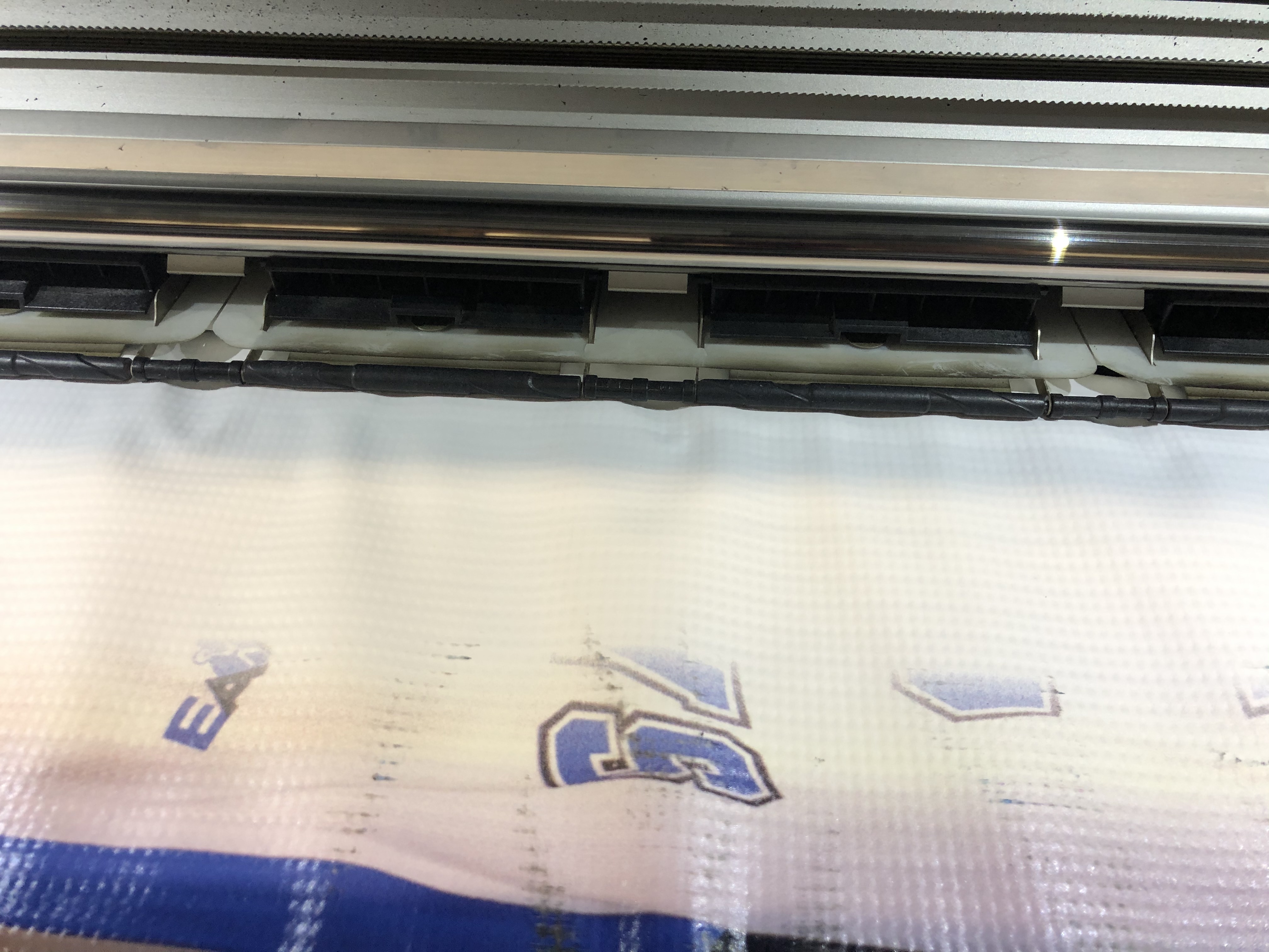

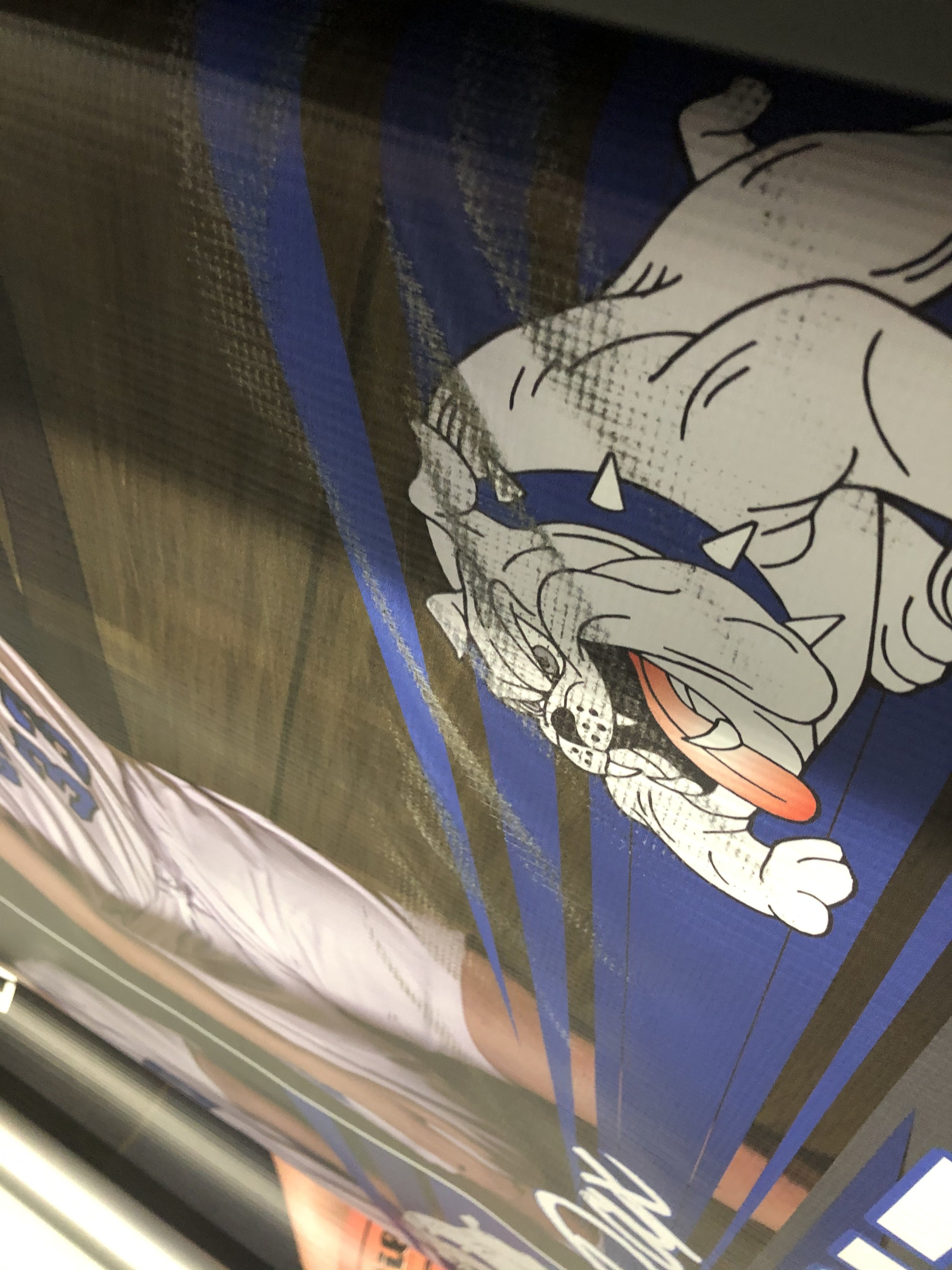

Please help! HP Latex 360 - This only happens on my 3' banner material. 13oz banner bunches causing headstrikes. I've decreased the temperature, increased the passes. Still does it.

We've done both forward and reverse. Nothing stuck. All other sizes of banner print just fine. It is just the 38" roll. I can't even get thru a 10' banner. Right now we are using Duratex from Grimco, but have used their previous brand of banner and it did the same thing. Seems like my setting adjustments are making it worse.

We've had similar issues with the new Duratex 5ft. We still have rolls of 3ft Briteline we're dreading using up. Grimco has told me they've released new profiles for the machine, so check the website or call in to get those.

I did increase the vacuum pressure and I decreased the heat. Even downloaded the print profile from Grimco's website. Same thing. Something is wrong with the way it's pulling it. But at this point, I'm convinced it's the actual banner material. My rep said he would credit me for the roll but I need a solution. I think I will try another brand and that will be the real test.

Yes - it's typically only the 3ft roll. Other rolls do it occasionally, but I can always count on the 3ft. New roll or old roll. Doesn't matter.
CMI Signs
It's just strange because my 24", 54" and 63" banners all work just fine. Only occasional problems. I may need to just upgrade my 36" banner to avoid this. It's just frustrating.

Is it sticking in the curling area? If so have you tried to use the curing platen covers that come with the printer?

i would definitely recommend using the platen protectors. i also found my pvc (i think was an avery product) stuck more as it got older. fresh stock, and protectors on, and it works great, i even did some double sided work recently without issue.

It's possible your platens need to be cleaned. Because the printer always prints from the right side these tiny holes tend to gunk up first.You'll have to remove the platens and punch through all the tiny little holes. It's tedious but necessary. Just as my first time you'll be amazed at how much this makes a difference
