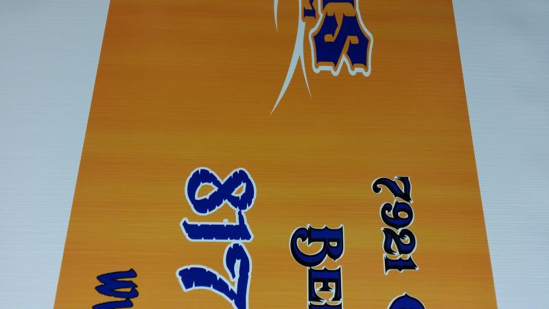

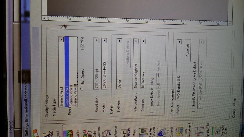

I have a Roland versacamm sp300, when i print this banner there are like some banding or lighter color lines that run thru the banner, how can i fix this 20141008_204143.jpg

Could be as simple as a bad roll of material. We print banners at high speed setting with our Roland with no issues. Could be a corrupt file too.
If you want to make sure you're getting enough ink you'll have to get into Service Mode and do a Fill Test.
