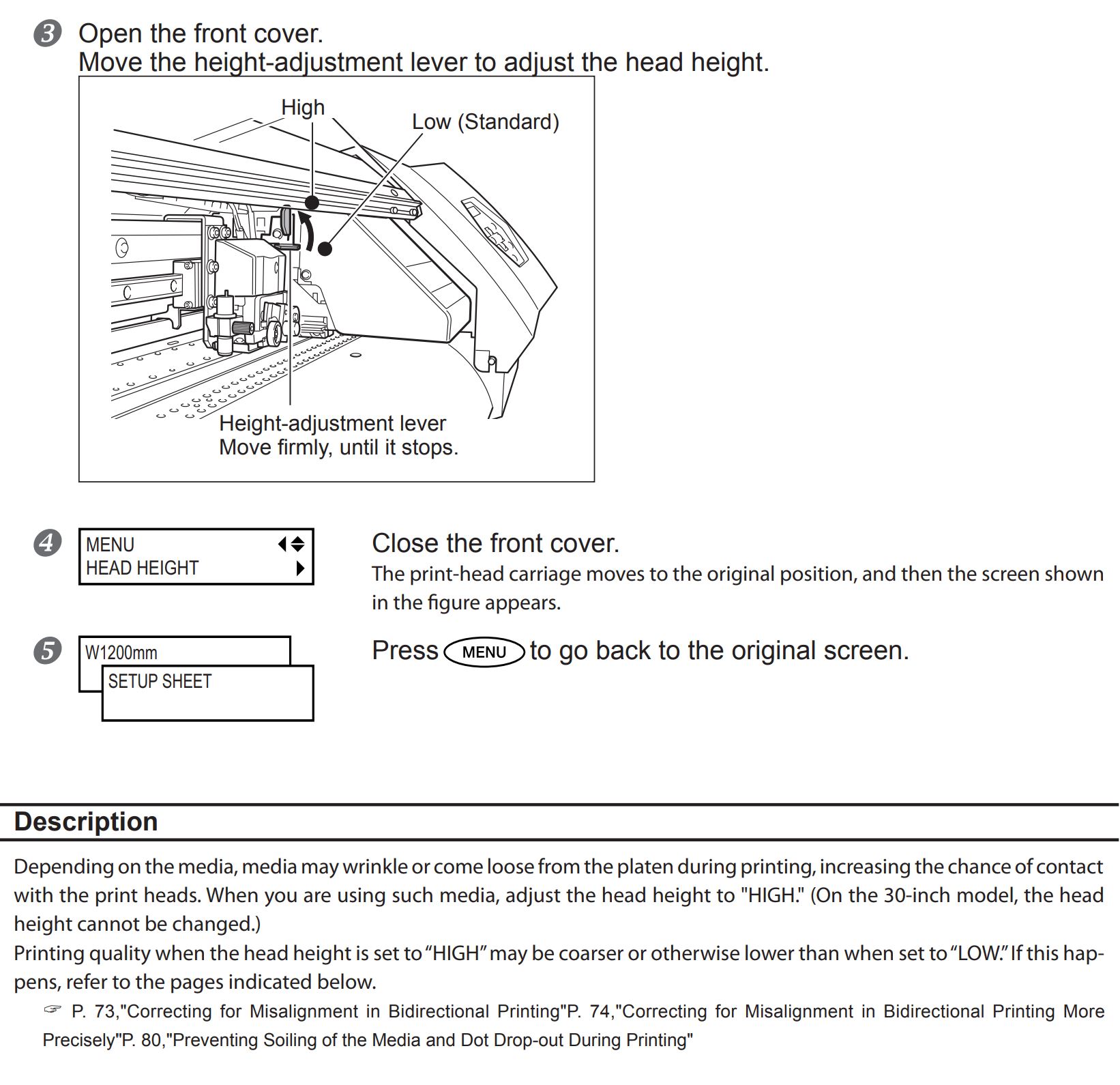

i have a sp540v, i believe yours is the same as mine. when it comes to damaging the head, as long as you don't see it
smearing the print, then the head is not hitting the media and you'll be fine. But you will see a quality difference in raising
or lowing the head on certain thickness of materials. It's a lever inside the printer. When in front of the print, open the clear
front cover (do this as the printer is off) and look over to where the print head is at. Next to it, you see a lever with a white
handle. You either lift the lever up or down. HOLD all this. I just checked and the 30" doesn't have a height adjustment.
Read the doc I'm sending you.

Most Roland printers have a small lever on the side of the print carriage
move it up to rase the print hight
then go into main menu, scroll to head hight, push enter

Thank you! It is a 13 oz double sided banner. Anything I have read the 30” has no way to change the head height. Which is weird. Yes it has printed fine in the past. I guess I’ll just keep an eye on it. Just being extra cautious with the new head!
