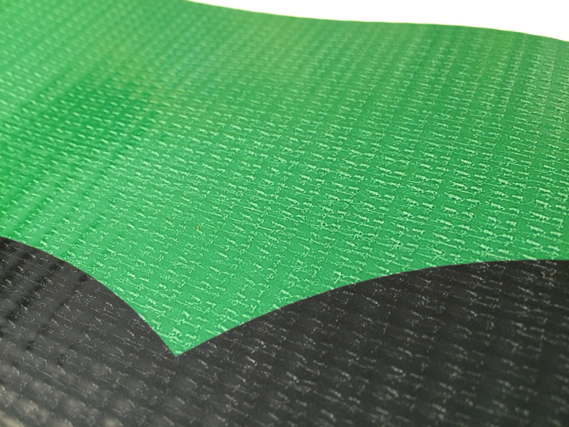

After 3 years, I have yet to get consistant results with our profile setting for Ultraflex/Jetflex banner on our L25500 at 10 pass.
I may have tweaked the out of the box settings at one point, but media settings are as follows:
Curing: 100 C
Drying: 55 C
Vacuum: 5
As you can see i the attached, the coverage is pretty shotty. I am not sure if this is a temperature thing, a bad media thing, or what.

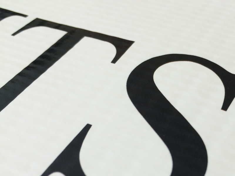

Then, in the out of focus second picture, you can see the black coverage is perfect.
Any hints on how to get this thing working correctly?

On your pictures, it looks like you can see the scrim through you print on the first one. The second one, might be a drying/curing issue. I would check the temps of the curing and drying elements to make sure they are what you have programed them to. We run 110 /50C @ 10 pass. Have also had curing and drying elements replaced.

Yes, you can see the scrim through the ink. Happens very intermittently, varies by location and color. But not like there is a spot of residue. In that first photograph, those poor results were consistent throughout that green color block on the banner. But elsewhere, coverage was fine.

However, afterward the first successes, nothing but trouble with the next rolls of it. I had a roll that was printing similar to what you have shown in your first photo and called Grimco, they were aware of the problem because others called to complain. So, nothing consistent enough to make me want to stick to any of the above mentioned.
