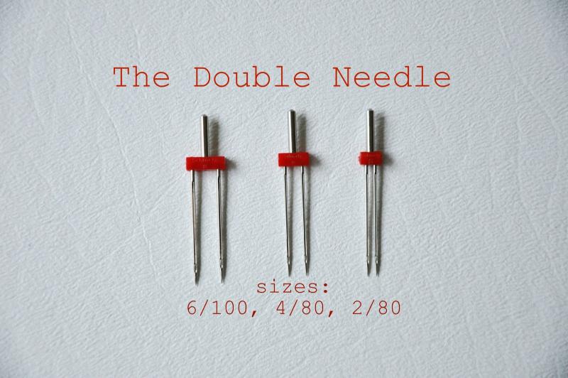

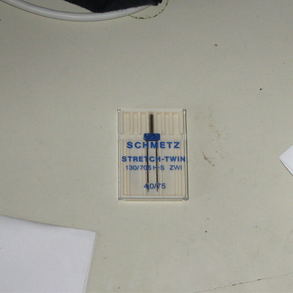

I said nothing about converting anything. I was talking about these babies here. You can use these on single needle machines. You don't have to get a two needle bar machine.

WildWestDesigns
I knew I had one somewhere around the place.
As you can tell, they are technically called "Twin Needles". The only difference between using this on a single needle and a true dual needle is the bobbin thread. The bobbin will alternate between the two needles using this method. Otherwise, it's the same as far as output.

That's crazy! No other modification needed to the machine? How strong is the stitching compared to a true 2-needle?
The top stitching itself isn't any different, the support of the bobbin thread is where the difference is. I haven't had a failure using this, seem to hold up very well in my experience.

I cannot speak for the Juki, but we have always just run Pfaffs and Brothers and haven't had an issue with our machines running these right out of the box.
