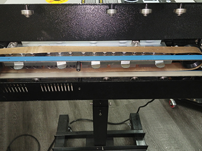

1-the copper and blue pulleys aren't staying even with each other..the top blue and copper pulleys go off track and don't line up correctly

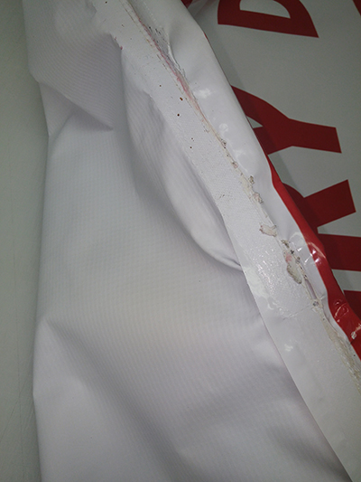

2-the banner material will get eaten up by the heat of the roller but only in some spots not through the entire weld
3- (MOST RECENTLY) the banner will get scrunched up at the beginning of the weld run and start bunching up the whole banner with ripples that have to be straightened out by hand (while trying to weld the banner at the same time)

My guess is the tension on your copper pulleys is too loose causing it to shift. There's a screw that adjusts that. Also try changing the pressure on your heating and cooling elements.

thanks! gonna try to tighten the pulleys now. Do you know how to adjust the heating/cooling elements? or a link?

At the top in the middle of the elements there is a grub screw with a metal lever on it. Spin the lever clockwise to lower pressure and counter-clockwise to increase it. You may have to adjust the nut that sits where the grub screw goes into the elements. I had to play with ours quite a bit to get it working properly.

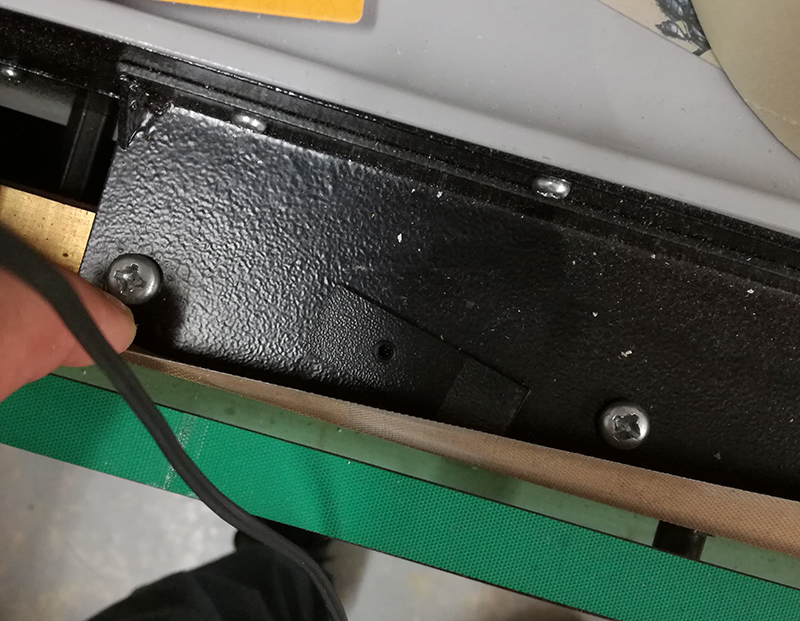

The welding belt is held in place by spring tension. I have replaced belts and used the adjustment screws according to the manual, however the belts, both welding and drive, continue to come off of the rollers resulting in bad welds and damage to the banners. We weld and sell many blank banners, about 100 in three days, in addition to printed custom banners, I don't think this machine is up to that kind of volume.
Does anyone know what the recommended tension is on the belts? I have adjusted both the drive and welding belts numerous times along with the tension on the heating plates and RS does not seem to be of any help. We had a tech at the shop a few months ago due to the fact the machine would overheat and simply stop when doing a volume of 4x8 banners. He replaced a lot of parts and now we have this problem.
