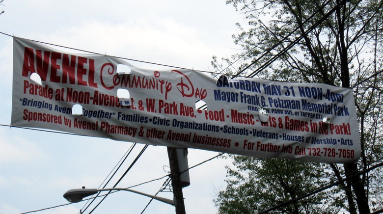

I am printing 7 banners 3'x15' and the customer wants wind slits put in. How many and what size would you suggest? If memory serves, you use a paint can to make half moon slits. is this the best way? Any advice appreciated. I've never done this before.
J Hill Designs
just dont do em this way :thumb:
bob
If you simply must have wind slits instead of those idiotic half circles, Why not punch a series of two small [1/8"-1/4"] holes about 6-8 inches apart then connect each pair with actual slits. These should spill just as much air as those half-circle monstrosities and are relatively unnoticeable.
The punched holes are the rip stop mechanism.
