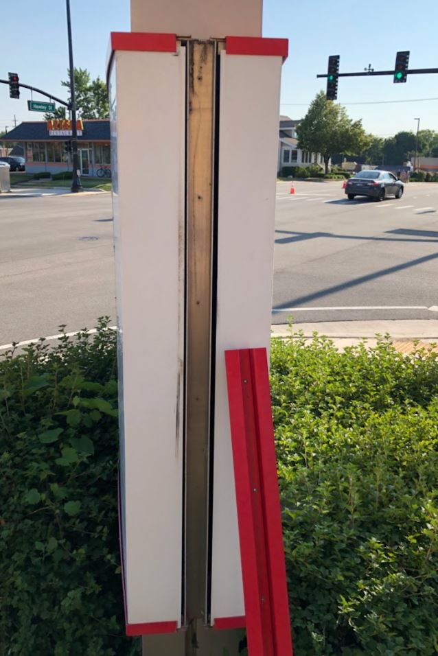

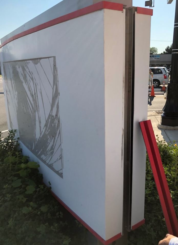

I bought White Polycarbonate. I thought I would just be able to place vinyl on it and install the face. It turns out that the sign as 90 degrees bend style monument sign.
How do I get translucent substrate with the 90 degree angle on right and left side?

What is pictured is aluminum panel that placed when the old sign was removed. I need to put in polycarbonate but saw the angle and wondered how that would be installed. Would two pieces of poly and glueing be the best option? I called Wensco, where I bought the polycarbonate and they state the material can be thermoformed which I am researching that now. Heating the polycarbonate and bending to 90 degrees.

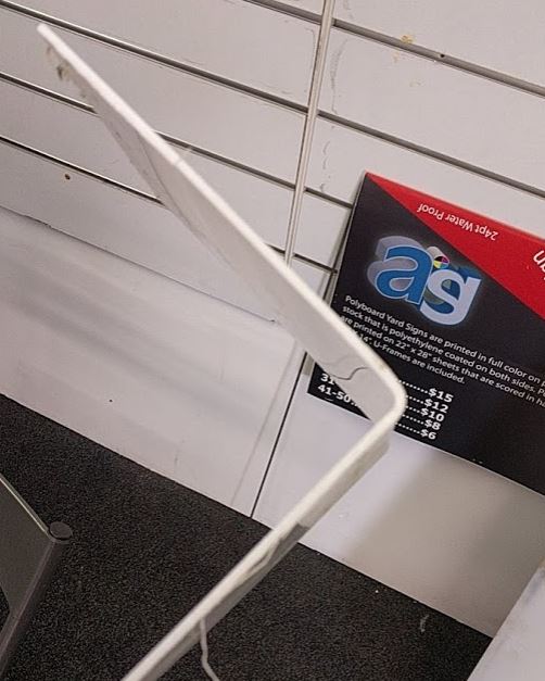

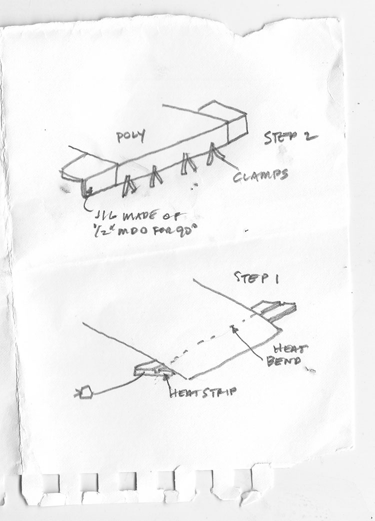

Acrylic and polycarbonate will bend very differently. Good luck getting a straight bend on something that wide in polycarb without a heat strip.
Johnny Best
Agree, you need a heat strip with nighrome wire in a channel and polycarb heated to 300 degrees evenly.
If you have any cold spots it will not bend evenly. You need to job it out to a professional to get that long bend.
No way a heat gun will do a nice job on a long bend, thats bad advice and could be costly to try.
