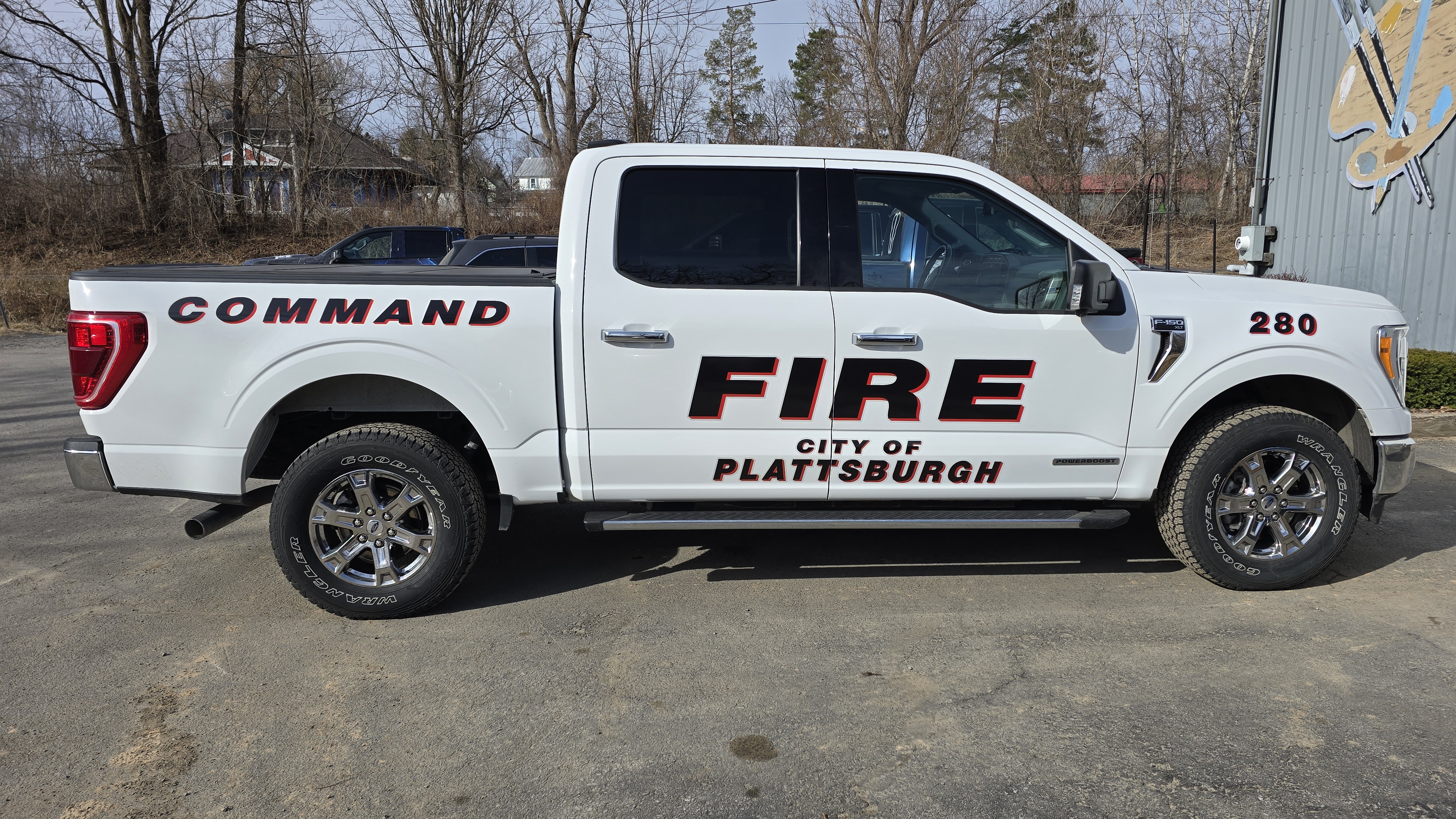

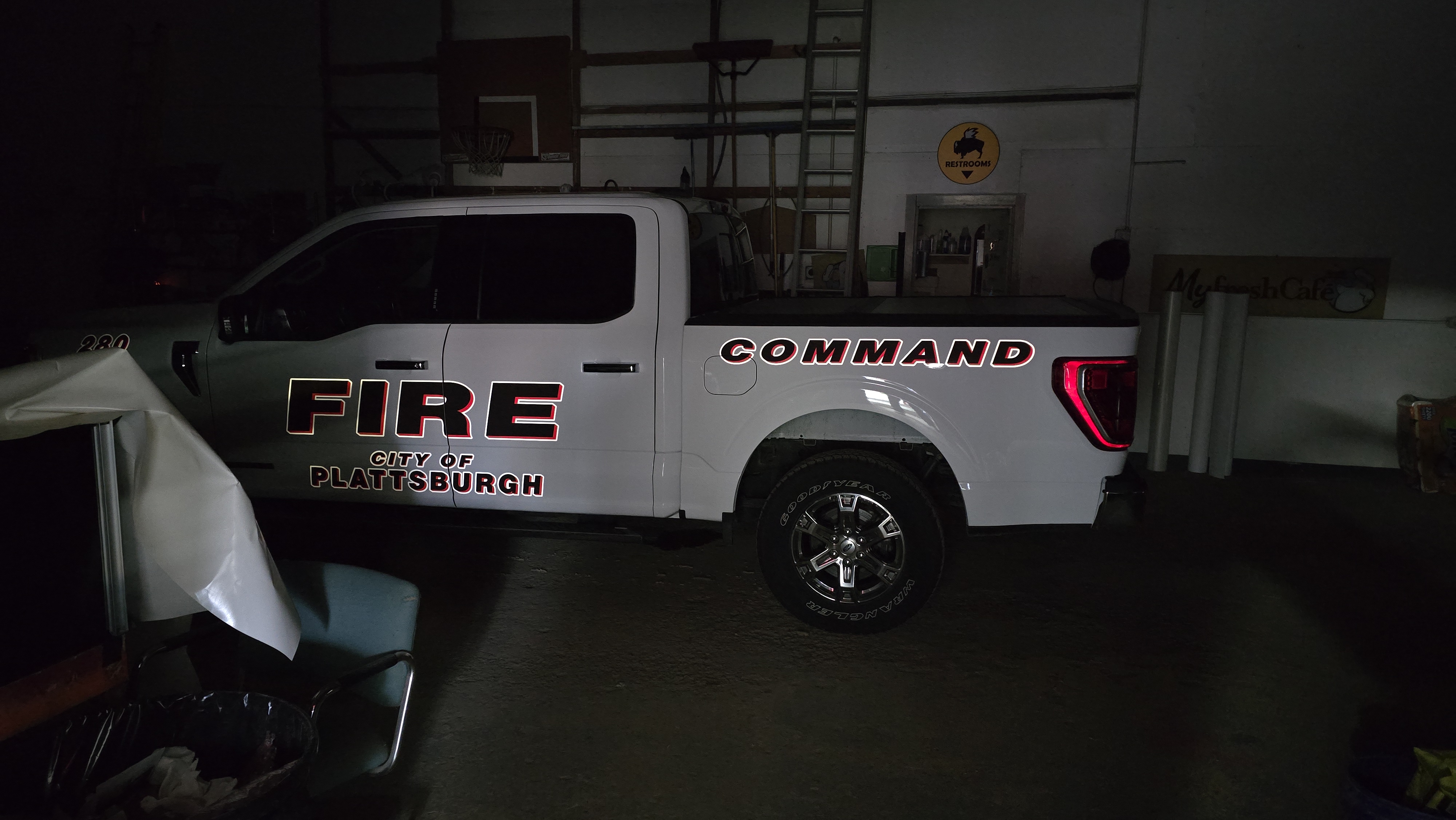

We've had really good luck printing on Arlon DPF 2400GLX and Oracal 5650 RA. We just recently switched to Oracal because it comes in 54". Printed on a VG3 using Roland colors. You do lose some reflectiveness in the dark colors though.
Thats a nice black.
