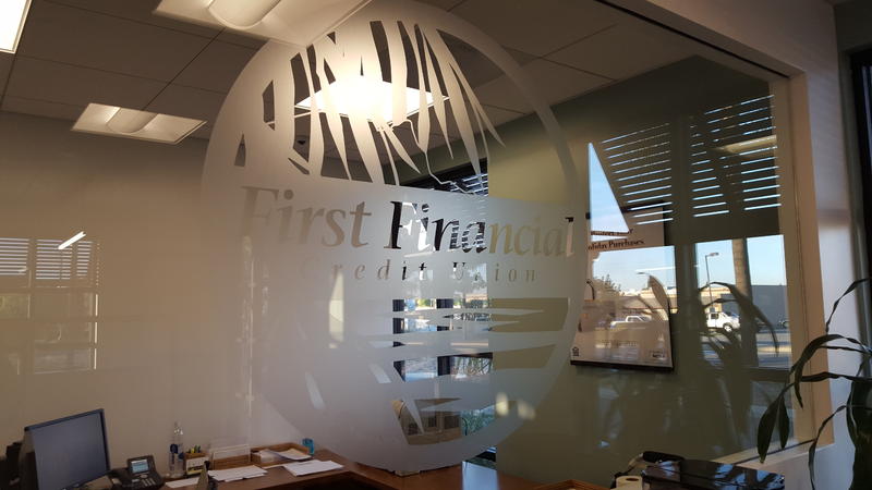

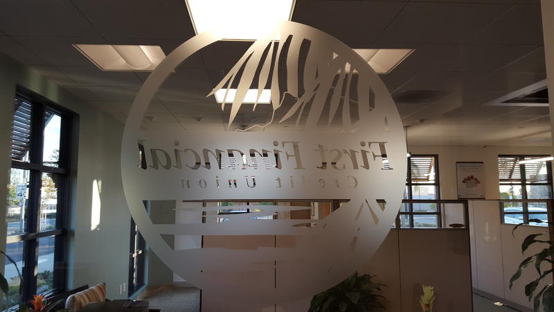

We used to use the 3M Dusted Crystal but we were also having problems with it. We recently started using HEXIS etched glass (E3GIVM) we have had great results wet mounting so far & it's much cheaper than 3M. Sample pic attached of one we did a couple of days ago.
