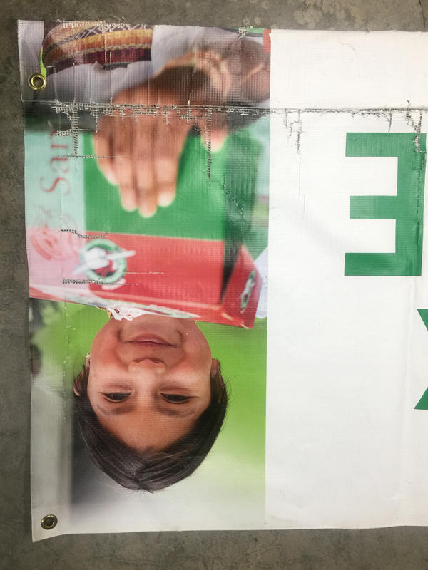

dypinc
So your telling me that applying a liquid over-lam is going to prevent this kind of damage?
