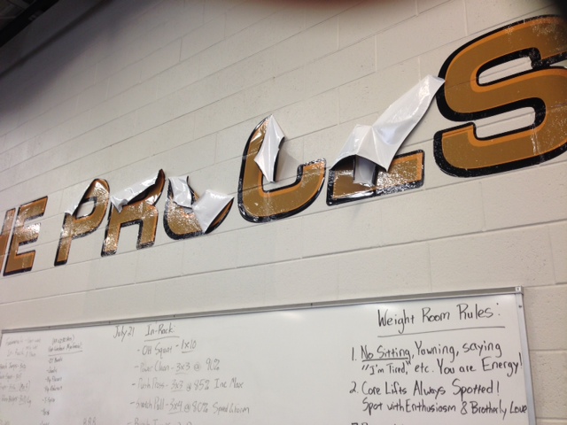

Just as an FYI. We did some wall graphics with DPF8000 yesterday and they are coming off. I called their tech support and they said that it may not be compatible with certain paints. The gym wall we applied it to was painted. I have the same material from the same roll installed on a rough wall (painted) at our shop and it sticks perfectly.
Arlon recommends testing beforehand.
We are stumped and trying to figure out another option.

Really?! What kind of paint is it not compatible with? Was this wall recently painted? Maybe it wasn't fully cured yetl? I've used Arlon DPF8000 for years and never had an issue.

Evidently certain paints with primer built in and anti graffiti paints can cause an issue. I just went and inspected it and half of it has fallen off. I have never had an issue with PF8000 until this. The solution recommended is to clearcoat the area to be used with Krylon clear and redo after about a week.

As mentioned I use DPF8000 all the time and never had an issue but this is what happened within 24 hrs. These were printed on a JV33, out gassed 2 days before lam. Applied with a rollepro and heat just like always.

The wall was painted with a "LOW VOC" paint. You have to literally... literally SCRUB it with alch. like 5 times over and over. Even then you might have some failure. But it will help build adhesion.
I was at 3M last month and this is a big problem they're having with wall graphics. all these companies are adding things to paint so everything wipes off. That also means adhesion is killed with all vinyl.
You have to explain this to your customer before every wall graphic job.

I was told applying krylon clear over the applicable area and leaving it for a week before re-applying would work. We are going to test it.

They are putting teflon, and silicon in some paints to make them more stain resistant. Which also makes them resist everything else too. I've got a piece painted with the stain resistant paint, and a piece of phototex on it, been there for a couple months, doesn't show any sign of coming off.
