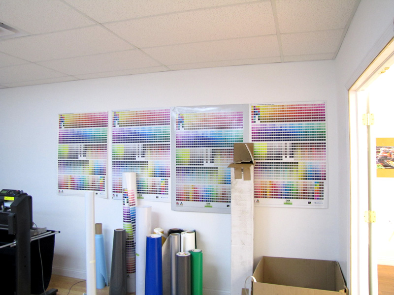

Seriously though, print out a Pantone chart on your printer (to show CMYK conversion) and you should be able to find the orange you're looking for. This also helps tremendously when a client comes in and has their logo/artwork in spot colors; you can show them ahead of time how their color will print off of your printer & if any tweaks need to be done.
We currently have 4 charts to show / hand out (L-R gloss banner, standard print vinyl, printable reflective, wrap vinyl). Every new roll of vinyl you get make a habit of using the first (usually junk) portion of the roll to print a chart on instead of just wasting it. ;)
