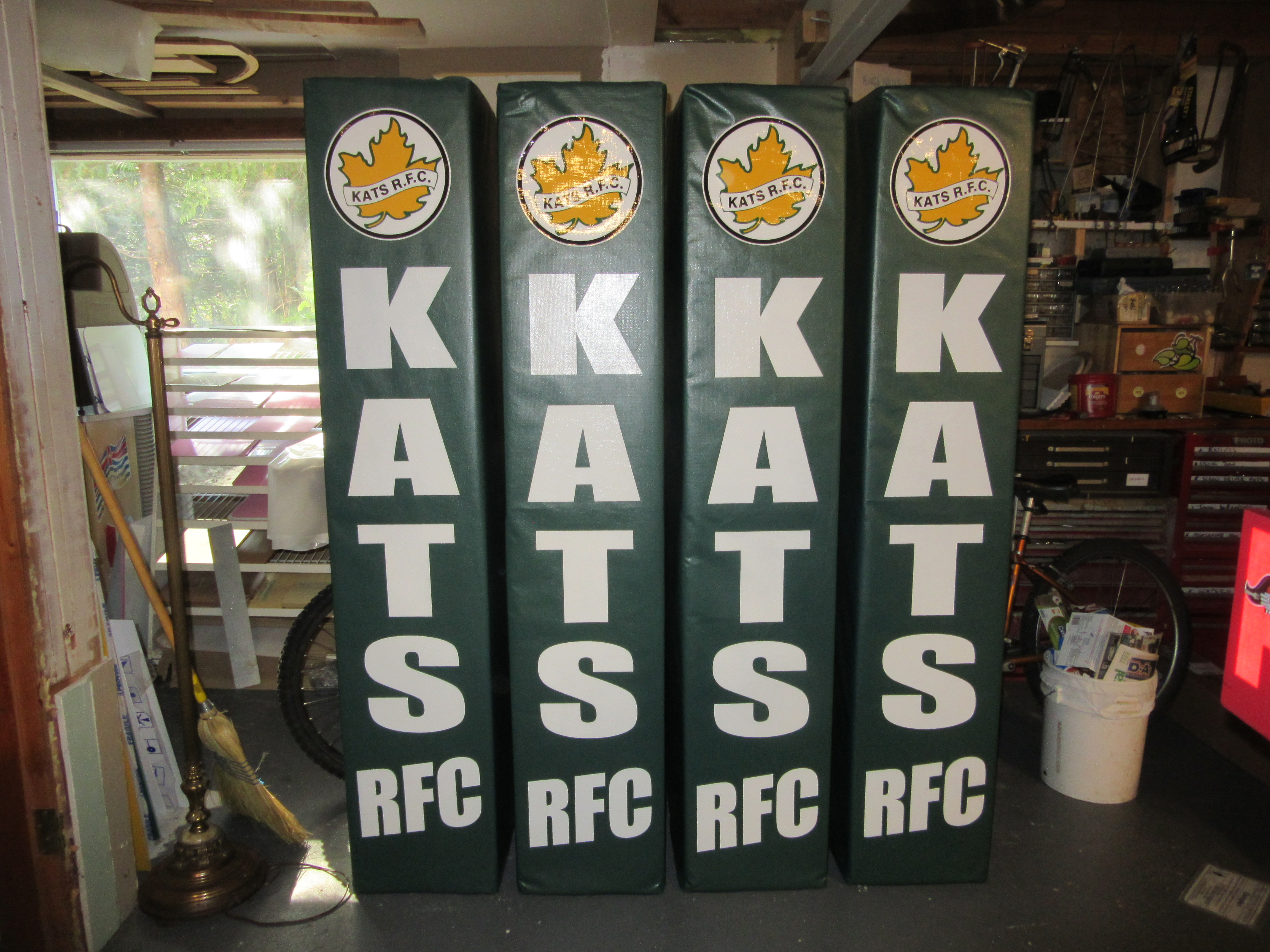

I lettered these post covers a couple seasons ago and they seem to be holding up fine. I used paint mask for the letters and sprayed them with Krylon Fusion rattle can paint. The logos are Avery 900 series printed and laminated. IMG_7301.JPG

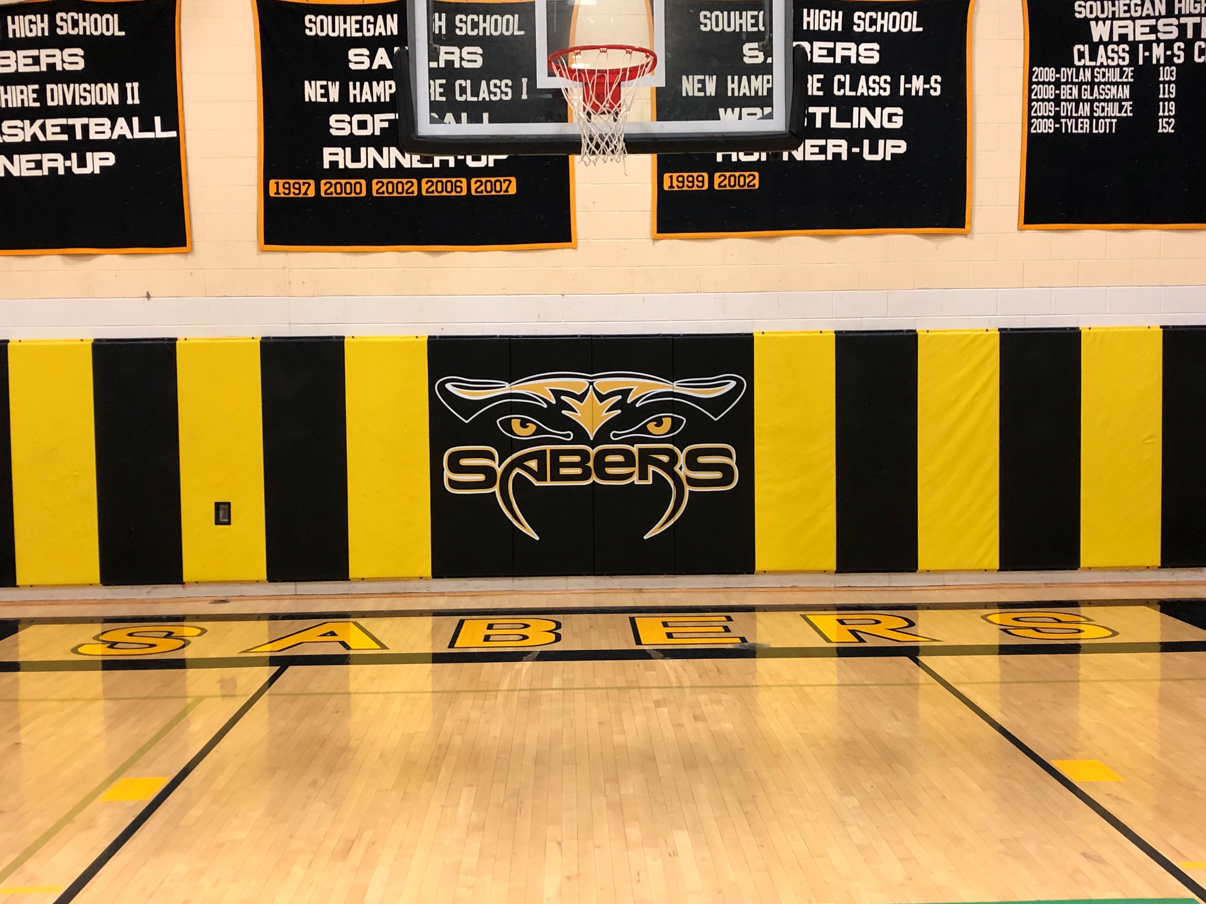

We recently did some graphics on gym pads at a high school nearby. Instead of applying vinyl, we actually replaced the four center pads with new printed ones. (was good since there were tears in the old pads anyway) They ran about the same cost it would've cost us to print, laminate and install, and turned out great! Cost was $172/ea and we purchased through AK Athletics. They were very responsive and had fast service!
