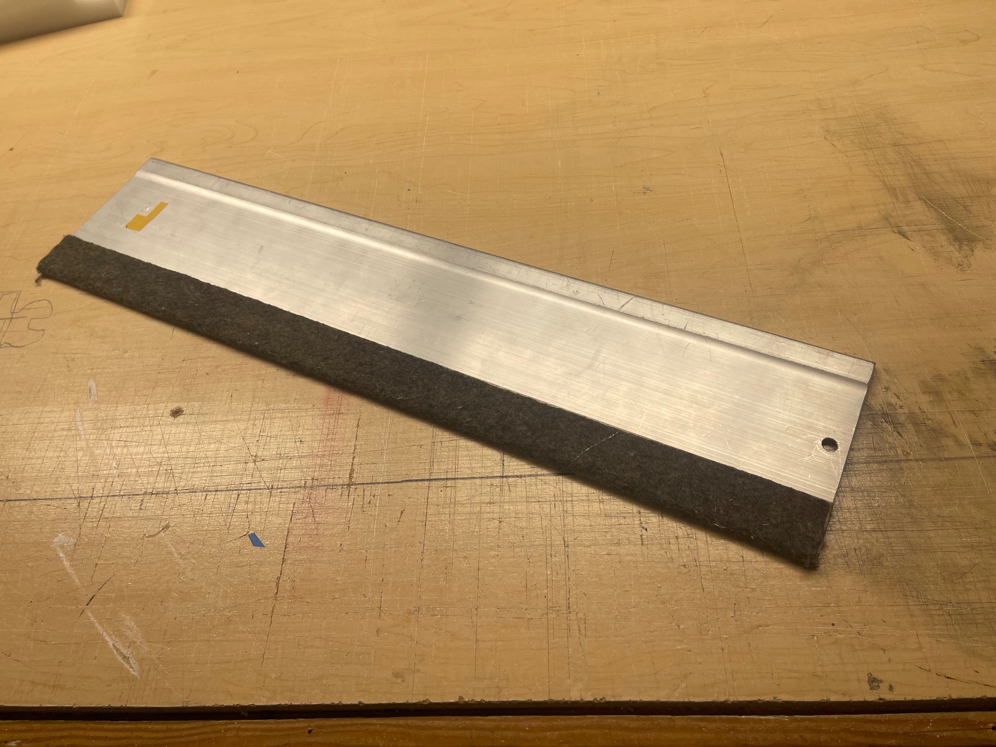

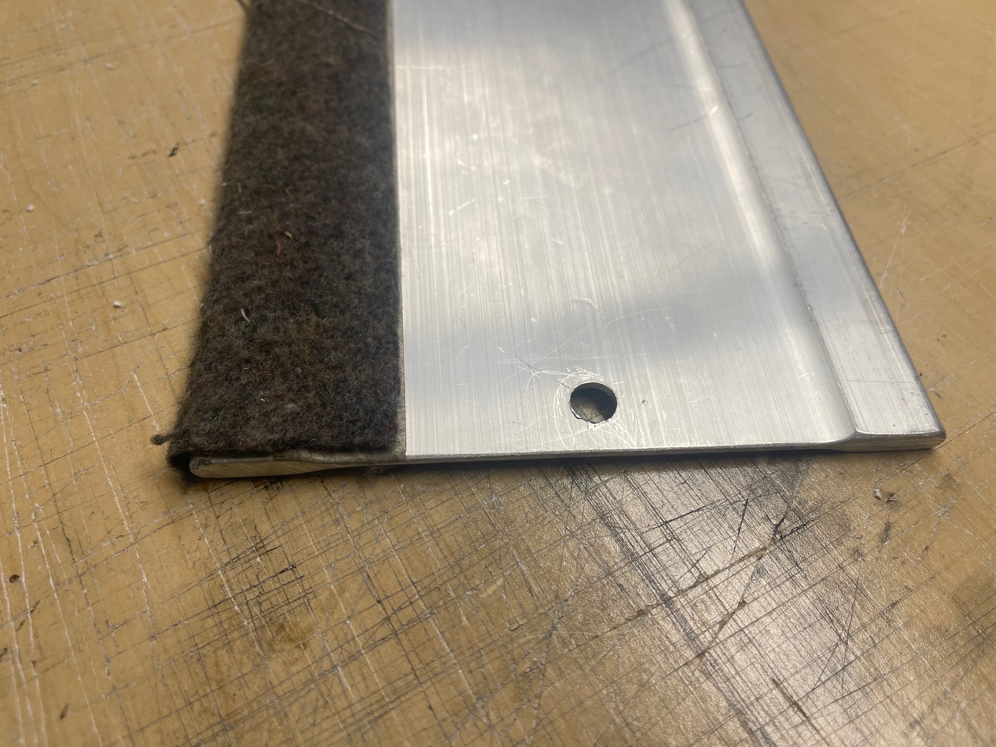

sardocs
I make my own version of a big squeegie from the aluminum extrusion we get for making road signs. I glue some soft material to the edge. It works amazingly well for large graphics.

d fleming
I've got an old 26" big squeegee that kills wall murals in a quickie. Have even used a 54 here and there. After that initial app I go with 12 and 6" wrapping squeegees.
That looks like it works great. If I had some of that laying around I would definitely make my own.
sardocs
I think we get it from Grimco. I cut a 4' piece into a hand full of smaller sizes. To hold the feltish material I used banner tape on some and 3m spray adhesive on others.
