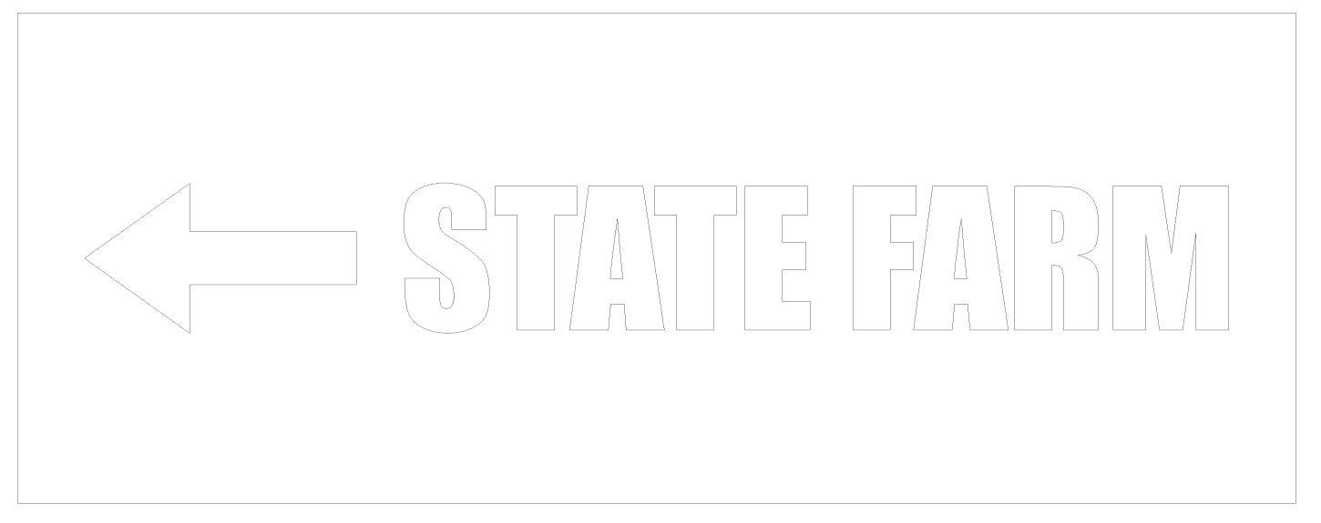

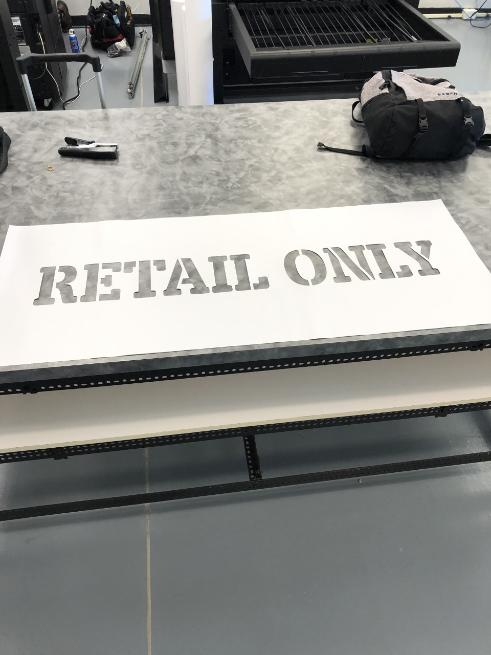

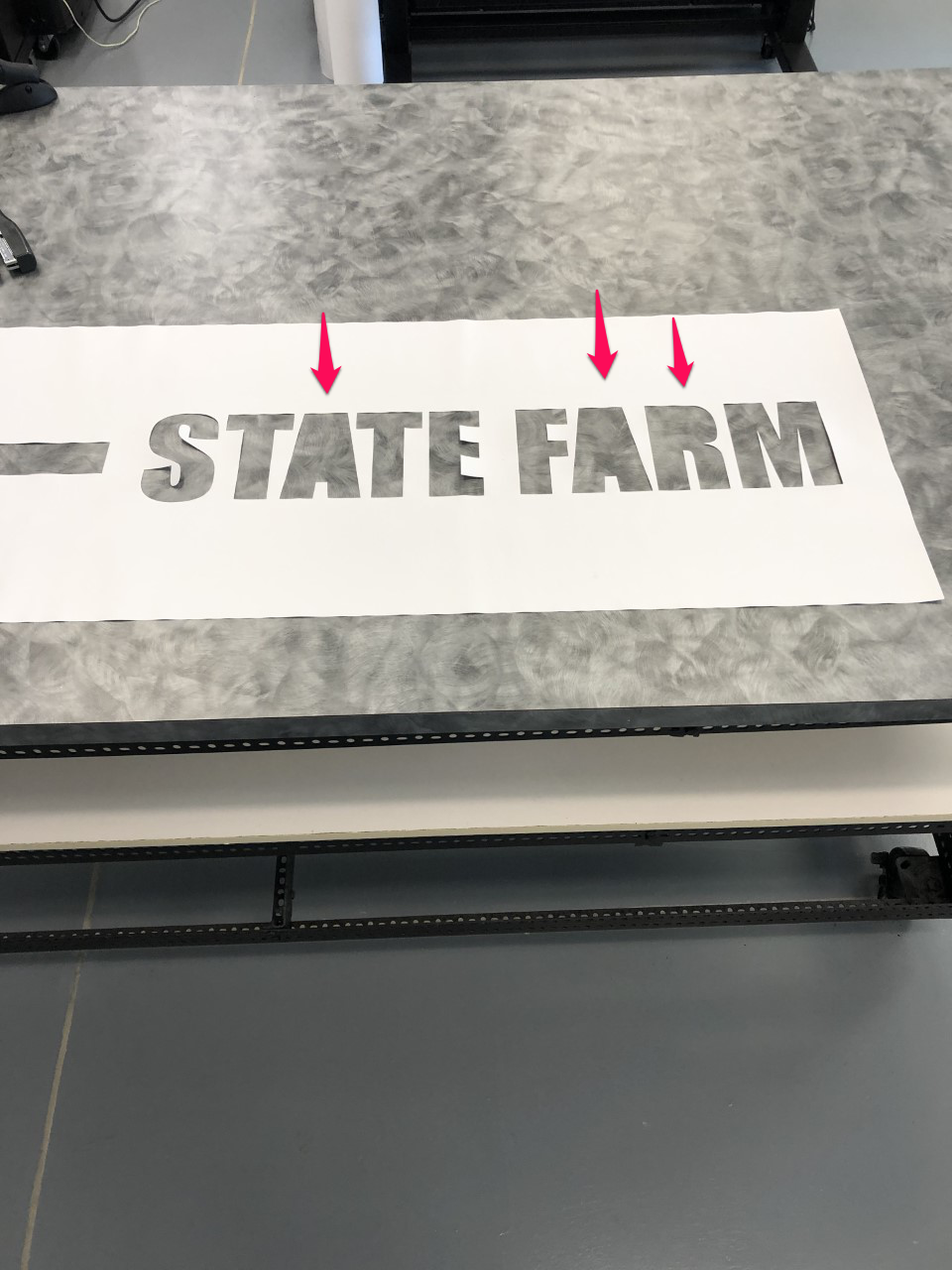

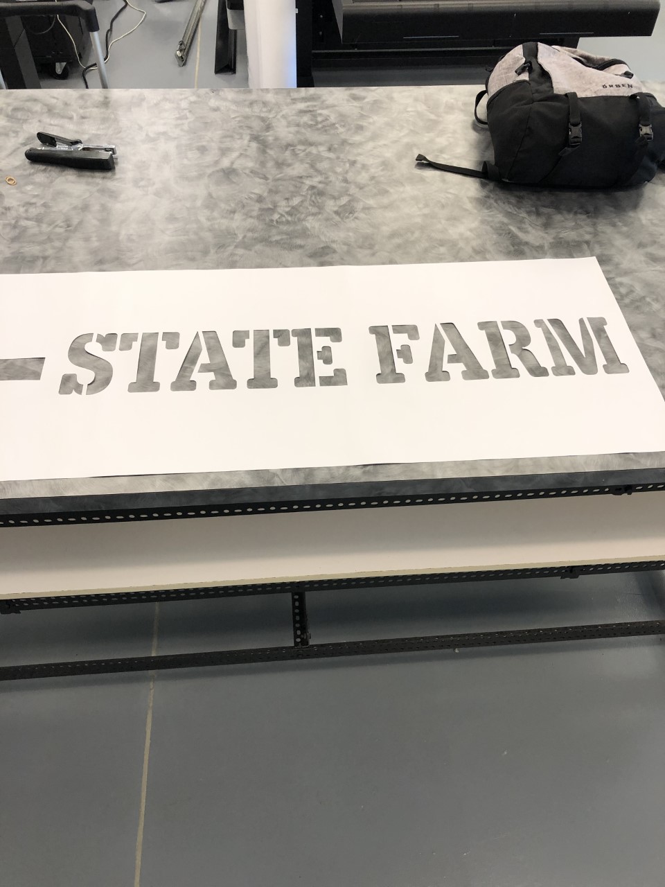

What is the best font to use when creating a temple? My customer will need a few hundred templates to use for painting words on parking space walls in a multi-level garage. I was going to print on Avery DPF adhesive vinyl so they can stick on the wall, rattle-can spray paint, then come back later in the day and peel off. I need a font where the letters are either connected together or when they are cut out, don't lose any of the font. See the pics below.

Not sure I follow, if you're cutting a 1 time use decal (paintmask) then the font doesn't matter a bit. If, however, they want a true stencil then, yes, you have to use a stencil font.

Most fonts will cut out the inner portion of some letters like A, O. P, R, etc.

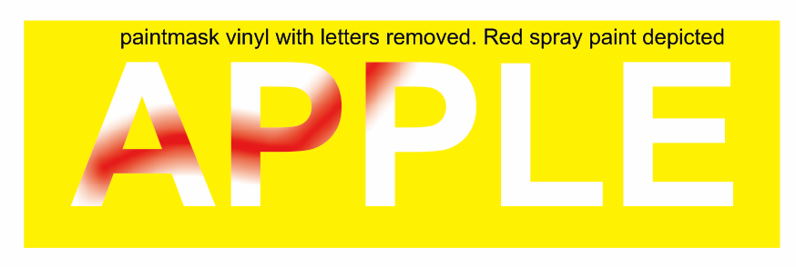

Yes, I understand this but if you're using a vinyl decal to create a 1 time use stencil then you weed as usual leaving the centers in, apply the decal, paint then remove the decal.

To answer your question, you are looking for a "stencil font" sites such as dafont have a section for them, there are tons you can use. also you can try this site and it will create a stencil from any font you have installed on your PC. https://stencilfy.glitch.me/
