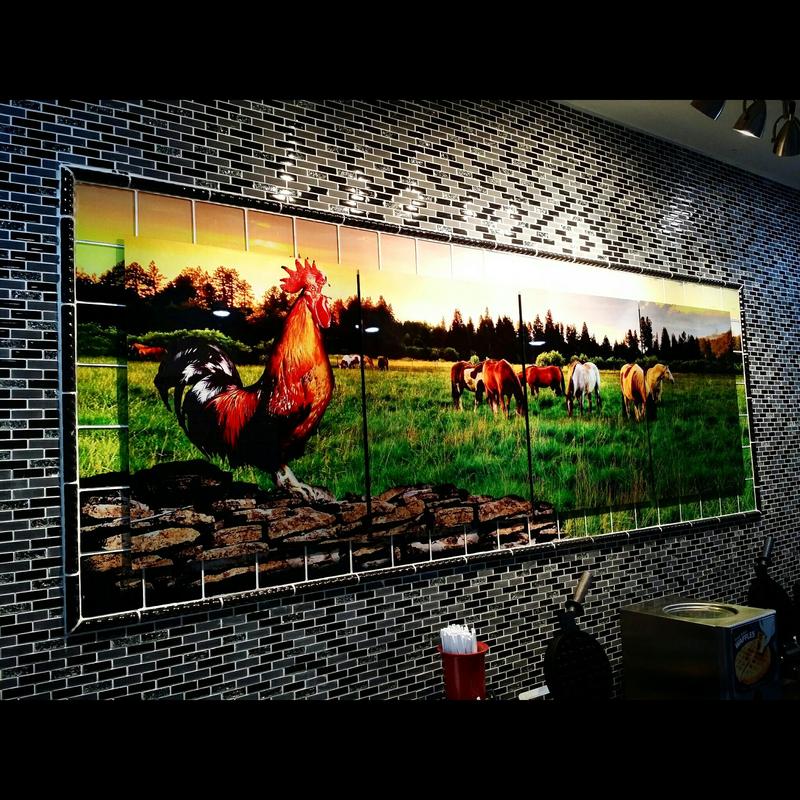

We did a mural a while back for a hotel and used a combination of both Chromaluxe and glass. It turned out great and the client loved it. It was a mural of a rooster/farm that was broken into 4 20" x 24" panels that were turned vertical and the surround consisted of the 4" x 4" glass tile that the mural transitioned onto. If I can find a picture, I'll post it up. It may give you some ideas.
Atomic DNA
I found the photo.
