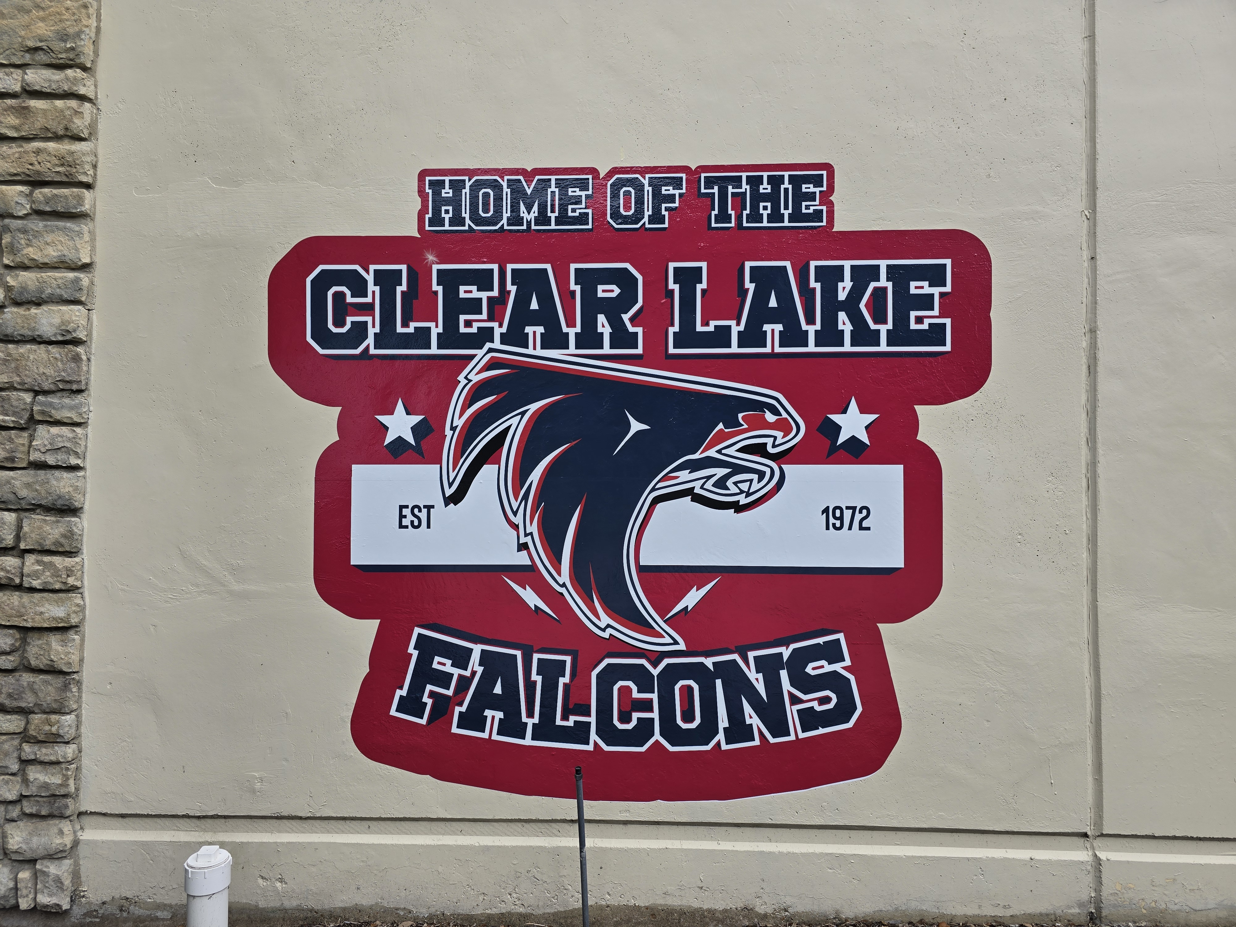

Geneva Olson
Expert Storyteller
I would have earlier, but I wasn't near my phone. Here it is.
Reactions: 1 users
