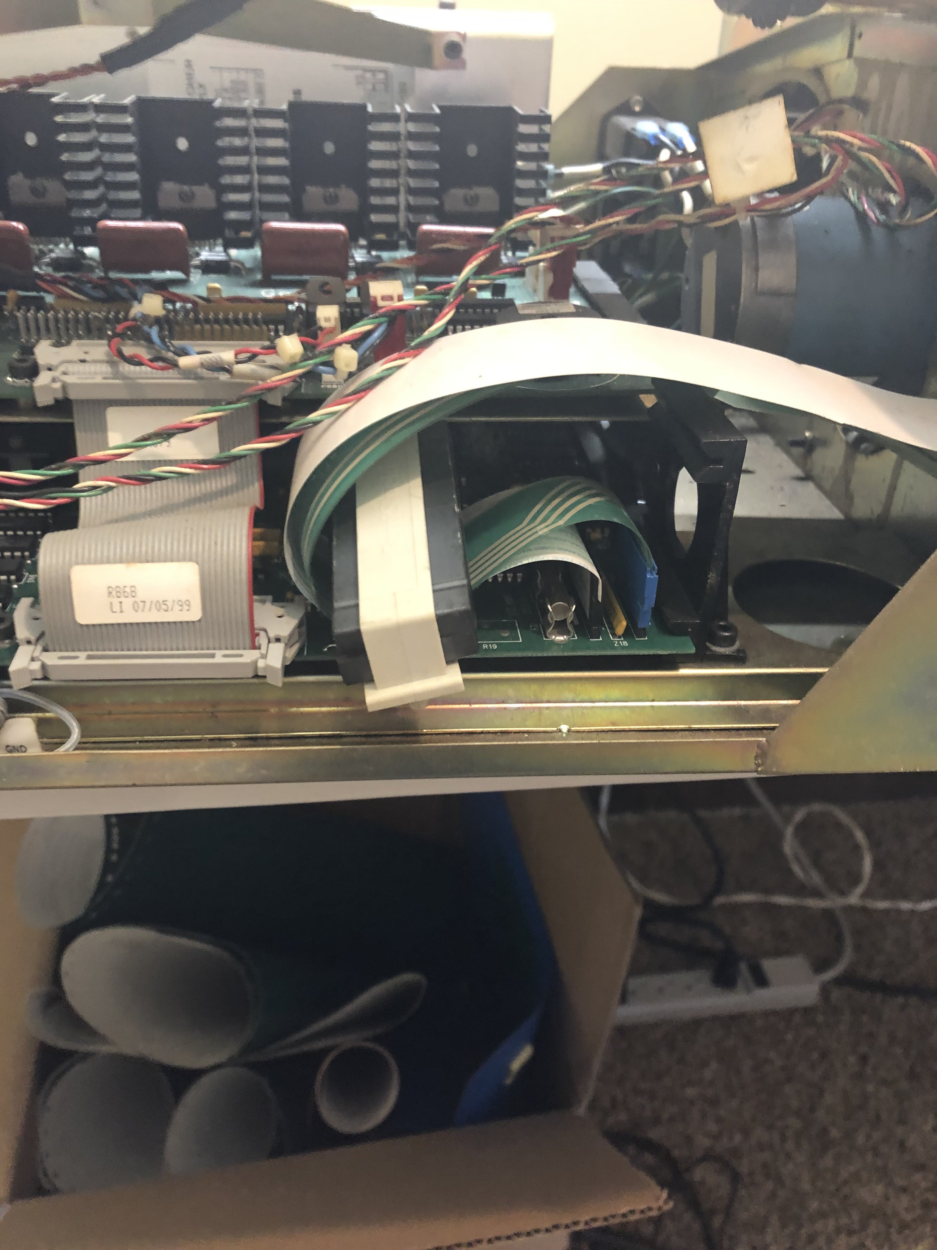

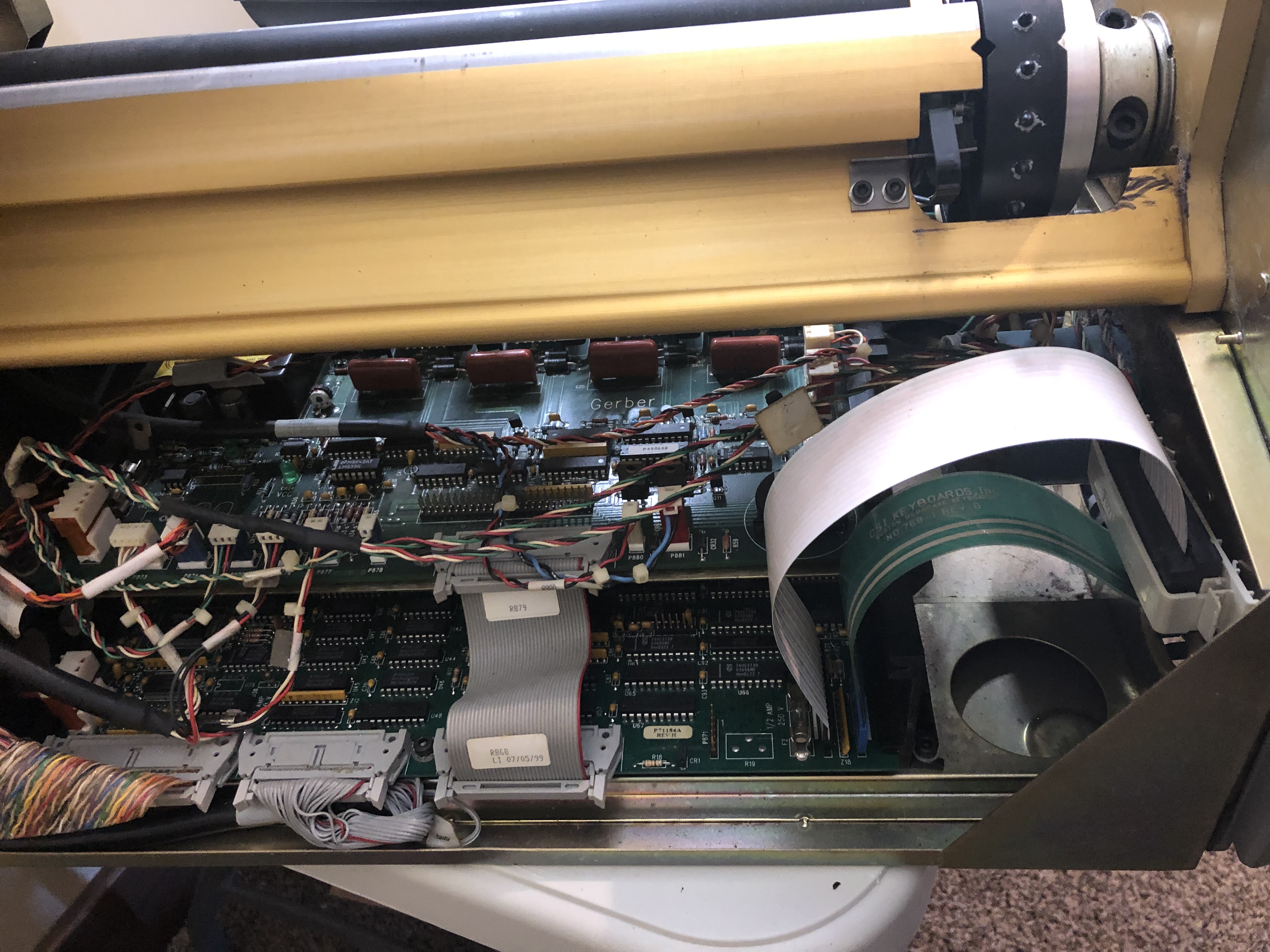

Hi, have just had a problem with my Gerber Edge 2. It usually takes about 5, 6, 7 seconds to boot up after I flip the power switch. But just last night I flipped the switch and nothing happened for about 5 minutes so I kept trying it. Nothing. This morning I tried it again and after about 10 minutes of just sitting there with the flip switched it turned on. After I turned it off it wouldn’t turn back on so took it apart. The first picture is what I found and the second is what I did to it to fix it. I have a light hooked up in the same outlet as my printer and when I flipped the power switch on the printer the light flickered and we tested the printer for electricity and there is a current running through it. But it still will not power up. Anybody have any suggestions?

You're probably going to need a new power supply, but have you tried plugging it into another outlet on a different circuit yet? If it does the same thing on another circuit, give Gerber Support a call at 800-828-5406. They're good about helping trouble shoot things over the phone.
Also, if you're looking at that bundle of wires that fell down, I wouldn't worry about that. Just get some double sided foam tape and put it back up.

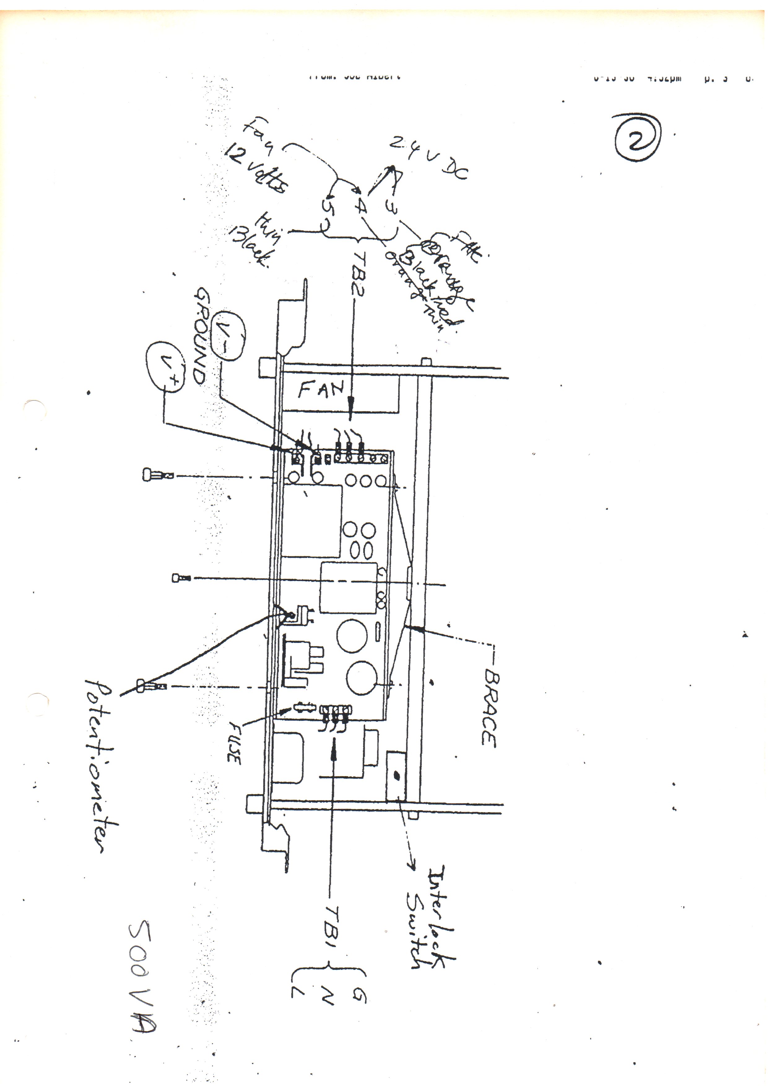

Titch Sanders
All I can find at present.. you'll need to determine the make of the PSU too I think.
Hope this helps a little little bit....
